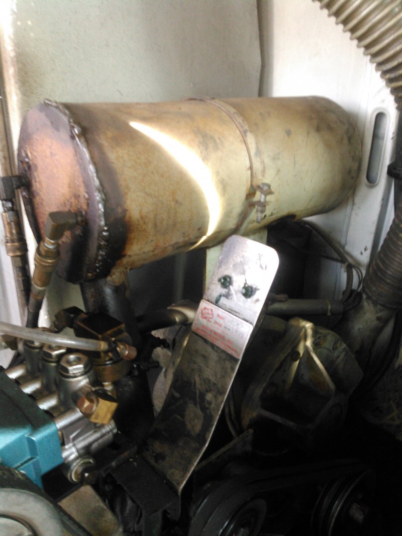

I found an air leak in my heat exchanger. It's the large round one on top that uses the coolant. I'm assuming it isn't a major issue but needs to be fixed.
It's a 2002 WM 1200.
Anyone know a fix for this?

Everything is fine as far as I know except I have a small hole that is blowing air. That exchanger hooks to another that looks like a small muffler that blows out the blower exhaust through the floors

I'm friends with a guy who owns a muffler and break shop. He could probably weld it if it won't hurt anything.
I think the air is just blower exhaust. I just don't want to have to replace it.

I tried taking a pic without removing the cover but it wasn't happening. I cleaned my concrete patio and garage floor with my spinner and cleaned some brick and limestone around my fireplace with my new tile tool in between the rain today.
My friend at the muffler shop said he doesn't have luck welding things like that so maybe JB weld is in the future.

I alwez cut the ends off....
Applied air pressure...found the leak...
Then silver soldered the pinhole....

At the connector at the weld above it and a pinhole in the center of it towards the bottom.

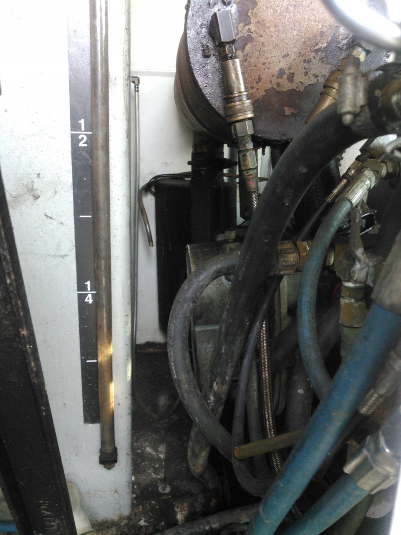

I have to take a second look but I thought that muffler in the back was a HX also but now I don't think so.
