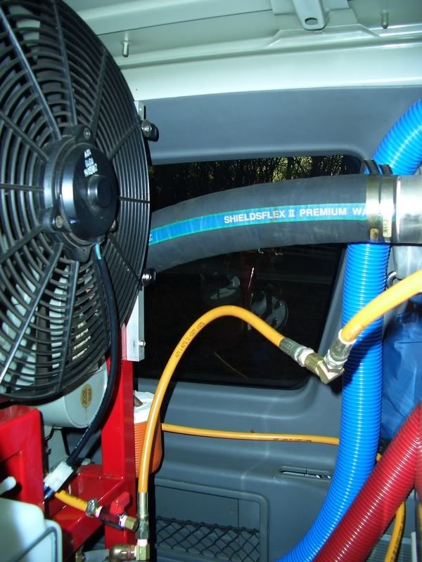

I picked up a fan from a small car. It's 12 volt, and I have it blowin' across the back of the Genesis, out the back door.

"all TMs need more air than they are getting when cramed in a van, Auxillary fan man"
Exactly, mounting a high performance 12 v radiator fan behind the TM does wonders. Every slide-in should have one in my opinion.
