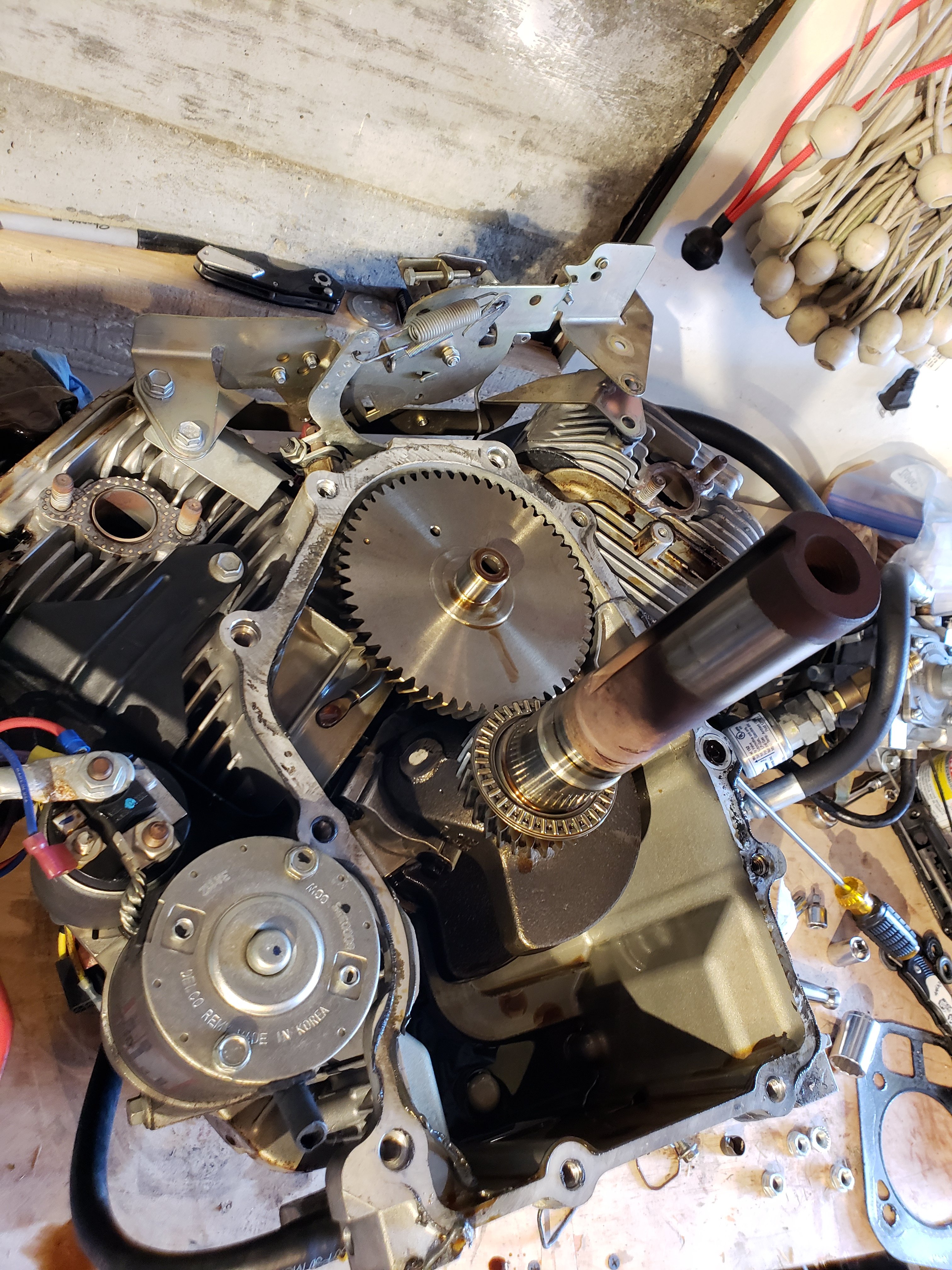

sounds exactly like what was happening to me when hydraulic lifter was sticking.
would lose power and rpm, eventually stall... happening very rarely at first then more often, could never recreate the problem.
seemed like fuel starvation kind of.
replaced all the lifters, push rods and did head gasket, crank case seal while I was at it. Runs like a brand new motor now

@Shane T forgot to mention we did also the breather gasket as it had failed and I remember my guy saying that is very common on these command pros
