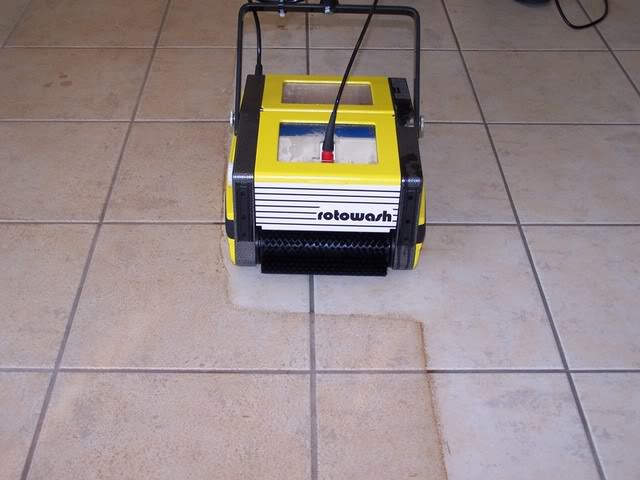

We did that years ago over here, than most went mechanical. Rotary's and OP's are ok for scrubbing tile and grout, but the grout brush worked better most of the time, so I will agree with everyone there.
Over here in Australia, a lot of guys are using a twin cylindrical scrubbers such as a GLS or something like that. We use Rotowash over here quite extensively, but most change out the standard scrub brushes that come with the machines, and replace them with a tile/hard surface brush.
This gets into grout lines better than anything in our opinion!

I'd put a nylon brush on an electric weed eater before I'd scrub 25000LF of grout lines with a brush on a stick.
