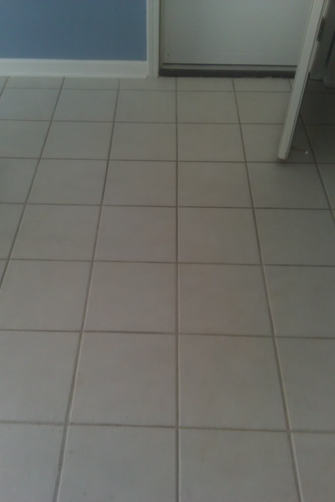

Here is the before. Do you notice any shiny spots on the floor? I just see dirty grout.

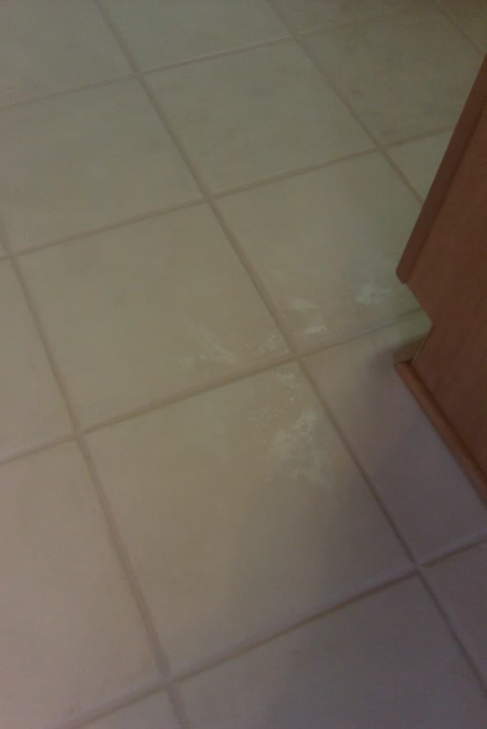

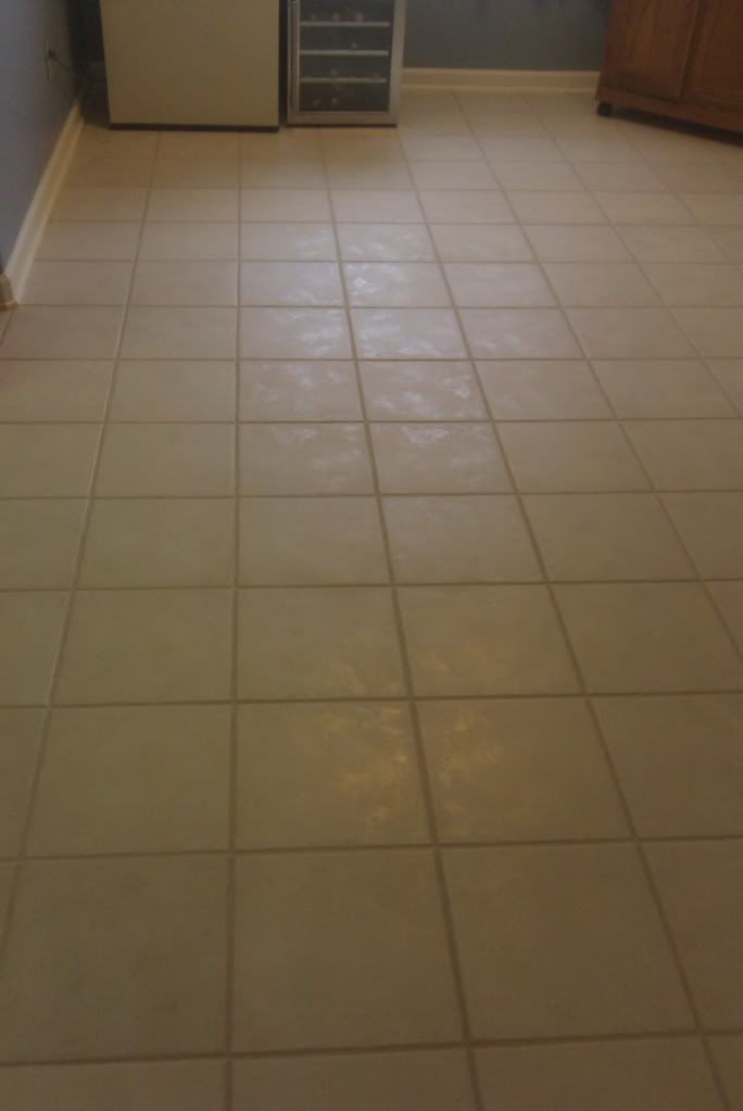

Here is an after shot. Notice the shiny spots all over the place.
Another after

I've run into a couple that looked like that. Each time, it was leftover finish that someone shouldn't have put on. It can be a nightmare getting the shiny spots off. Finding the right stripper is key.

There appeared to be a wax on the tile that has worn off over time. The customer said it was like this before we came out. I really don't see anything else we can do but apply some finish to the tile. I told her that may be the only solution and down the road she would need to have it stripped and the color seal re-done. I need some advice on this!

Geez Daniel, what a bunch excellent advice from some of these tools on the board. Anyways, check out photo number 2. From the angle you have, it shows roughly two squares by five squares of actual shiny tile (top ten). On the right column, compare the second tile with the third. The third you just have to rotate to the right 90 degrees. Also the two bottom ones are the same. My opinion, it's the tile.
Yes agreed and Doug I didn't see any problems with wax residue or shinny spots. The customer said it was there before I cleaned the floor but I didn't notice it maybe cuz the floor was dirty. I inspected everything real good, measured, and checked the grout for wax or sealers and there was no wax in the grout. I guess it's a problem or defect in the tile.
Anyways should I just tell her that's the way it's going to be or would you put finish on it?
I told her I did not recommend applying finish to a floor that has been color sealed.

This type of tile has both matte and shiny portions to it.
Your real issues lie in the fact that there is color seal residue left in the lower parts of the tiles. Go in there with a box of Magic Erasers (the extra power ones) and you will solve your problem.

your first picture is taken in a shadow so you cant see anything. your other pictures are taken with the light reflecting so you can actually see the issue.
1) why do you keep suggesting to your customers that you will put a topical finish on there ceramic tile? That is lazy shit work that will only cause more problems down the road.
2) if you allready think it has a topical finish on it. Why would you suggest putting a different one over it with out removing the other finish first.
3) Dont you have any stripper on your truck to test and see if it is actually a textured worn out ceramic tile or if you can actually strip off the finish that you think may be there?

I was thinking along the same line as Mike and Dan Brown as a possability. I would take, along with the Magic Eraser, a can of acetone, glove up pour some on a rag and try and clean it.
I run into this all the time at commercial accts where they have a lot of vct and a a maint staff. They buy a cheaper dull tile then someone in power decides they want it to shine so they put vct on it, for homeowners it's mop and glow. But I've always been able to see it or
catch it by testing, both of which you did. So that's why i would go with the above first.

Ive cleaned this type of tile before the shine is meant to be there. did you try removing one of the shine spots? Did you guy back and inspect the troubled areas. they look uniform to me. If its not uniform its mop'n'blow and you will be re-colorsealing those areas after you try to remove that crap. Try some goo gone professional on a rag without touching the colorsealed grout you may still be able to be a hero.

The random "shiney areas" are just characteristics of this tile from the factory. You can't change them. If you had tested ONE tile you would have confirmed this.

I think Danbrowns looking at the last photo were it appears to have color seal on the tile, the large middle pic with lots of shiny spots he sugeesting its 2 different thinks
a pattern thats there already and some tiles near the wall with a little excess color seal.
If its not the case its a optical illusion from a bad camera photo.
either way if she's happy God Bless You!
either way theres probobly now way to take out the shiny spots its part of the tile if it were excess colorseal then you cold use a magic pen or whatever.

It could be that they are seeings some grout on tiles left over from the install.
I don't know how you could think that is floor finish on the tile. If that was the case, it would be worn down in traffic paterens.

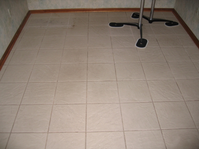

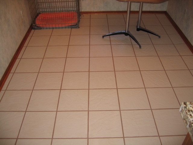

Here is an example where we had used Jamocha on a light colored floor. The only thing that would remove the residue leftover was a one jet tool at 1kpsi. The cimex and scrubbing had no effect on it. This tile just liked to hold on to the haze.
This haze was from a dark color sealer. Now imagine what it would look like if the color sealer was a close match to the tile color like yours....
After spending hours with the raptor tool we were wrapping up and I was still unsatisfied. It just so happened that I had a magic eraser in my kit and decided to try that instead of breaking everything out again. It worked fast and completely, and erasers have been a stocked part of my arsenal ever since. I took these photos over 5 years ago.
