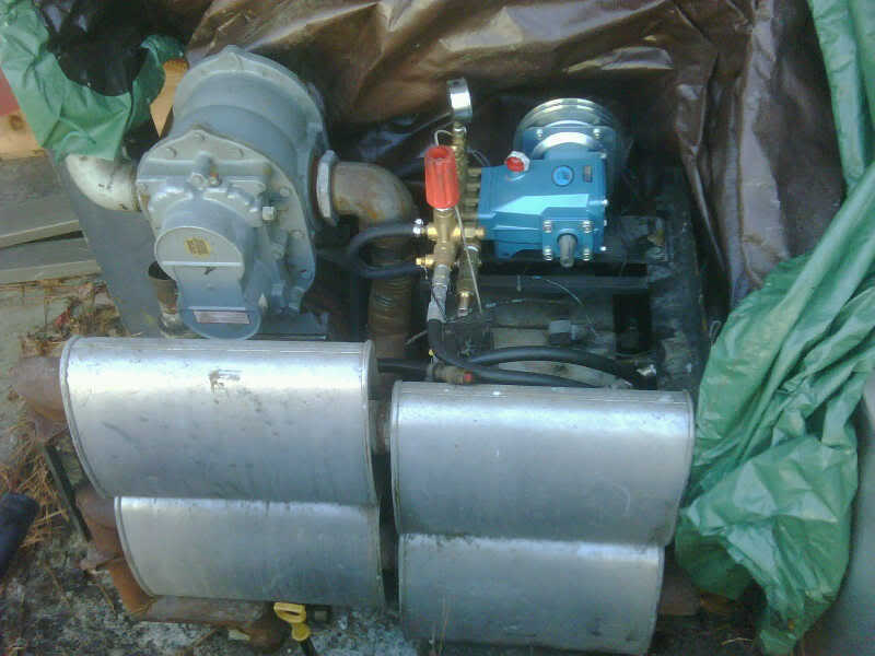

Not sure how yours is set up....mine was a mid-90s but flushing the blower might be difficult with the mufflers/silencers (pic below)......unhooking would be a major pita.....and likely not needed anyway
