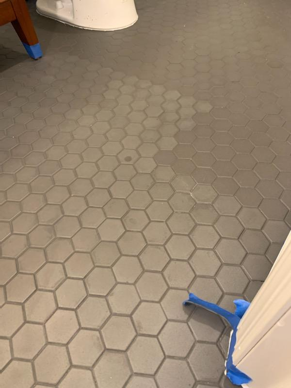

So this is what it looks like when people try to repair it with coatings This appears to be an older floor at that?

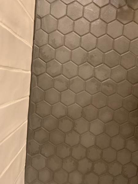

This the water staining or whatever you want to call it is showing up on all types of porcelain, it's just far more visible on the matte finish variety that has the very realistic photograph of either wood or stone.

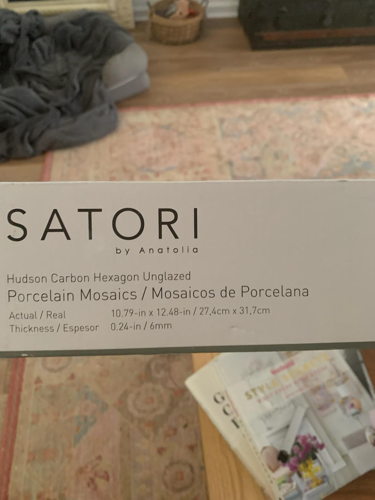

You seem to be hung up on the epoxy grout haze remover and in this case none was used, I posted a picture sent to me by the homeowner of what she used

Which is exactly what she is doing, but now the tile is so absorbent that plain water is staining it..

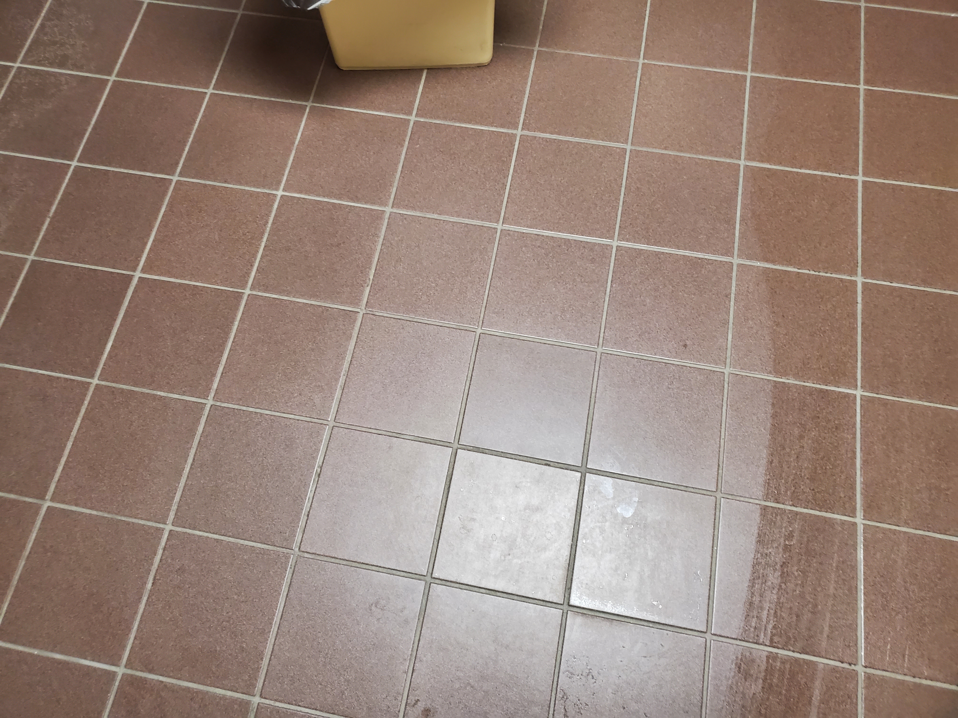

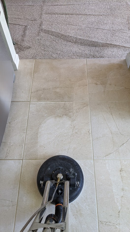

Looks like color seal left on the edges.
Told this story before. Had a customer 15 years ago that sued the builder and tile manufacture, because there brand new porcelain tile in the kitchen, (new home) matt finish, was impossible for them to clean. Just like Mikey pic, turboed easy. Rest of the home had the exact same tile in a polished finish, not glazed. There was no issue with that. They went to court and lost because it was determined the tile was non absorbant.
It's not the absorbency that's the problem, it the surface texture.

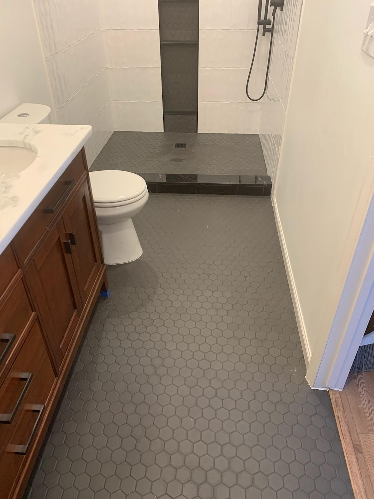

The whole floor has been colors sealed. the light area is where she used the haze remover.
At this point she has give up as water is absorbing into the tile and leave marks.
Time Yeater has been plying with some aluminum oxide finishes that can be mopped on, that dry level and look great...BUT leave the grout cloudy and or shiny.
Ripping this crap out is the answer, despite what Fred thinks.
