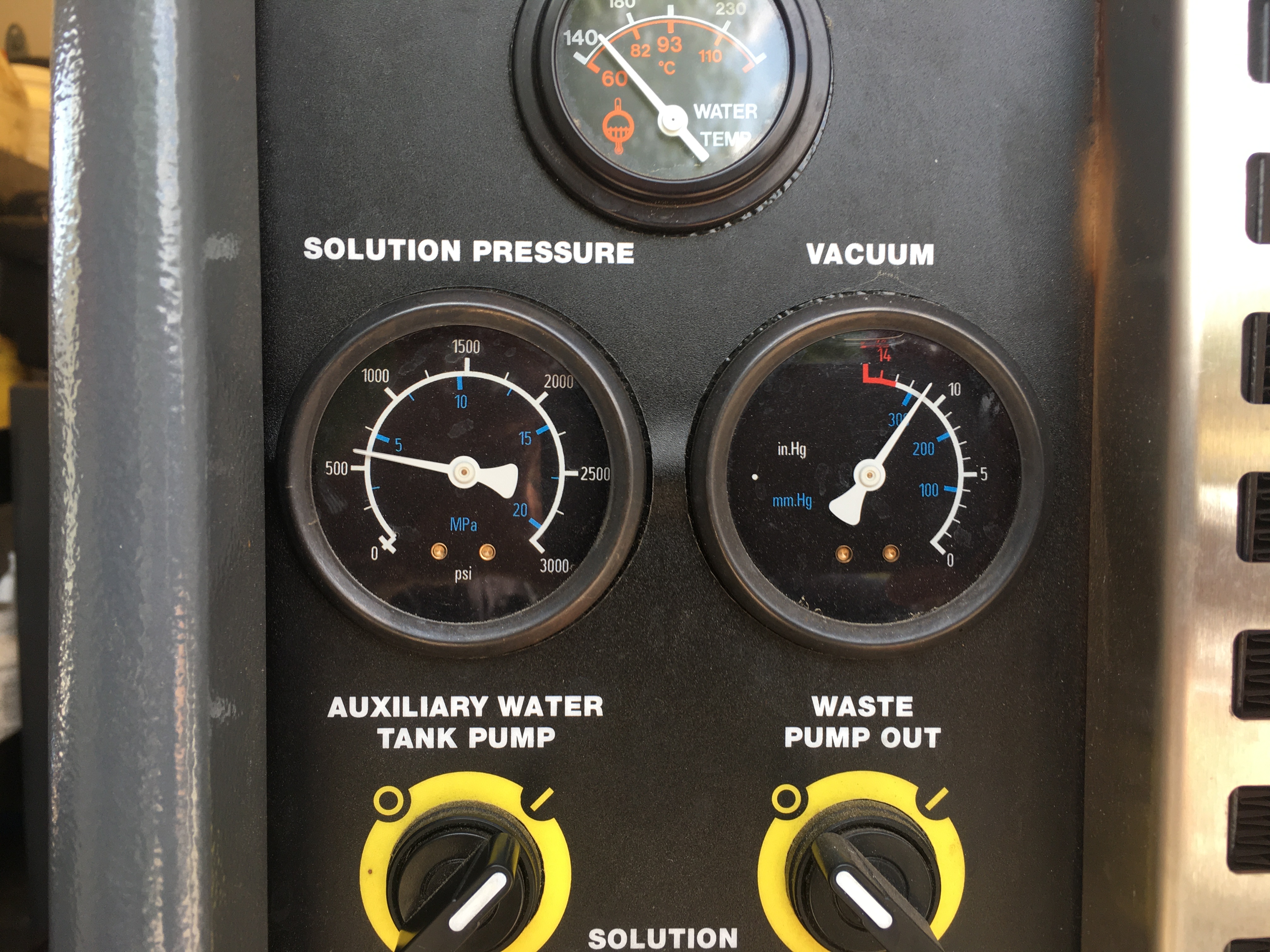

28,263
Here's my Cleanco. 47 blower, 75 feet of vac hose hooked up to a 1.5 inch wand. Aprox 7 inches with the wand open.
