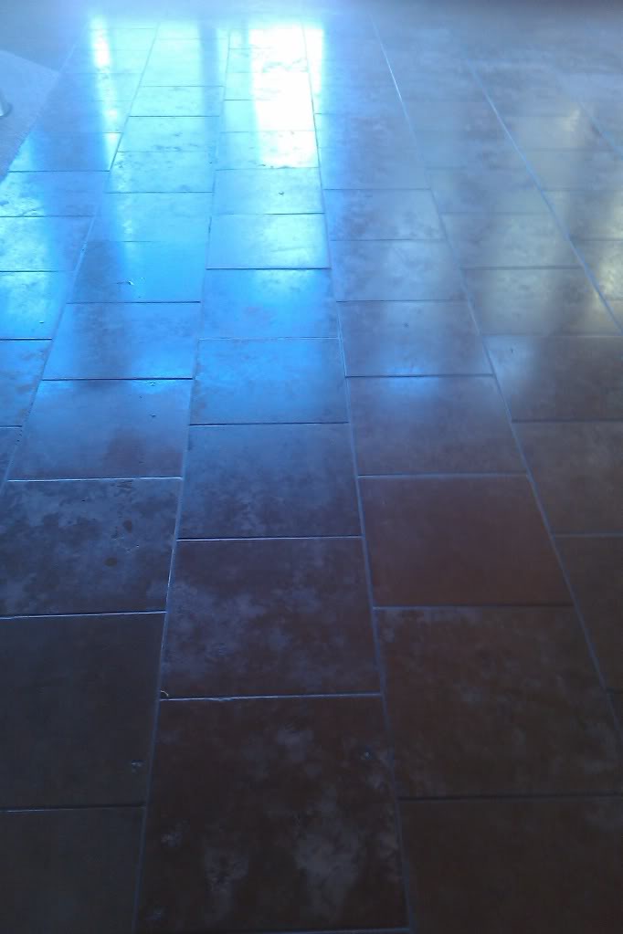

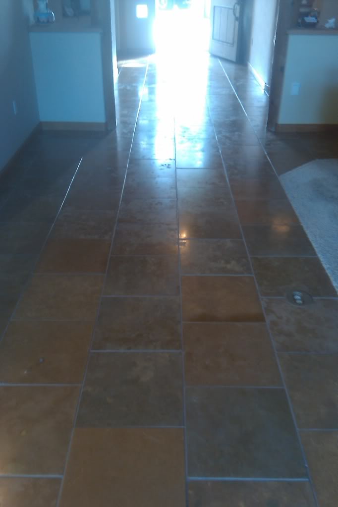

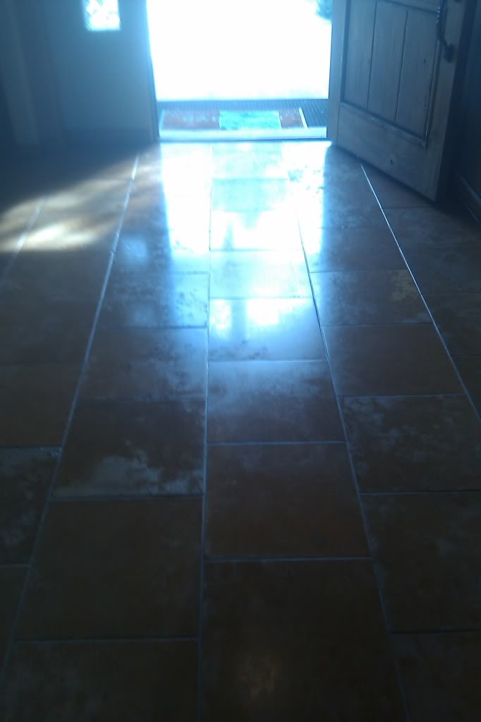

well I figured I would come out ok, the customer loved it and i collected 6987.53. I learned alot, I used powders, pastes, cheetah, monkeys and densifer.
they loved the floor and sent me home with 6 area rugs..... shiteatinggrin shiteatinggrin shiteatinggrin

looks nice Ron
especially considering the lippoldage
How long did that take?

to long. I could have had it done sooner but was trying everything to get a better pop. 35 hrs on the job thathurts thathurts

I would hit it with a 11000 grit monkey have 3 on hand with the lippage, 50 pounds of weight and 2 coats of densifer. done check in hand.. shiteatinggrin shiteatinggrin I have never had this problem with travertine. This stuff was soft... The 11ooo pad would remove scratches. I cant wait to try the cheetahs on a harder floor.

That looks like limestone Ron. Did you get to see the back of a spare tile. I'm glad the customer liked it. That stone was not made to take a polish but people get tired of the dull look and want bling.

Yes Al I actually went to the quarry where the cut the stone.. Funny thing the owner doesnt sell it any more due to the softness of the stone. I think we saved this floor from more damage...

What did the densifier do?. In concrete some people will densify then burnish, this gives a denser floor and a decent shine after it has been processed. It kinda acts like a micro coating that won't peel or flake.

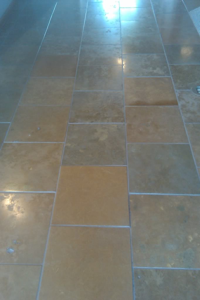

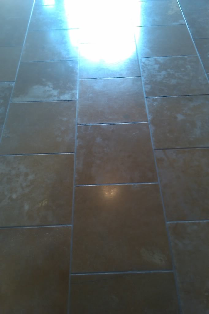

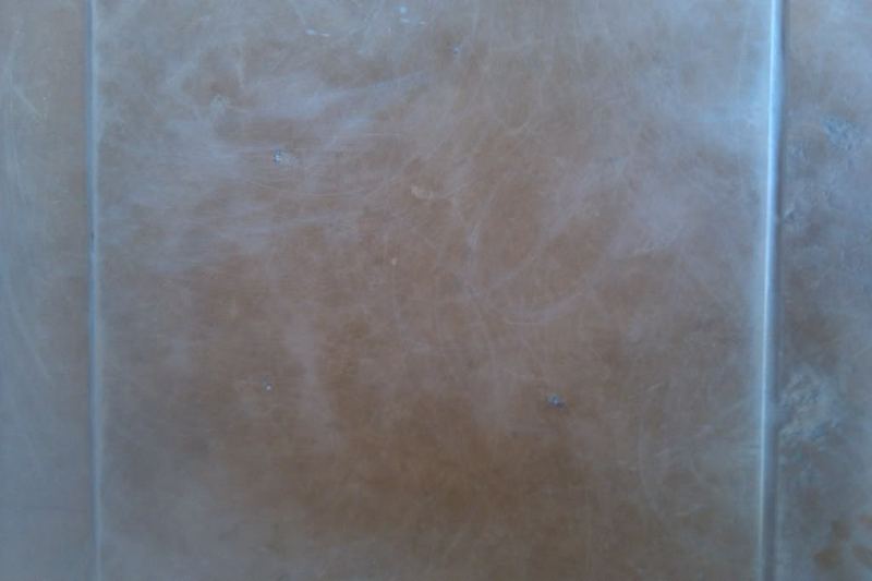

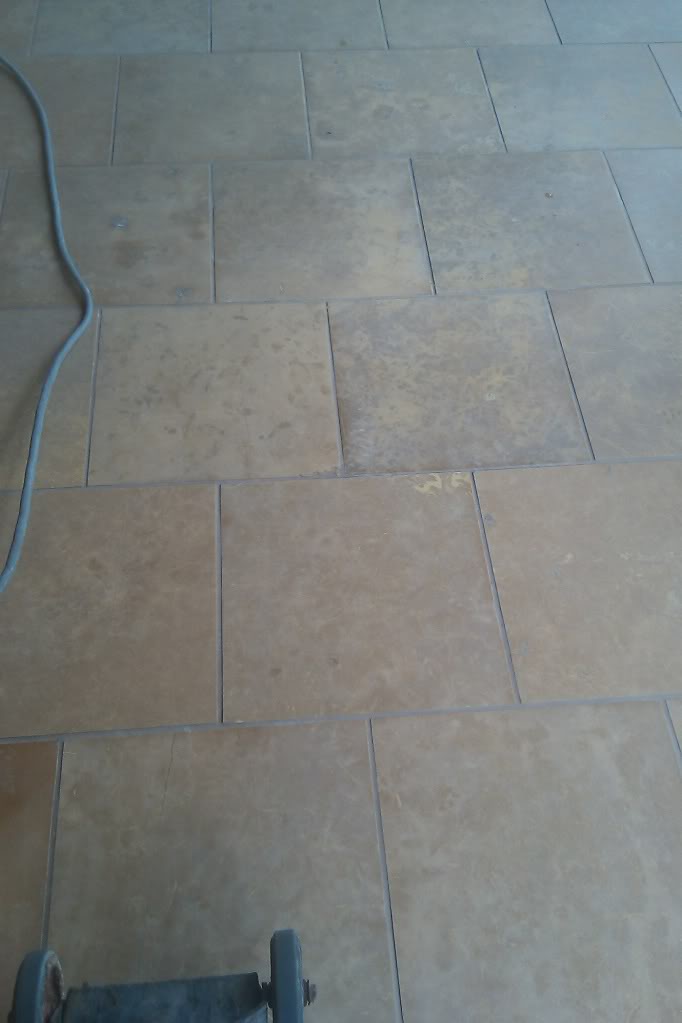

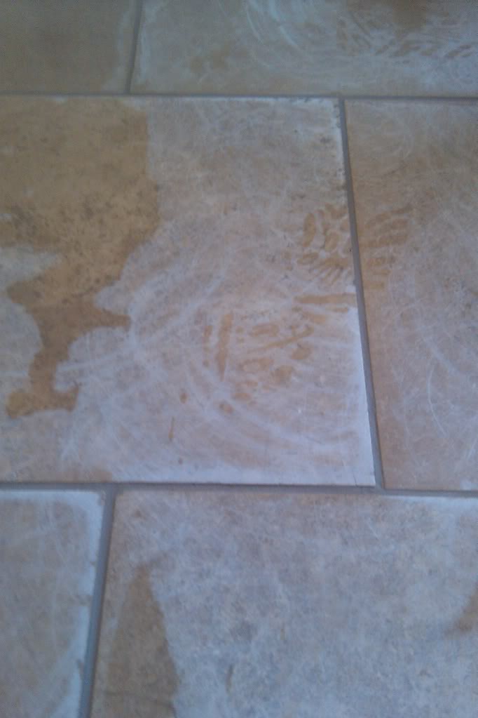

C
clean image
WOW,
Are those scratch patterns from the cheetahs?
What did the 2 coats of dentifier do?
Bellhop worked for his money those 35 hours
are those the after pics?
Maybee it the camera or lighting, , if so those after floor pictures look terrible

no there were scratches before we started. funny thing this stone was so soft that a 8000 pads even removed scratches. The densifer gave it the wet look and a differnt feel. They said if it has to be done once a year they dont care. It gave them more than they expected.

not a coating Albert.... but rather it bonds to it at a micro level....feels in the gaps as well as make the top layer ohhh like 1/8 hard...then the burnishing just helps to close up the gaps....
hence is why some floors they say the more wear is on them the better they shine....the more you autoscrub them or burnish....
sometimes people get mad when it doesnt "pop" like they think it should....well it aint floor finish and it changes over time, not 1 time
I am undecided if i like it or not.....that floor with the blotches in it looks crappy.....
but then again i wouldnt pay almost 7k to get it done either :shock: :shock: :shock: :shock: :shock: :shock:

doug when we got started that floor looked like shit, granted its not flat or perfect but it changed their whole house, thats why I got paid, I did not like it either but you have to draw the line in the sand and stake yor point, their happy I got paid and they love me. The floor looks a hell of alot better. cheaper than busting it up.....

The more I look at the before pics, the more like mud they look. I see why they got rid of it. This floor was a bad idea from the start. Poor owners, I hope your solution lasts them a long while.
Doug, as you say, the densifier is used usually after the metal steps specially on the softer stuff. However some also use it as a last step, a few light coats and burnish in between. It's a lot cheaper then applying a guard.
Ron, I'm curious, after you densified did you ever use any diamonds to see if the stone got more dense?

Al it did make it harder, but the powders and the paste would cut the stone enough to remove the densifer. My last step was to hit it with the monkeys and 50 lbs of weight very litttle water, then two coats of densifer. I was there today to bring her some cleaner and micro fiber flat mops to take care of the floor. They love it.. Cleaning all the carpet on monday... shiteatinggrin shiteatinggrin shiteatinggrin shiteatinggrin
