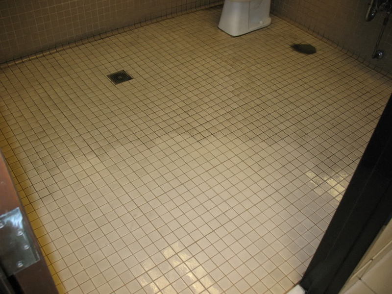

You need to demo side by side, scrubbing then turbo and no scrubbing then turbo. Same chemical mix and ratio. Don't use it too strong or you will have to use that way for the entire job. I just did 4K sq ft car dealer on Friday. It was some of the worst that I have done. I did not demo. I still priced it right, but it was more work than I thought. Wouldn't hurt to do a spot in a bathroom too to see it cleans the same. Normally the bathrooms take 2-3x longer with having to clean edges and walls.
I have done a lot of commercial tile. Use that demo process so you can estimate a time for the job to price it right.

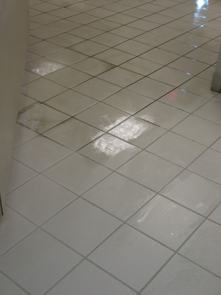

Finished in about 4.5 hours and was not to difficult but was not completely 100% happy with the results. Don't get me wrong the customer loved the end result and is going to get me in to their other buildings but i was not happy citing that i had a different idea of how it was going to turn out. I will post pics as soon as i learn how.

With this job the grout didnt match when dry. But after a close review of the floor i noticed that some kind of repairs had been made to the floor at various times and those repairs were not to professional. There was grout on top of the tiles, there was grout that was even with the tile, and several places that the grout was darker not dirtier but darker than others. Is this were color seal comes into play?

Sounds like an ideal situation for color seal. Nothing on top and grout that isn't uniform in color.
If the customer is willing to pay for it, it will be worth doing.

dealtimeman said:
...there was grout that was even with the tile...
Be careful selling a color seal job when this condition exists, especially in high traffic areas. The color seal WILL wear off the grout. If there are a lot of high grout lines, pass on the color seal or be very sure to set the appropriate expectations with the client. You can also remove some of the grout from the high lines.
TimP
May 19, 2007
4,055
That is true. Flush grout is not wise to color seal. Tough to get the sealer to stay for sure.
