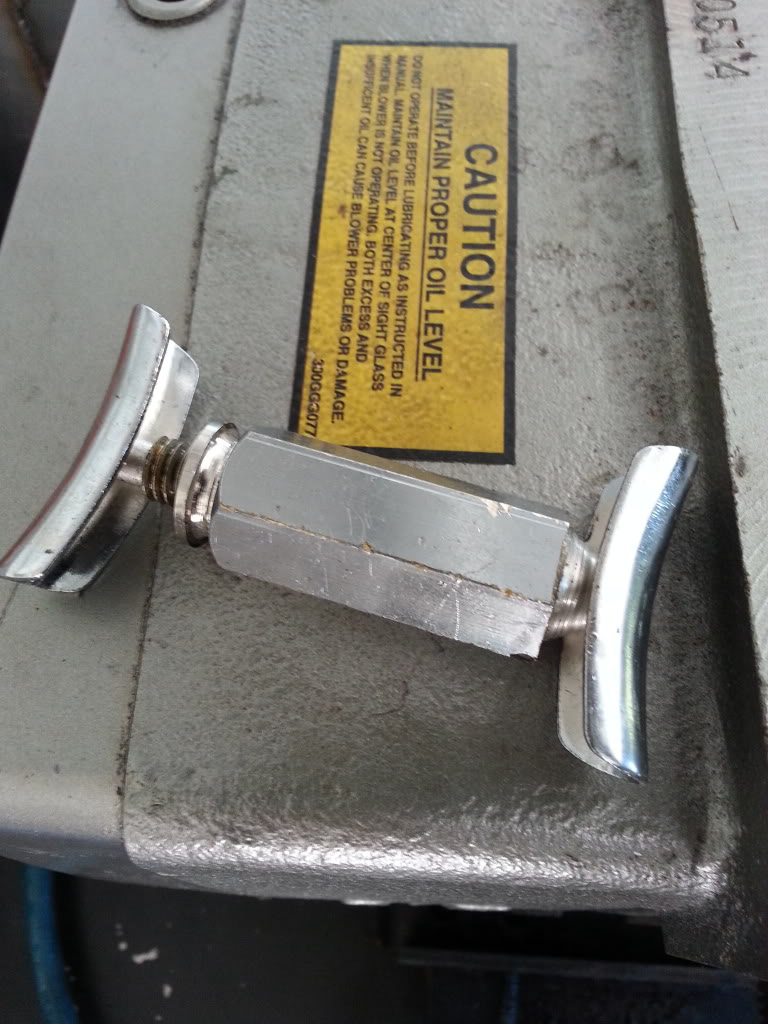

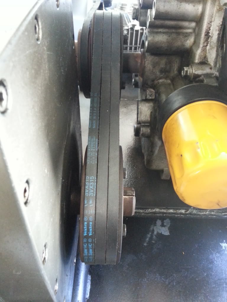

I'm pretty sure this is my third set in 780 hours..
I'm snugging them up to what "feels" right and snugging them up again after a few days of replacement, even using this tool to do the centering/tightening..
Looks good and straight..
