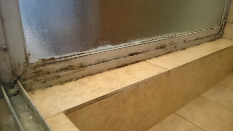

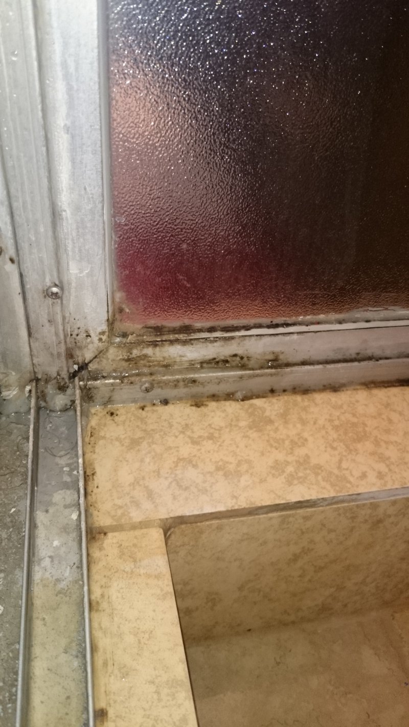

The shower tile and grout is not the issue...it's the lame old aluminium and glass with all the extra silicone spread all over it.
Is it a complete scrape out job and followed by a thorough caulking?
116,049
Most of that is growing under the silicone.
Peel, scrape or use some of that silicone de-solver(that I've never tried) to get underneath and hit it with an acid and the metal toof brush.

No...problem is that bead of silicone along the bottom frame is whats' holding the glass and water) in.
DONT mess that up.
A Shower Door company would replace that for less than I would charge to mess with it. Its a low end door. Best way to do this job is to have a glass company remove that one, you or they clean all the funk underneath than replace with new or the old one if it cleaned up well enough
Second best is razor off as much silicone as possible, scrub the hell out of it with the HD brush and SS wool and re-apply a minimal amount of silicone. With zero guarantee on mold return. Mold is growing under the metal and it's going to come right back.

Between the glass and aluminum is a pre molded strip from factory. You have to pull that out and soak in bleach/ cleaner and reinstall
we dont mess with crap any more....
An aggressive abrasive cleaner with acid base will remove the rest
I would tell her invest in a frameless door....
If that was all you were doing, 1 hour ..

This is not a maids job. This needs to get done by a professional. If you don't want to do it, then don't, but if you "don't want to spend more than a couple of hours" move on and let them hire someone that will take it seriously. It's not a high paying job, but it needs to be done right.
Prosoco makes Dicone 9, a silicone digestant. I would probably just scrape it all off the stone, then pick it off the aluminum, or use a plastic putty knife. MB-9 is a stone safe mold and mildew remover that works really well. Clean up, scrub it down with solvent and let it dry, then re-silicone. Even use a colored silicone to match the stone and make it look good.
It's tedious, but will look very nice when done right.
