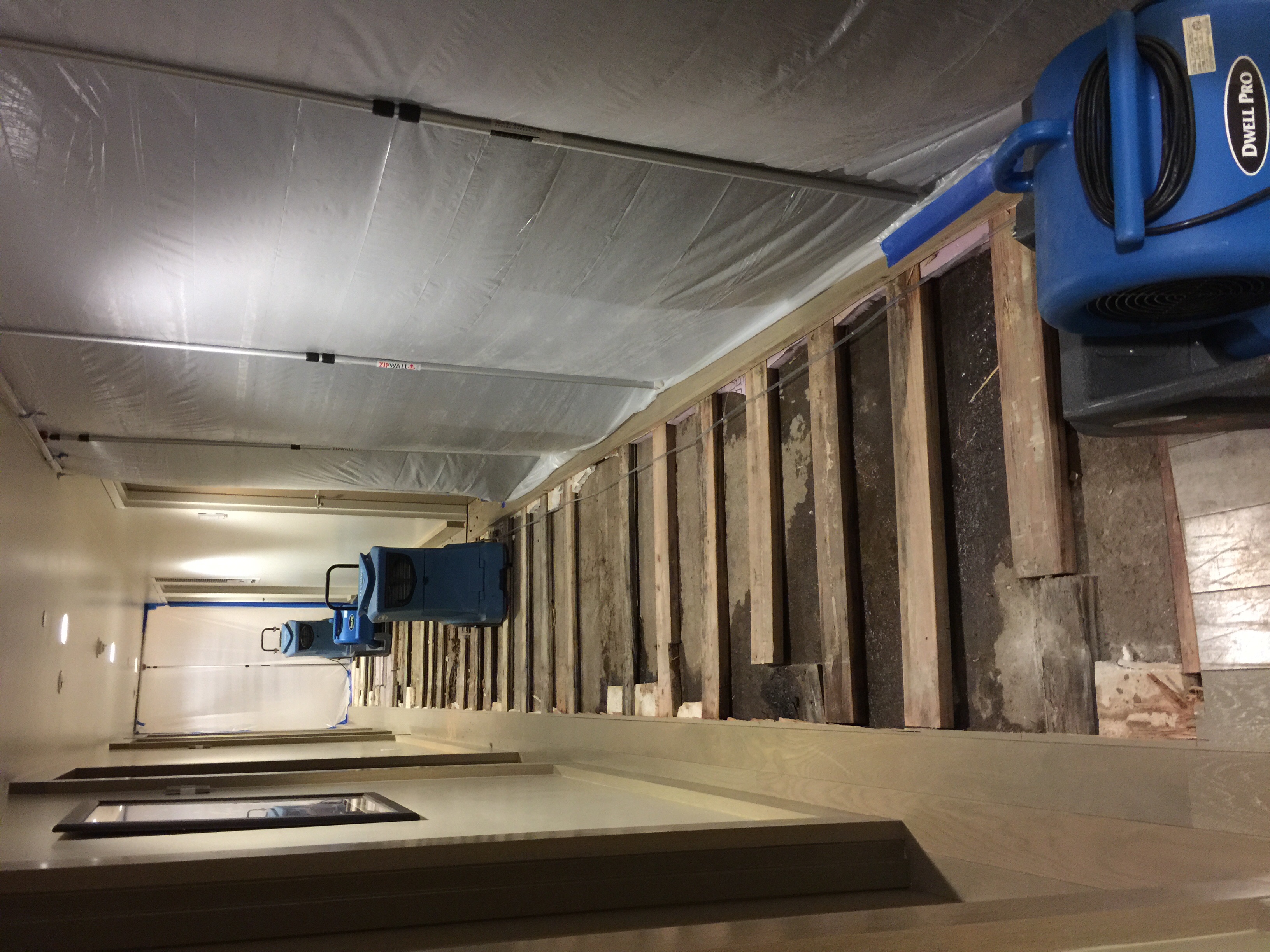

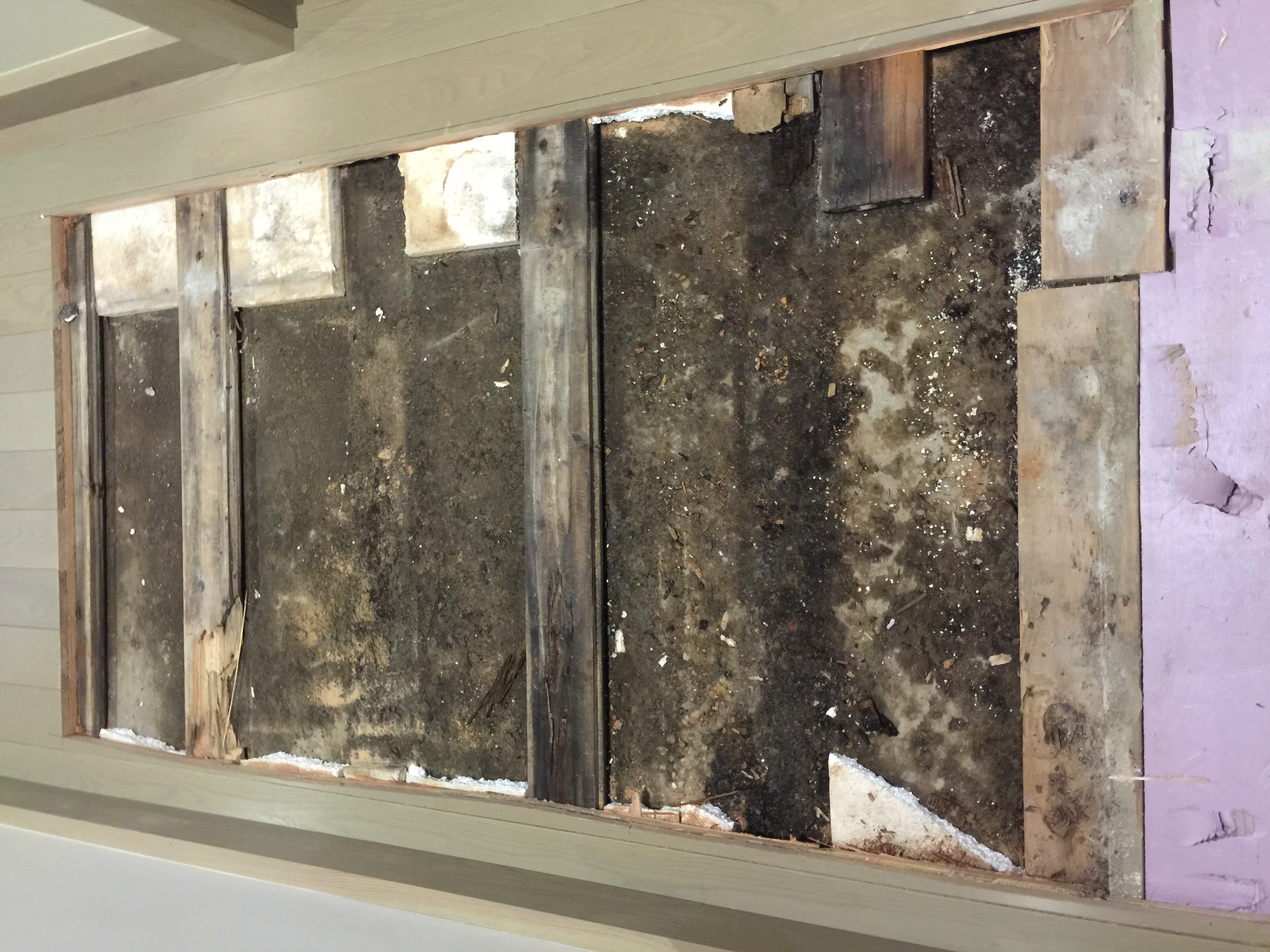

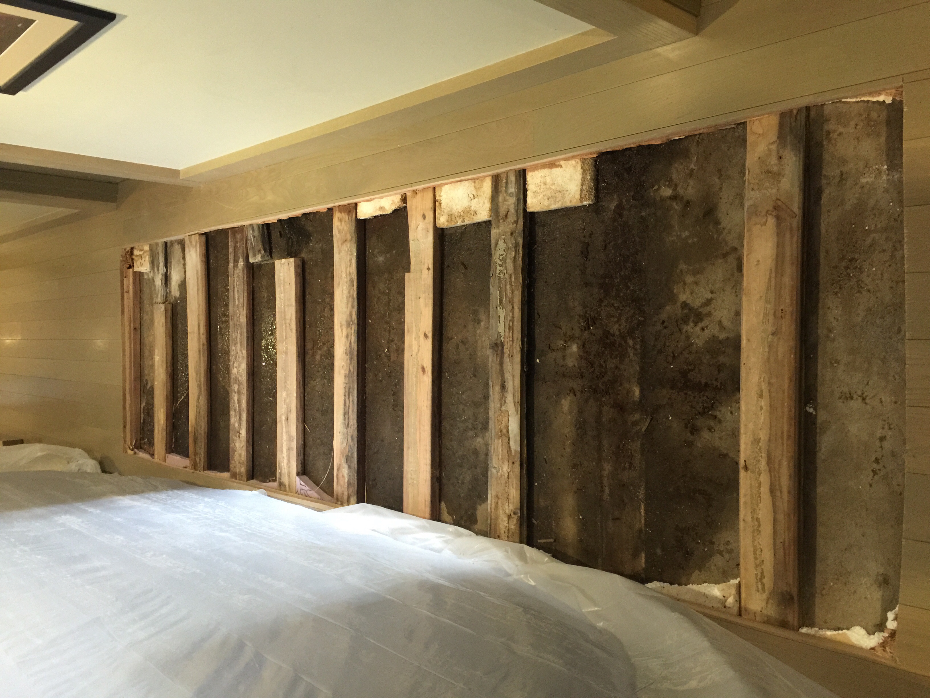

Half-inch hardwood, 3/4 treated plywood, two by tens spaced with foam board on a slab above the parking garage. Apartments above.
Water in area without rotted wood. No smell after opening. How old is this flood?

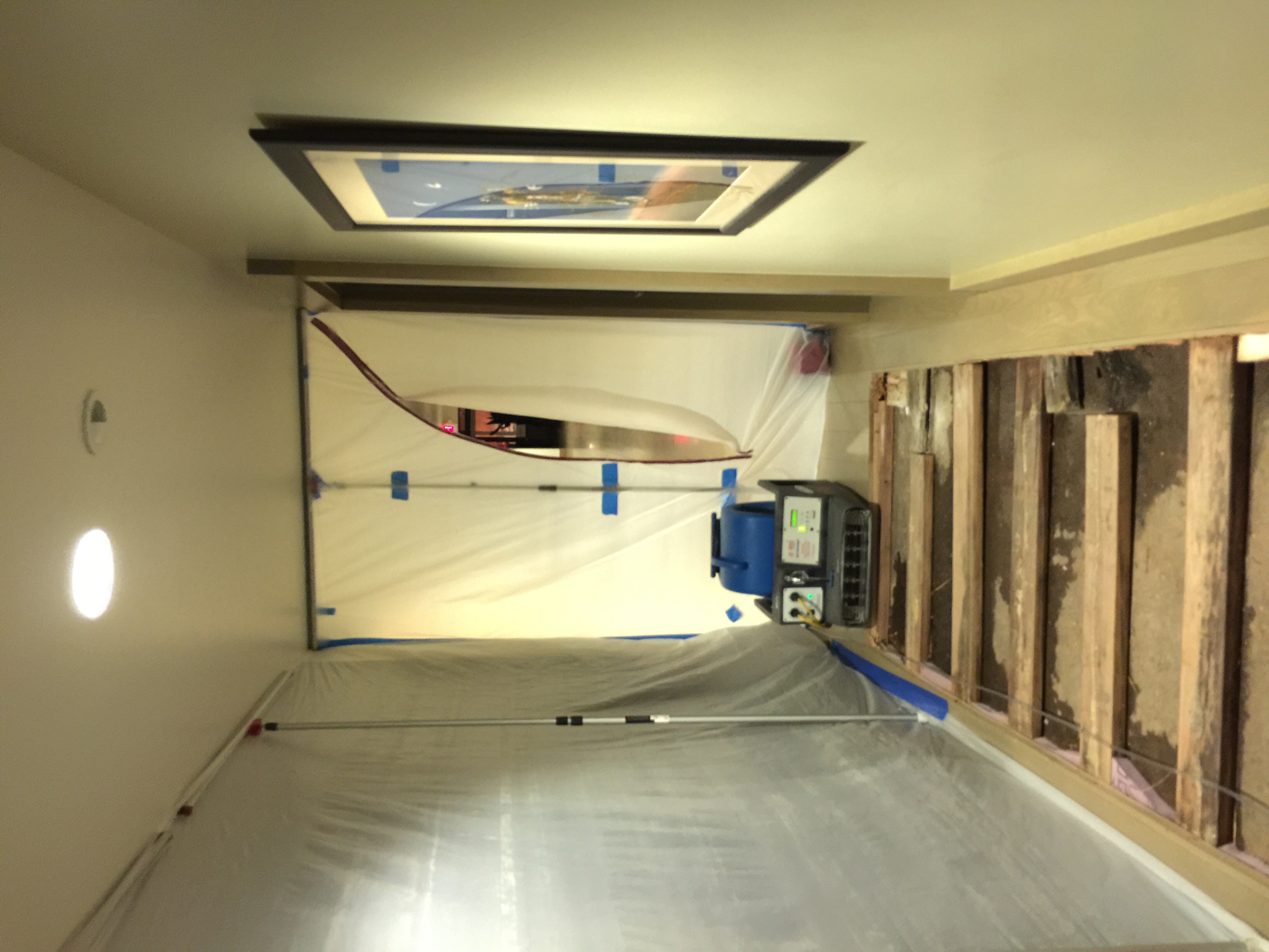

i too am confused. Mold jobs should NOT have fans on it! Where is the air scrubber?
you say no rotted wood but we clearly see rotted wood.
what are you asking?

Consulting firm came in and charged $1000 for an overnight mold test. No mold found…
That is why there are fans and LGR's on the job.
If the floor was not cut out, how would you test for moisture? Knowing the sickness of the floor and subfloor what is your answer?
On a sidenote: With all the variables that go into flood restoration I'm a little shocked at all of the assumption made on this board simply by looking at a pictures...

If you knew there was a problem with floor you could use a probe meter. If the depth is beyond normal pins you could use welding rods. I'd pull base in an area so as not to damage the floor.
So did moisture defuse though the concrete to condensate in the flooring and cause the damage? Or was there a water incident there?
No microbial activity would tell me its very old.

Very good! The rotted wood is 40 years old. The contractor who put in the new floor failed to remove it. I think he might be in trouble… Of course you're the moderator, you'll always be nice. Humanity never shocks me, especially in the world of surface cleaning

Was there no vapor barrier covering the concrete originally?
They had a water issue so they poured a 2 inch slab on top of the exterior grade and angled it. The water flows underneath the 2 inch barrier and into the dwelling. No membrane or anything.
