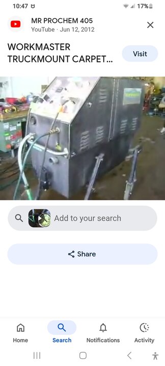

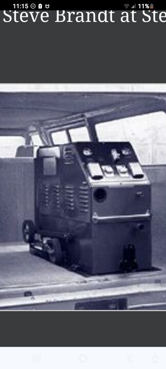

I personally would make up my mind what i really want/need before buying any thing. Do you want a truckmount or a portable? If you choose truckmount , buy a truckmount if you want electric buy a portable i personally haven't seen a decent electric truckmount since workmaster came out with one in the 80s back then it used a 3 stage electric vac for cfm and a tiny sutorbilt 2.0 blower for lift a cat 290 pump 800 psi a little giant heater for heat all built on a 20 gallon waste tank. And had retractable legs so could be used as a portable or left in the van but these things that need part of the van to run part of the machine and is permanently mounted makes no sense to me i thimk youll be buying a soon to be obsolete machine with no available parts buyer beware but thats just my opinion ask me again in 5 years what i think after they've been around longer than the payment plan if you finance one

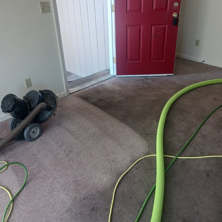

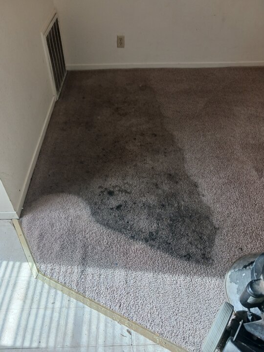

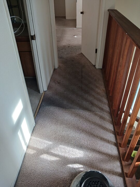

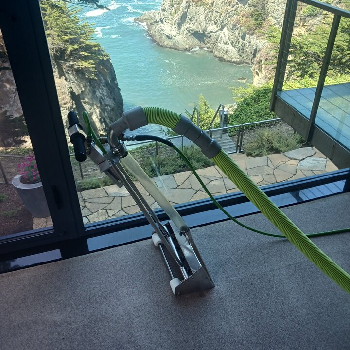

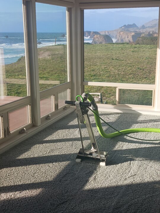

Unfortunately where i live if i only did the "good" jobs id be outa business in a month. In a large metropolitan area you might have the luxury of being able to pick n chose which carpets you do but us country bumkins don't have that luxury. We have to show and play the cards delt. The good,the bad, and yes even the ugly.
20230726_121705.jpg 20230203_154147.jpg 20230907_140210.jpg 20221110_125239.jpg 20221110_122342.jpg

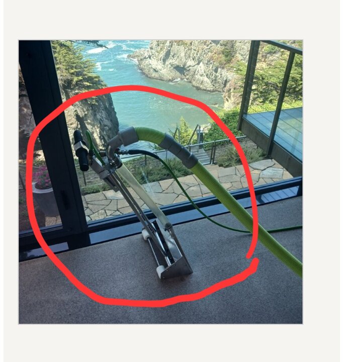

Dwain, what is this thing?
My secret weapon! Is wha sets me apart from others. It is an antique by manys standards. But really it is a steamgeni 16" 4 jet weighted drag wand. I.prespray then clean every carpet with a rotary extractor using emulsifier. When finished i switch to a rinse and completely rinse n dry using this. Rotary gets carpet completely clean and relatively dry. Following up with the drag wand gets the carpet residue free and very dry
