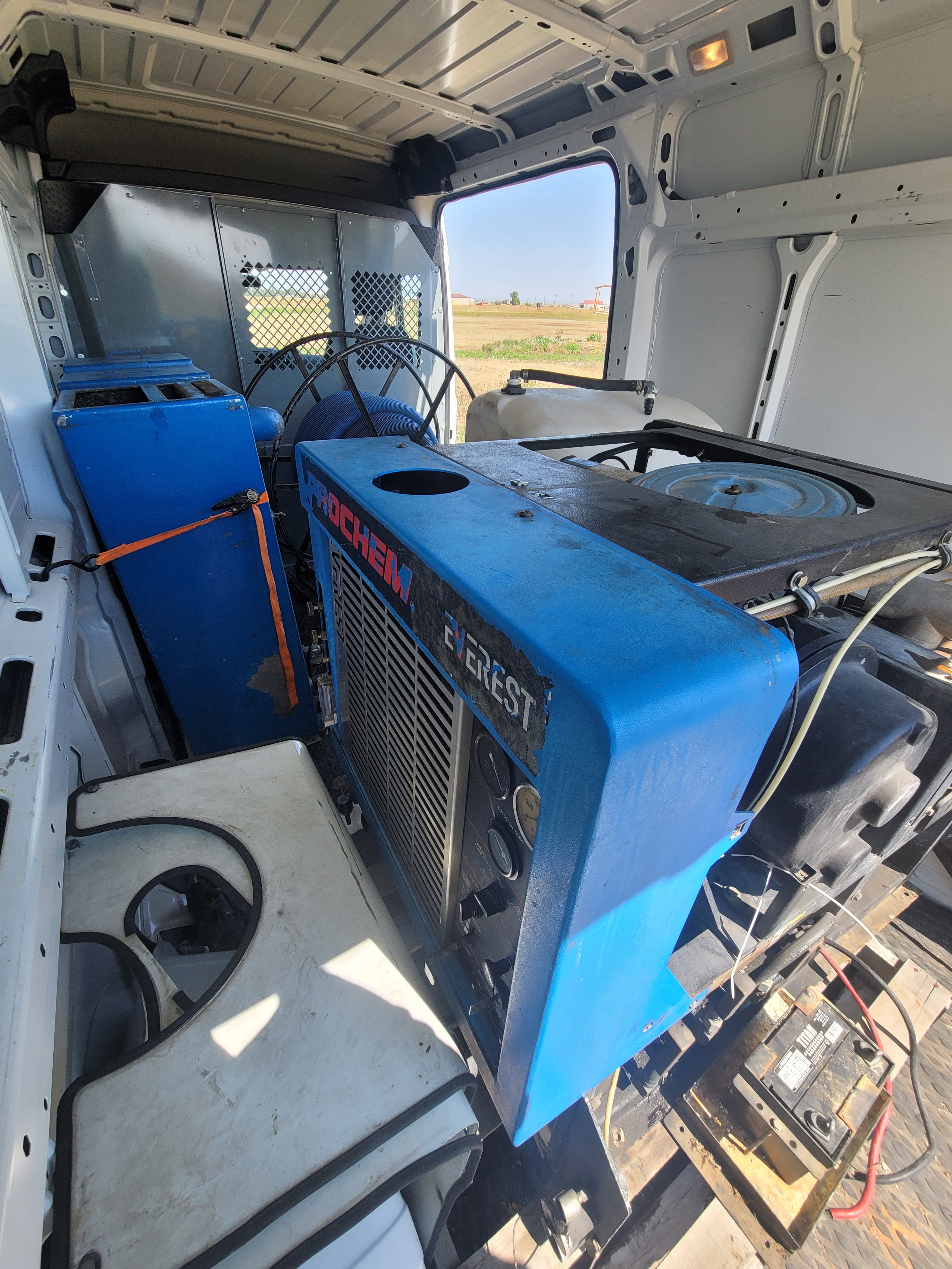

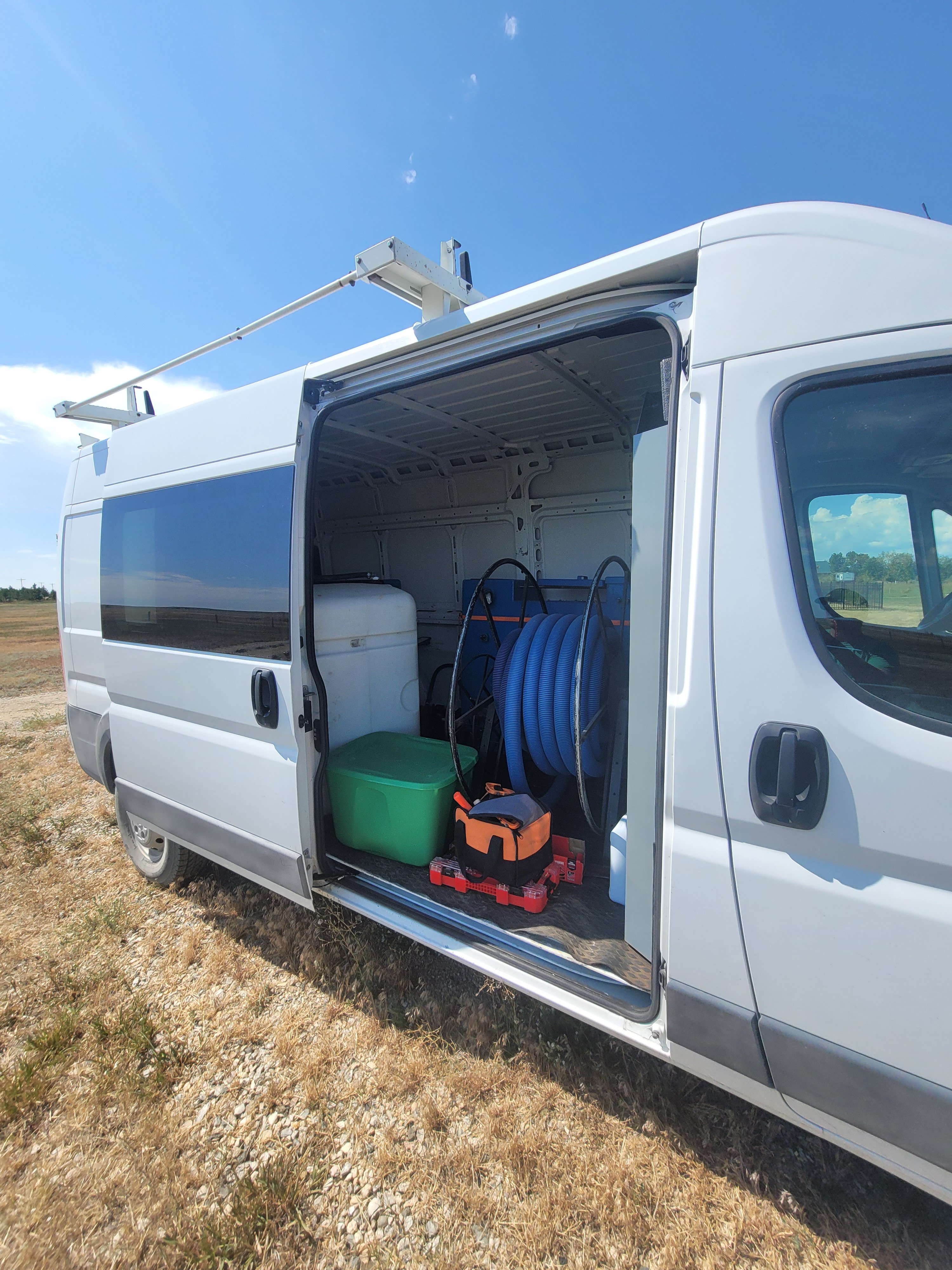

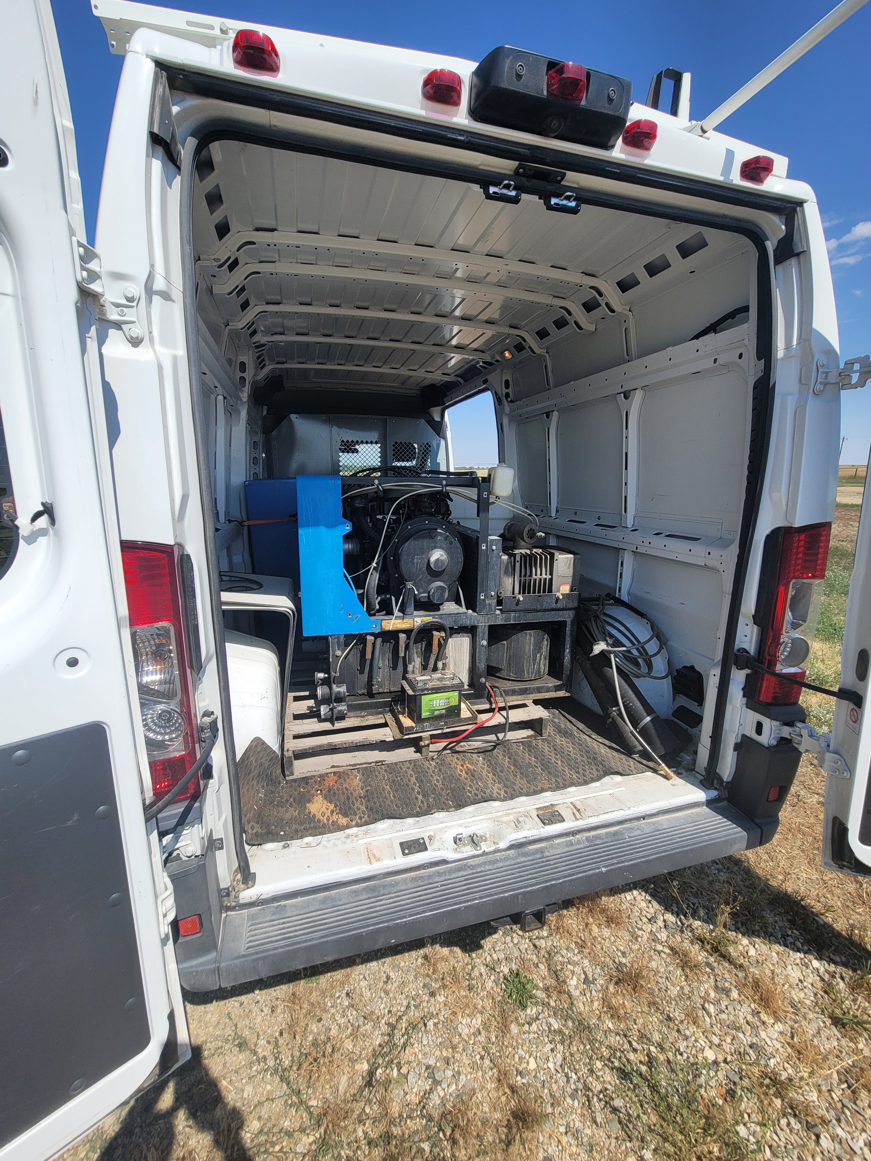

I bought an Everest. Good or bad deal?

While you have it out on the shop floor, check the oil seal on that blower and pull the breather fill caps off to check to see how it's been breathing. If there's a heavy amount of oil on top of the blower around the fill caps...it's clogged. I'm currently using the microgard crankcase air filter material from oreillys as a filter in that cap, until I switch over to the open filterless cap I just ordered
