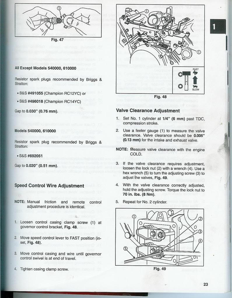

Meanwhile, back to the subject at hand ... SOMEBODY ... no need to say who ... told me to set my valves at .005. So I did and the thing backfires like danny farting. So, I checked and Briggs says .004 on the intake and .006 on the exhaust.
Mr. Knowitallandthensome didn't even tell me about one being the other.
