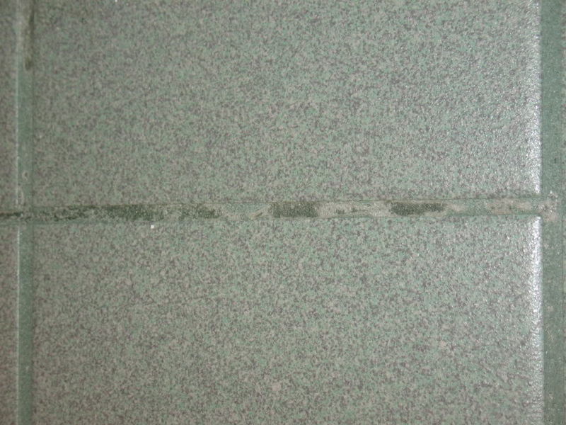

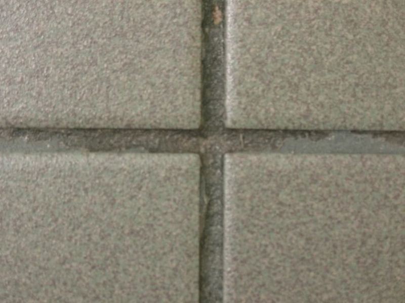

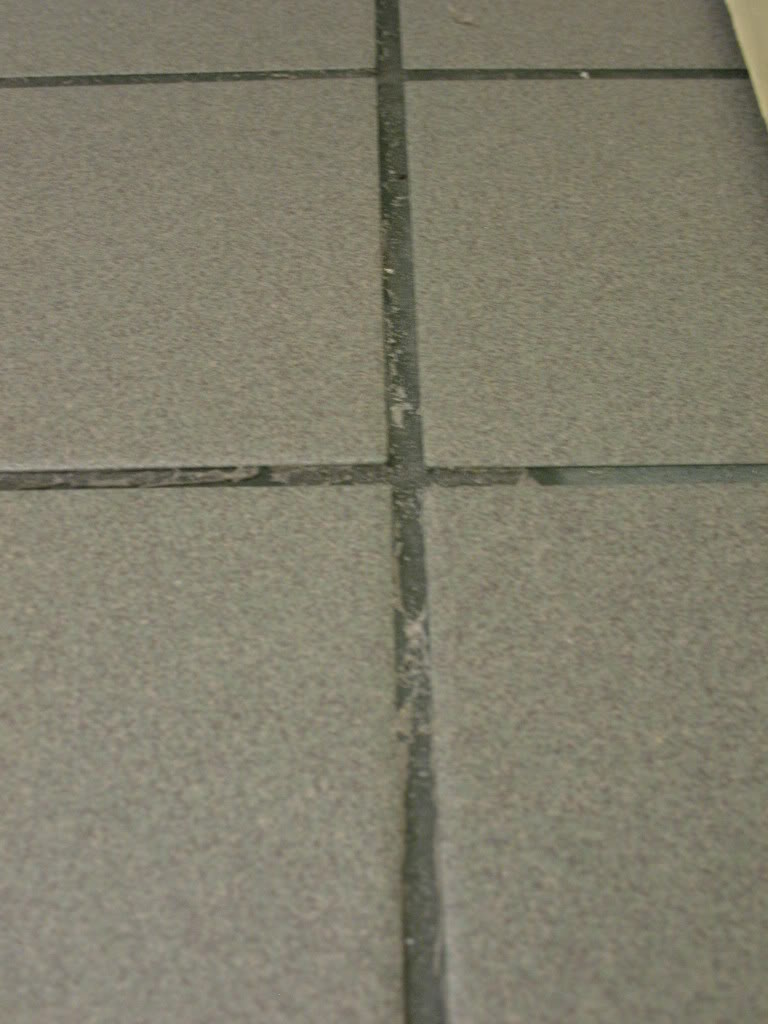

.....and the rest of this story on the sealer on tile.............
Used bare bones mixed 1:4 and let dwell for 40 mins. Brushed in with nylo grit hand brush and then grout brush. Turbo'd off. Small pieces left on grout, let dry and then brushed the small pieces off with with either wire brush or grout brush. Not easy, but did it.
Dwell, dwell, dwell.
