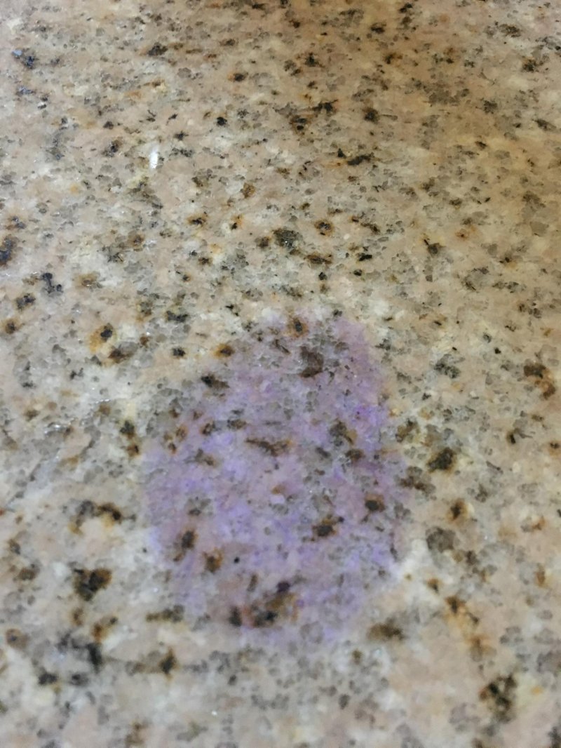

Custy used some Acetone and lightened it but still not all the way out..Suggestions?

Agree with Mikey keep trying-
Dont rub-if the acetone doesnt get it all try below.
Try paper towels folded about 6-8 ply high placed on top of the stain.
Wet the towels with some bleach and let sit for an hour or two-
Should do the trick-if not maybe an overnight poultice of hydrogen peroxide

Try Isopropyl too.
Soak a paper towel in it fold it over the spot and cover with plastic wrap and seal the edges with blue tape

Mikey makes a good point-when we first started doing this we chased every stain that came our way.
Some came out some didnt-others were 98.5% and some folks would give us a hard time about our time!
They didn't want to pay-Poulticing is something you do when your onsite for a larger job. If there isn't revenue there teach them for sure-

Agree with Mikey P......isolate isolproply poultice w/ plastic and tell customer to re apply as necessary. Tell customer you'll come by to check progress after a couple of days and then when you arrive to check book cleaning of T&G , carpet , upholstery... I'll bet you get an easy good paying job just because you " paid it forward" by not charging them to fix their major stain of a expensive surface like granite.

Wet the area with StainZONE. Cover with Stain Absorb with stone for a poultice.
The professionally formulated version works a bit better than the Heloise methods mentioned above.

Ink = Hydrogen Peroxide. Every time.
you have to be careful with ink stains and solvents, you can actually dilute them and carry them deeper into the stone.
