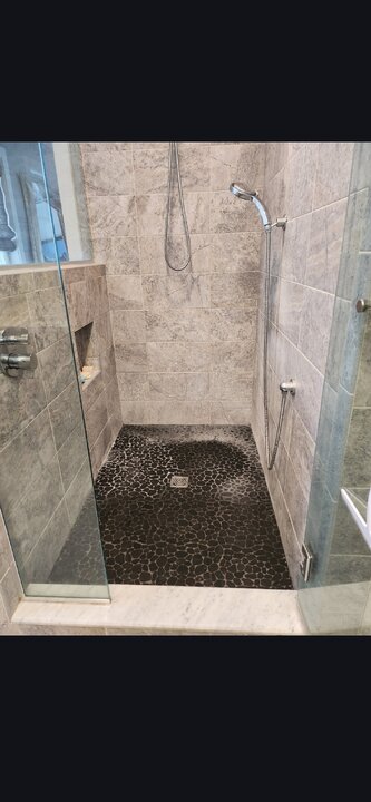

to put slate tiles in a shower? What do you guys think? Acid, dwell and scrub, dry it fast, and use a super sealer? Or just tell her the efflorescence is likely a permanent/recurring problem?

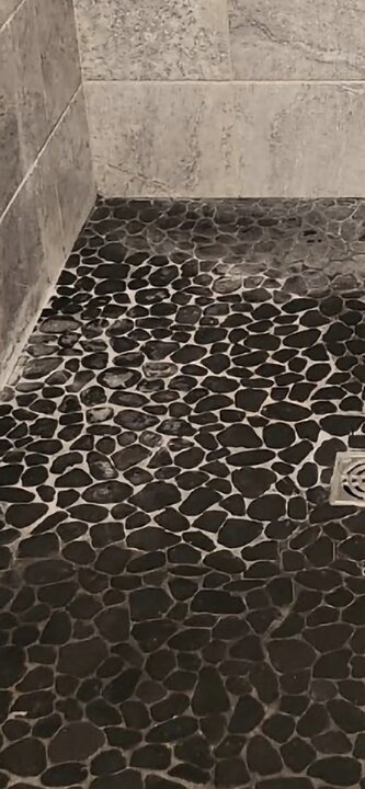

Bryce, that's not Slate
Limestone or marble on the walls, hard to say for sure from that small photo but the pebble mosaic floor can take what ever you need to scrub the mineral build up off them.
Floor looks ultra matt so acids splashing ( probably ) wont hurt
Can you get better and bigger photos?

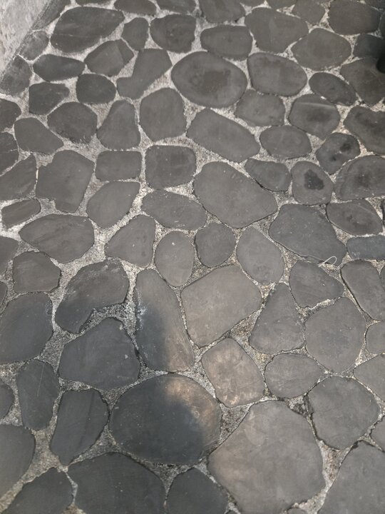

Oh snap, shows what I know. All I can do is zoom in and crop for now. I'll get more pics later today. Thanks for the tips so far.
How quickly will acids dwelling and being scrubbed begin to remove grout when I am doing this? Does that depend on the cleaning agent and abrasion of what I am scrubbing with? What should I scrub it with? I have an acidic tile cleaner called Fizzle from a local supplier, I read some folks uses muriatic acid.
Is the weird shape to the efflorescence just the way water pools in the shower pan?

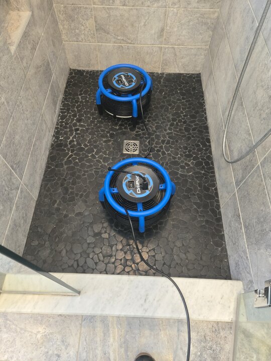

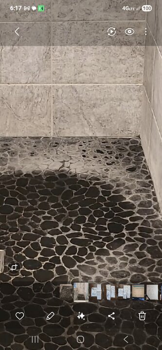

Thanks for the ace advice Mike! The rest of the shower cleaned up nicely, even the glass, but that floor was tough. At first I used a high alkaline cleaner with a nylon brush on the walls, and a brass brush on the floor. Then I used an acidic cleaner around 2 pH or a little less on the floor with more scrubbing and rinsing, and I repeated everything on the floor several times, lots of dwelling, scrubbing, and rinsing. And this is what I ended up with 🙃
It looked better immediately after I finished, but the minerals wicked up to the surface in just a few minutes. I set the customers expectations well beforehand so they were happy with it all. I was in that shower for way too long. I'm going up on my shower prices. They didn't opt for an enhancing sealer to temporarily hide the whitish remains in the grout. This is what it looked like before I worked on it.

I don't know if it is just efflorescence, or if it is also soap scum, but the whitish remains in the grout seem to be spread throughout the grout as if it is woven through it. Whats up with that? Is it just the soluble minerals following the path of the water as it is moving through the grout?

With the amount of wasted time on a shower it takes to make it look a little better, I came to the conclusion that showers are most of the time already ruined before we can clean them. So if 2 different methods of cleaning can do anything (normally about a 30min interval) then it’s time to move on because my customers here won’t spend 300-400 just for a deep detailed cleaning of one shower

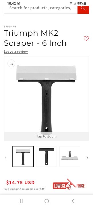

As a window cleaner if i have to scrape windows I use a Triumph 6" razor scraper with stainless blades and scrape in only one direction. If you keep pressure on the blade during the back stroke, contaminants can/will get on the back of the blade and scratch the glass then. Also as a window cleaner a powerful tool in the arsenal is steel wool. But not just any steel wool, bronze wool. Bronze wool doesn't rust and make a mess. Its not coated with oil that has to be removed before using on glass . It is much softer than steel and the fine stuff won't scratch bright work. Ive not tried it while cleaning tile but if you need a light abrasive for glass thats it. And it's always on my trucks. Bronze wool comes in three grades fine,medium ,coarse. I use mostly fine and sometimes medium. Ill take one pad and unroll itand roll another full pad inside to make a larger pad and as it wears down i add more the same way .
