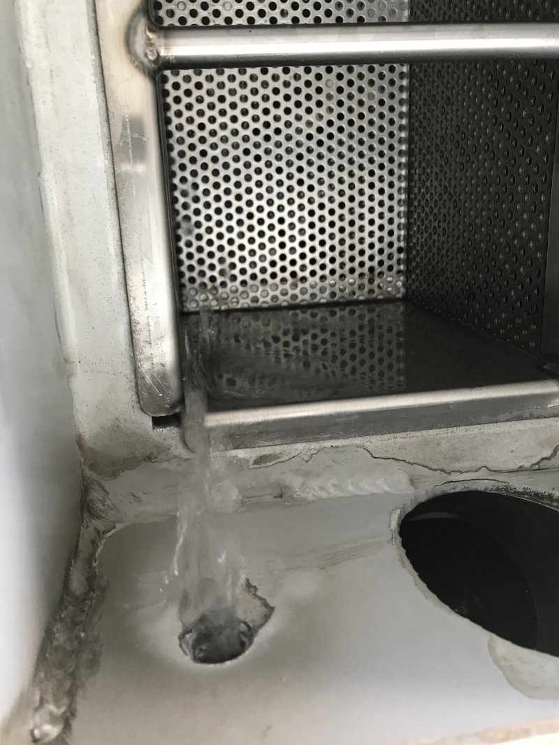

At least they are starting to look better. All I know is the 570 is a heat beast. Divert into freshwater tank seems to be only viable option.

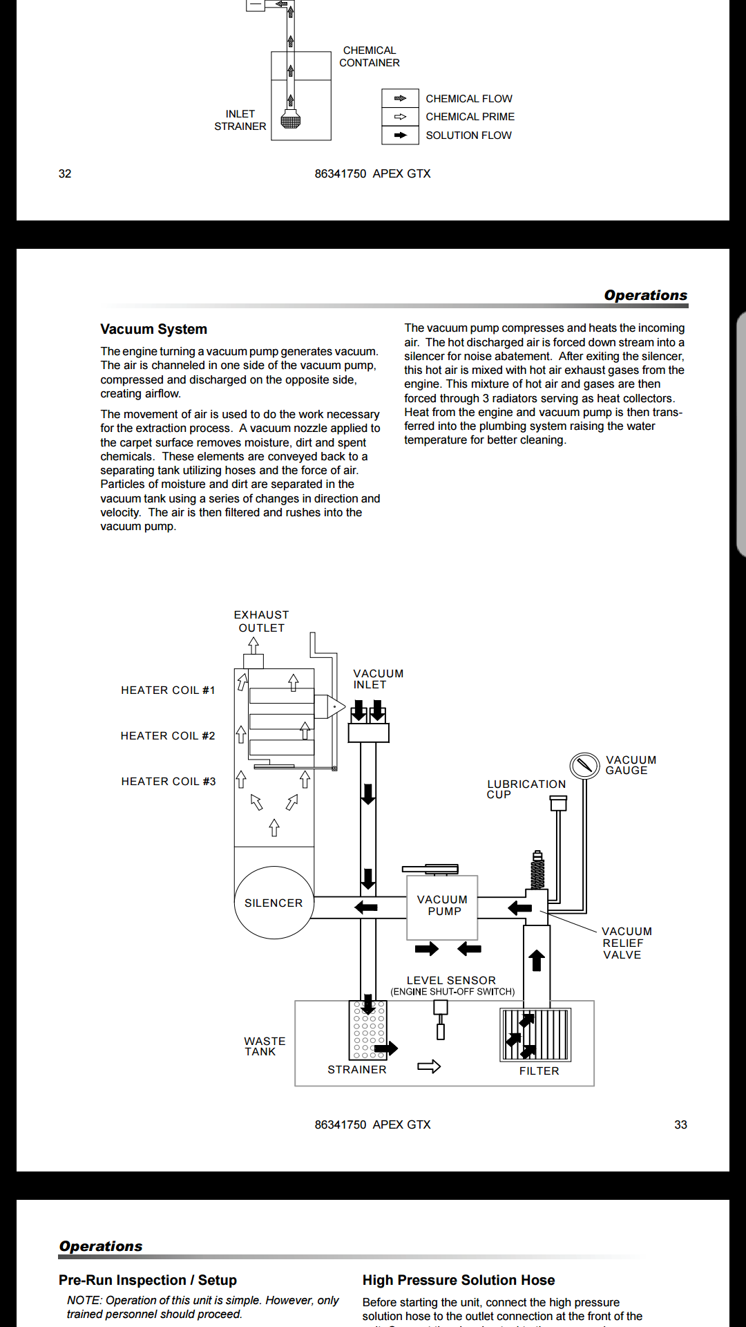

The pic above isnt telling me too much about diverting. My SS370 has a maual diverter to bypass the heating chamber - but I want it to bypass on its own as it reads selected temps rather than dump the water to bring the temp back down.
A
Able 1
The new Gtx diverts the exhaust, at least that's what it looks like to me.. I was looking into it because I noticed they changed the heat control lever position.. I saw it on @Dan Lofsten post, and wondered what they did.. Maybe he can fill us in..
