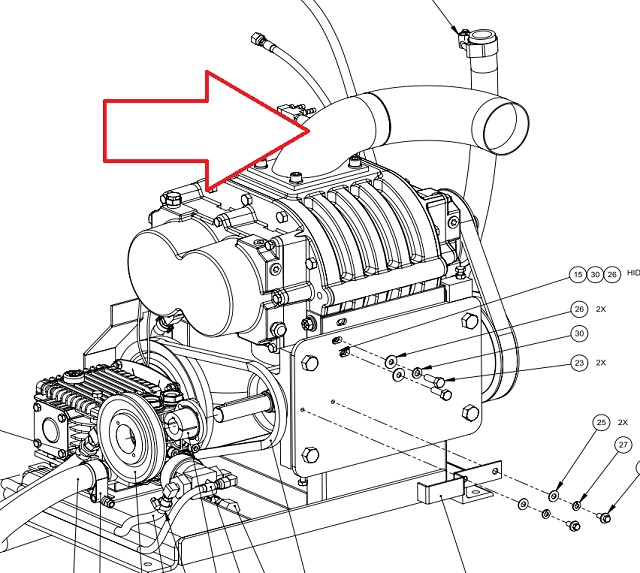

I don't understand how blowers work, so I have no idea how the air flows through it and what could possibly get into the intake, to cause the blower to have resistance like that.

I wouldn't open the blower just pop the inlet piping and look in....and give it a spin to see if it spins freely
but based on your last post it almost sounds like there is a vacuum that can't be broken that increases with rpm bogging it down........like something stuck in the inlet system or collapsing (could be on exhaust side too)

This may not explain why the blower is hard to turn by hand but if the engine is bogging down you may a restriction on either the suction or discharge side. I had a unit with a blower heat exchanger. The coil inside the exchanger moved and restricted the air flow out of it. This cause the engine to dramatically bog down after it reached a certain rpm. The blower could suck all the air it wanted but was unable to discharge it.

It may be difficult to feel any difference in actual air flow or velocity. I was able to remove the heat exchanger and test the unit without it in place. The unit ran perfectly without it and after further inspection I found the coil had been allowed to move and restrict flow.
