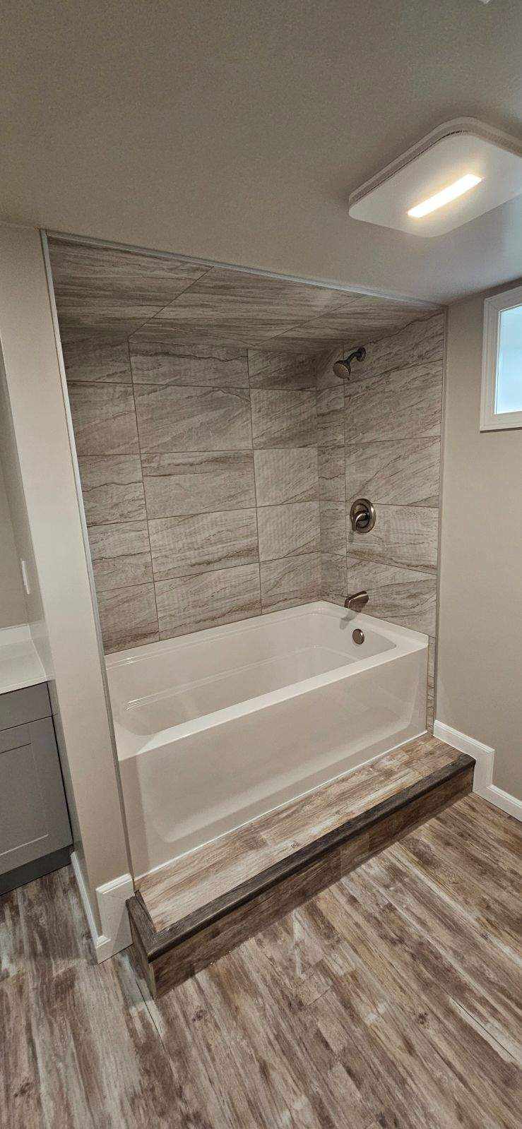

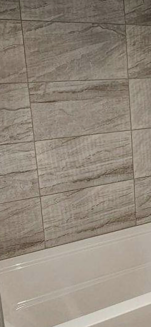

Is this porcelain translucent?
116,037
Homeowner says the lines showed up the day after being installed...
Can a notched trowle be used that symmetrically in the real world?
Yes it can be used that symmetrically because it just gets dragged up/down.
Hopefully it will dry out...not an uncommon issue to see adhesives/mortar through tile/grout
grouted too soon?
