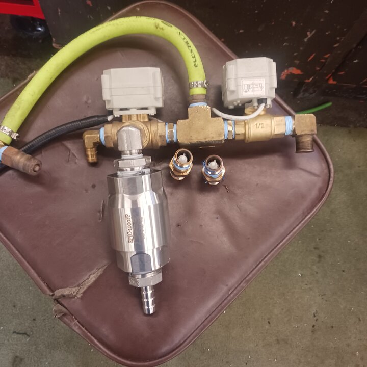

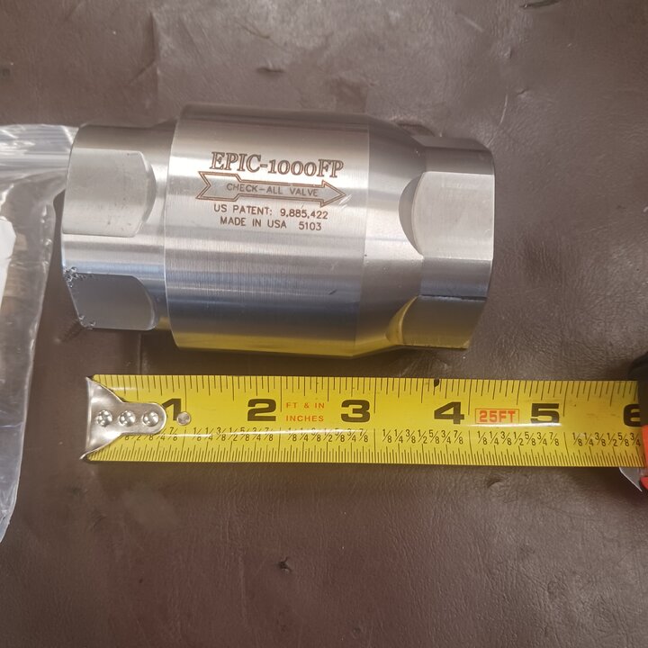

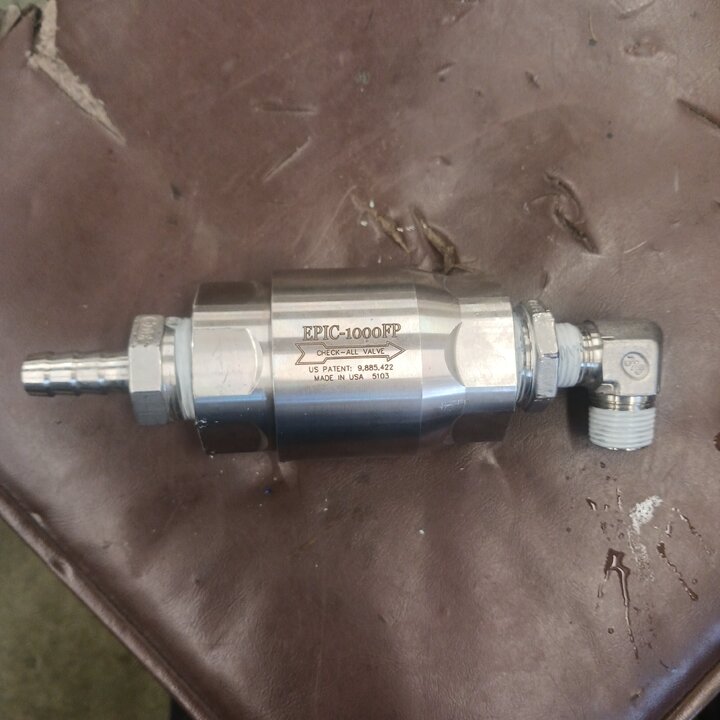

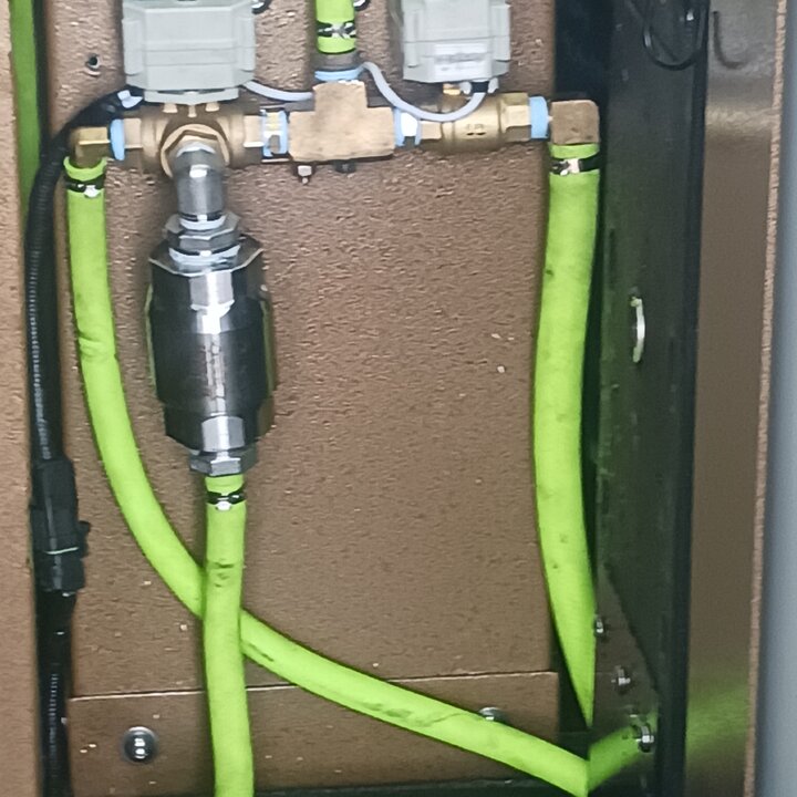

I actually use the waterpond alot. Over 70% of the jobs i do are on wells. pressures sometimes to low and summer there's water shortage. I mostly use it for low pressure . My machine has a low pressure safety switch that disconnects the pump clutch if the incoming water pressure is to low. When this happens i switch to the on board water system. My system is set up so as when i push a button to turn the pump on the system automatically reconfigures and the live reel that normally feeds customers water to the machine is on a 3way motorized ball valve. When the pump is turned on the ball valve automatically redirects water to the waterpond fill and a 2 way motorized ball valve opens up and allows the waterponds pump to supply the machine and when i push the button to shut the pump off, the system resets itself . There is a oversized check valve on the live reel side so if i use the waterpond without the live reel hooked up water doesn’t back flow into the van.( yes i know a 1" check valve is overly large. These valves are the best and have a low .5psi crack pressure, i got the 1" new on ebay for 50% of what it would have cost me for a 1/2 valve) originally i used 2 rv check valves inplace of the 1" but the crack pressure was 5-7psi and didn't really work well
