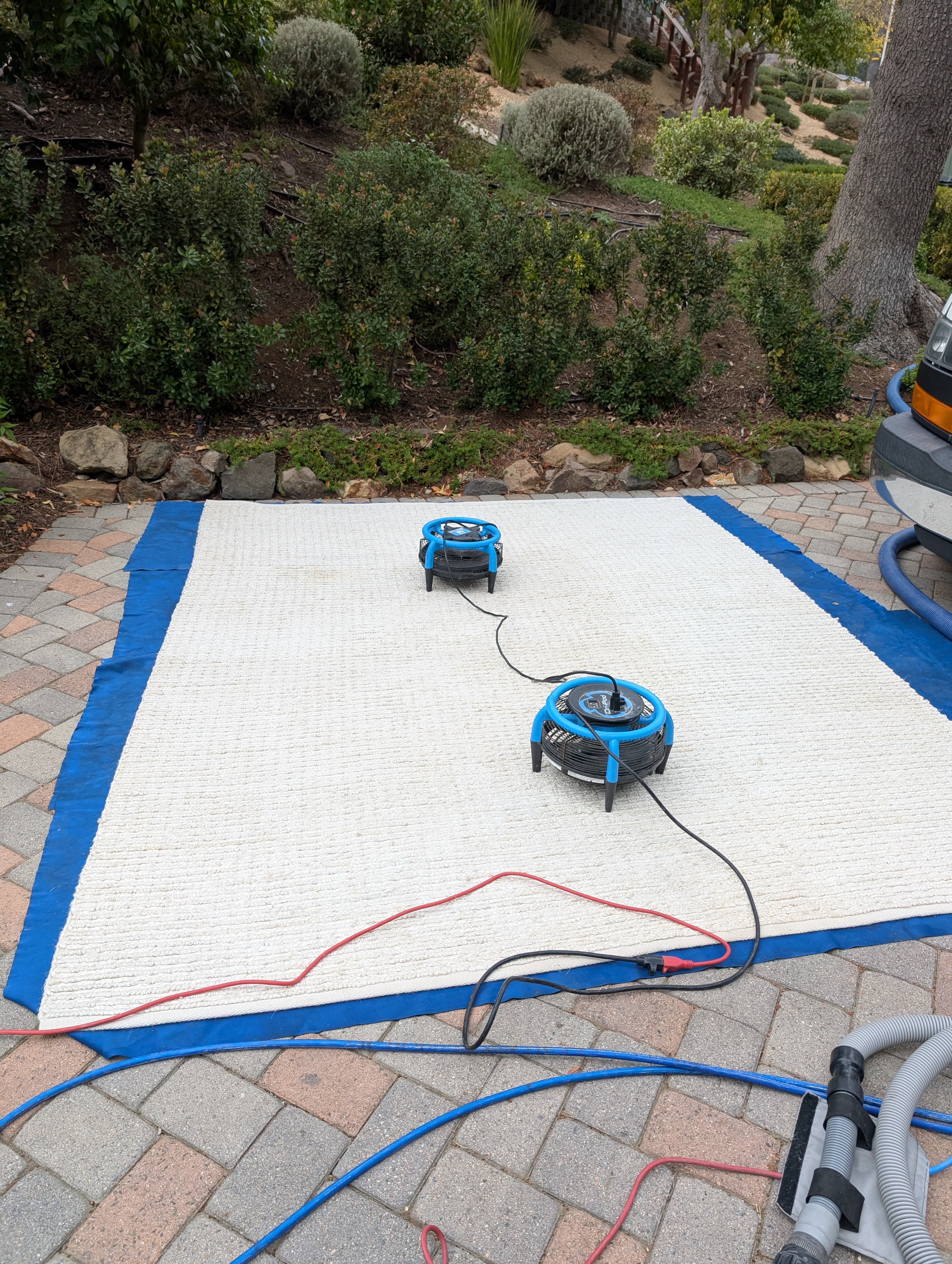

White jute rug, green Dog vomit stain.
11,420
@Jim Pemberton
I cleaned it with a light pre spray of prochem fine fabric pre spray and a splash of peroxide in a hand sprayer misted evenly.
Rinsed with natural fiber cleaner and sapphire upholstery pro.
The grass puke lightened up considerably, also it turned yellowish immediately when wet.
I would've loved to run a little more more water through it on a hot day in the ☀️.
Reactions: Jim Pemberton
12,717
Nicely done!
Peroxide can turn cellulose fibers yellow, I find myself increasingly wary of it unless necessary.
It seems in this case that it was a winner though :)
