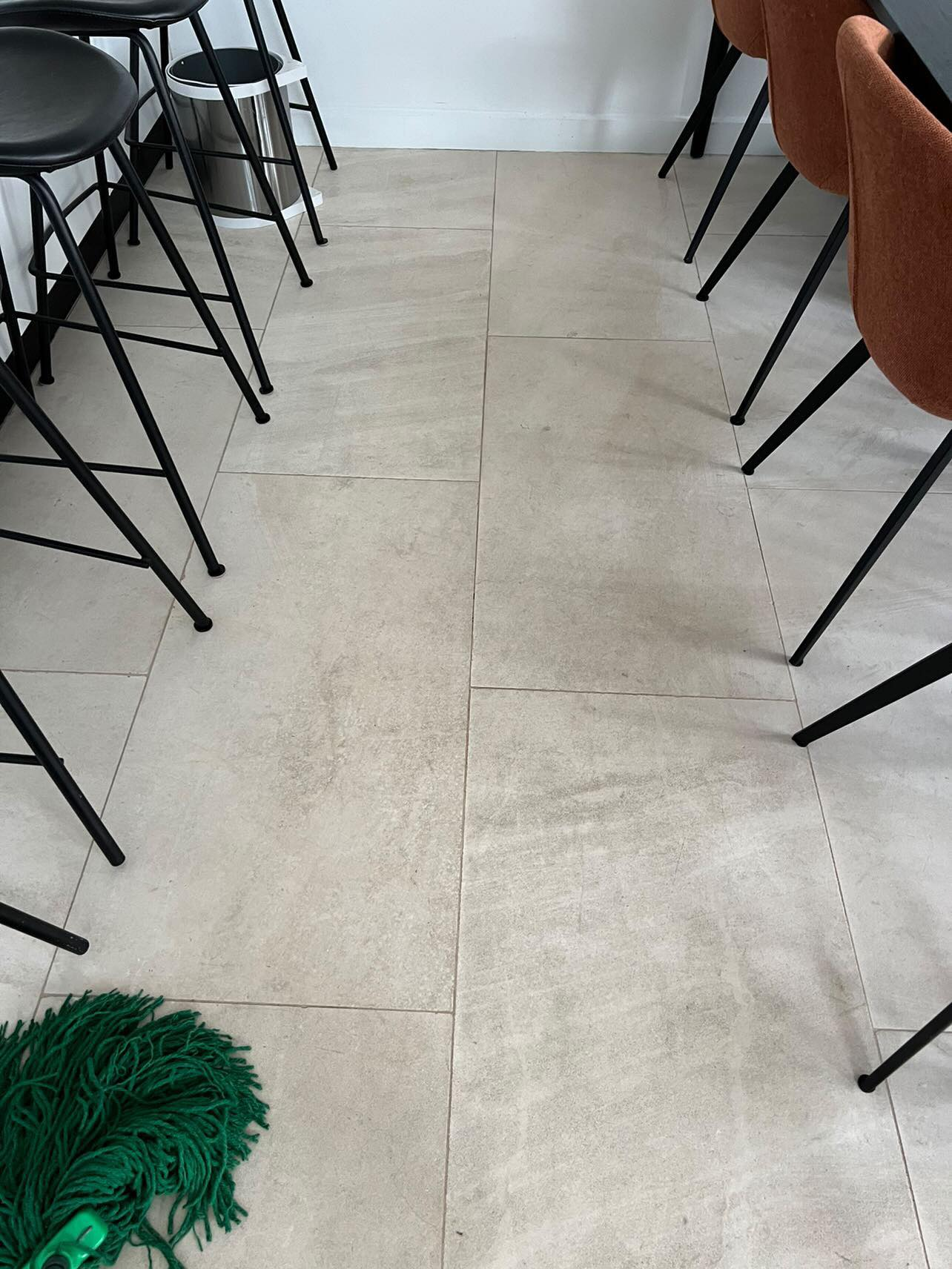

A friend's client has some honed? limestone floors that need a clean. On the bottom right she agitated some dish soap with a brush and that was the result. Will a 175 with a nylon brush and a spinner with some neutral cleaners be fine? Or should I go more alkaline?
116,038
175 and a brown 3M fiber pad would be better.
Nuetral MAY work, a 9-10 will most certainly.
HS will be fine, stay below 700 or it may streak, as will a spinner
