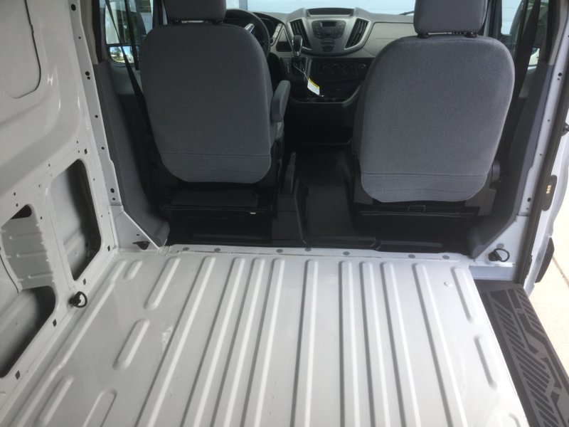

Hello all! I recently purchased a new Ford Transit van. I am taking it to the Line-X dealer tomorrow to get the floors bed lined. I want them to apply the Line-X coating from the back to the front, including the footwells. Also, they would apply the coating going 1/4 up the walls. The Line-X dealer is suggesting instead of applying the coating in the footwells, they could put a small berm behind the seats and put Line-X over the berm. The berm would not allow water to run into the cockpit area if there was a leak. They said this would enable me to keep the factory floor matting up front (which is contoured and covers some wiring) I prefer taking the front mats out and replacing it with the coating. What do you think? Thanks in advance.

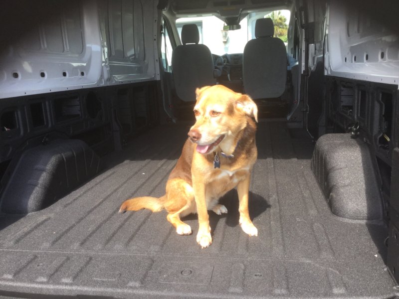

I'd do the whole floor, put the berm on and then reinstall the factory carpet. If your gonna do it then do it all. I did what your dealer is telling you and still got water up front . At least it will be protected.
Reactions: Bill P
28,265
I did that in my vehicle and it works great. A little unsightly the way I did it but keeps the water out.
Reactions: Bill P
We've done the berm.
We screwed down a 2x4 and coated over it and its worked great for years now.

Thank you all for your feedback! I went with Line-X coating up to the cockpit area. They ended up installing a small bulkhead behind the seats so water cannot run to the front footwell area in the event there is a water leak. I am also going to install a permanent cab wall and seal it to the bulkhead for further protection and security.
