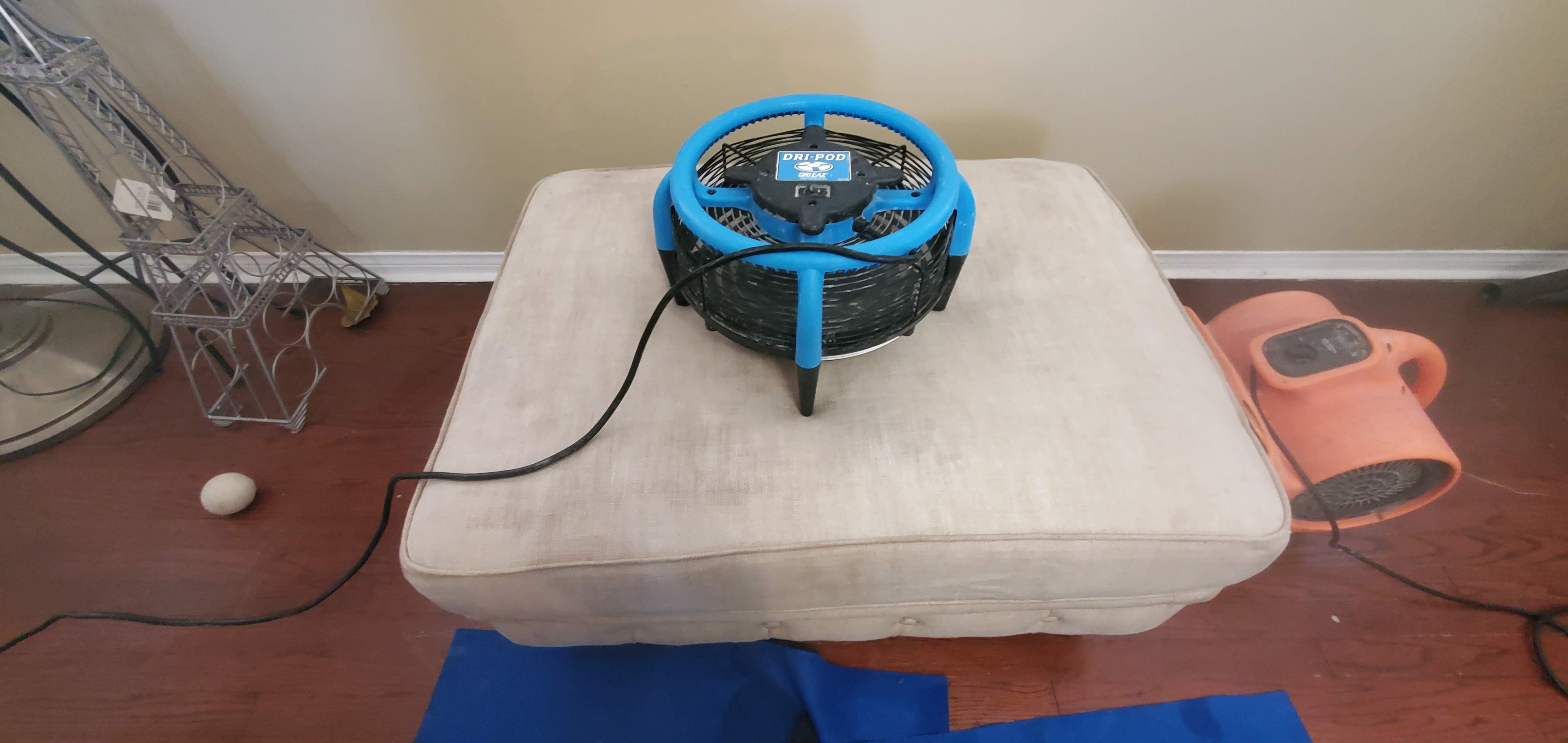

It's hard to tell when it's clean. Good prespray, thorough scrub, rinse evenly and do multiple dry passes. Use fans. Do the worst pieces first, often they will be dry before you leave.
