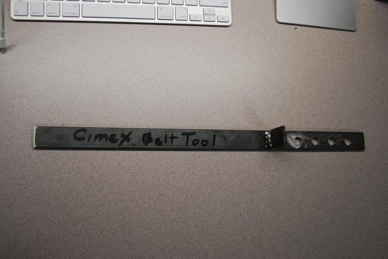

You need one of these:rockon:. I had to replace a bearing in one of the pulleys last week. Makes it much easier and safer.
