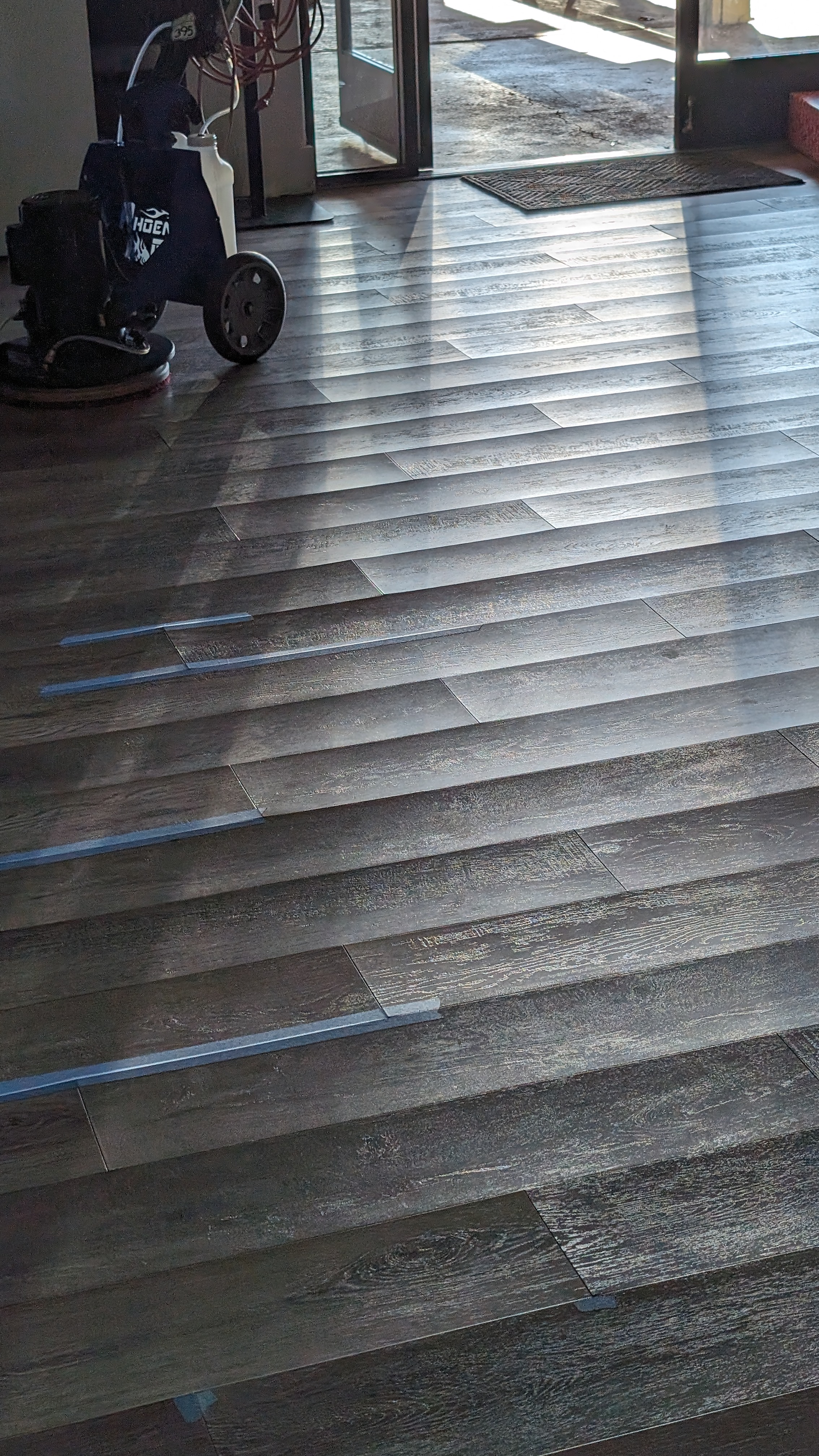

The contractor glued each LV-Plank to the concrete subfloor "because I've always done it this way"..
6 months old.. PXL_20240105_185758641.jpgPXL_20240105_185817499.jpgPXL_20240105_185834383.jpg
if that's glue down plank and not floating clicklok, where did the installer screw the pooch?
wrong glue or material wasn't acclimated?
Reactions: hogjowl
What caused this damage ?
Hard to say. IDK if "that damn installer glued them down not allowing for expansion" is the answer though. Are they actually click-locks (like mikey said) or one of the many LVP planks that use either a glue down or pressure sensitive adhesive?
That is cupping and ultimately the cause is moisture (bottom absorbing it and expanding). Since it appears to be on the main level (on-grade concrete) I'm more inclined to believe it is subfloor moisture causing the issue. That may or may not still be an installer issue because the moisture content should be checked (<4% usually)and for some products the floor "sealed"/moisture barrier/adhesive. Possibly too wet adhesive.

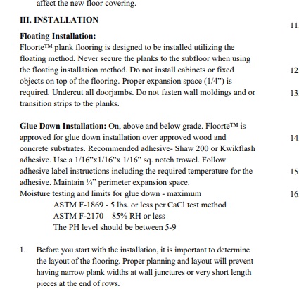

*assuming other recommendations like acclimation were followed
I'd expect even a midwit like Mike would know if clickloc or not...
my best "guess" is cold material that spent a high desert winter night or three in the van and pulled right from the van to the floor.
and/or possibly a cold weather install before the HVAC was operable/running in a rush to complete a rehab
(been there/done that..."once" ) :icon_redface::dejection::hopeless:

It's moisture...
you wouldn't get that degree of cupping with weather related temperature/humidity changes imo
moisture moves through cured concrete (capillary action)...purpose of vapor barrier/sealing
as far as "click lock" I mean that the planks are only allowed to be floating/ gluing them is not allowed (like LifeProof)....this is not the case for all "click-lock" lvp products
*most are float only but we don't know what product was used

I wasn't called in to address the situation, I nearly asked questions to the owner of the biz.
His landlord and contractor are battling it out .
Owners says click lock, no moisture barrier, over 40+to concrete, no leaks or flooding, damage is in select areas, appears to have an odd non vinyl but not MDF core to it based on my digging up a corner after he left.
I told him to get a third party inspector but he didn't want to rock to boat, just yet
