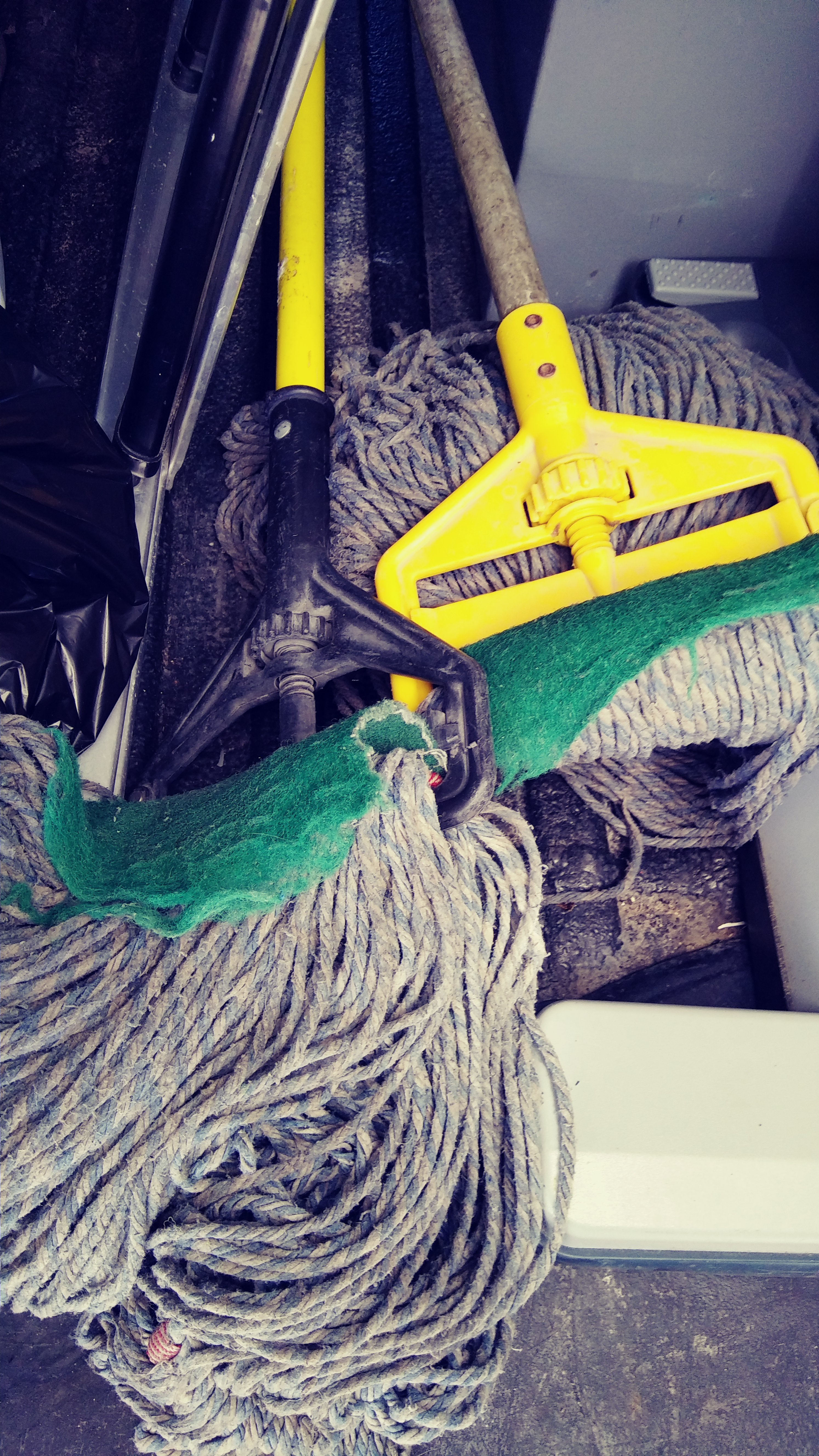

I'm a bit concerned about using a green scratch pad though as that will most likely scratch the surface, won't it? I suppose I could try an inconspicuous area before going full throttle :)

I've been using green pads for 40 years on Oct and tile and have never had an issue. 20190420_174507_Film1.jpg

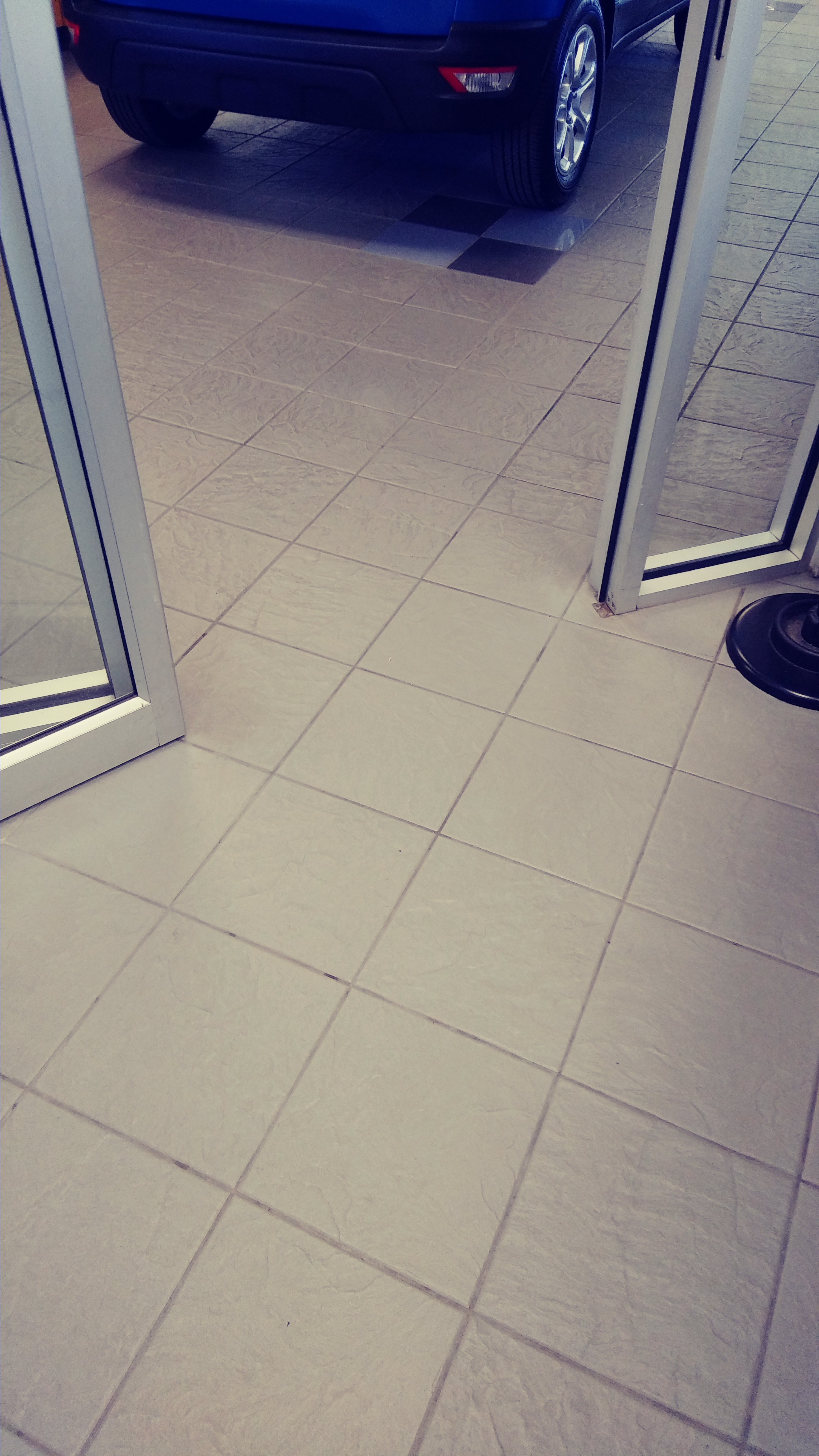

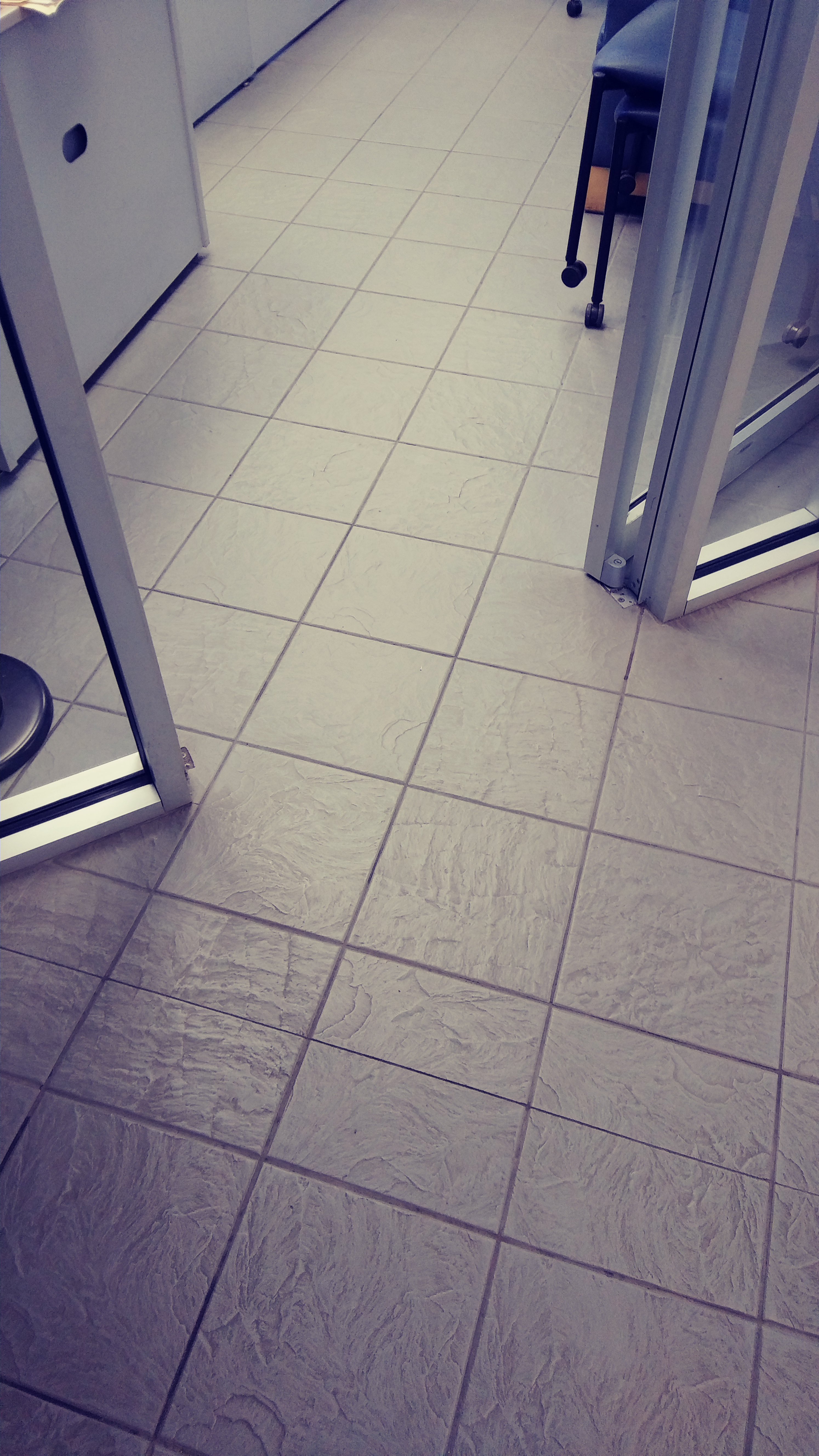

Here's a room I cleaned about 4 months ago. You can kinda see how the room still looks good compared to what hasnt been cleaned. Just a splash of the neutral cleaner in a bucket of water keeps the floors from resoiling along with wringing them out right keeps it from streaking too.20190420_164047_Film1.jpg20190420_164112_Film1.jpg20190420_164112_Film1.jpg

And all you use to maintain the tile is a neutral cleaner and those mops with a green scrubber? Do you use the neutral cleaner on VCT too or just ceramic tile?

I would imagine its the same but I get mine from interlink. And yes I use it on tile linoleum laminate and wood floors. You can wash walls with it too.
