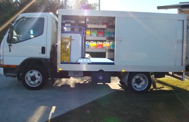

Picked up a second hand Mitsubishi Canter truck with the pantec already done. It has 4 sliding doors, and barn doors on the rear.

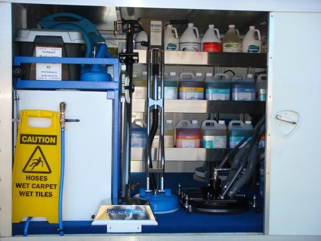

Passenger side front slide view fully loaded - there is twin 450 litre custom built water tanks. These tanks can be either used as fresh water tanks (as they are plumbed live, or can be used both as extra waste tanks, or separately as an extra waste and/or fresh tank. Sitting on top of these is a shelf to carry 3 airmovers. It is carrying a Greenhorn wand, 12" Hybrid and a 16" water dragon for driveway clean and capture. The stainless steel chemical shelf in the middle also acts as tie down barrier to separate the front section.

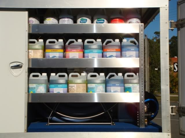

This is the passenger side rear slide view - Another stainless steel chem shelf. This one is very easy to reach and access without climbing into the pantec.

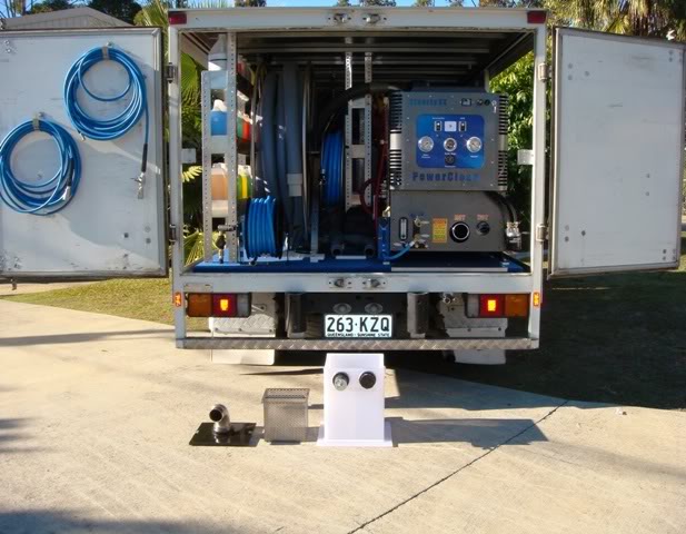

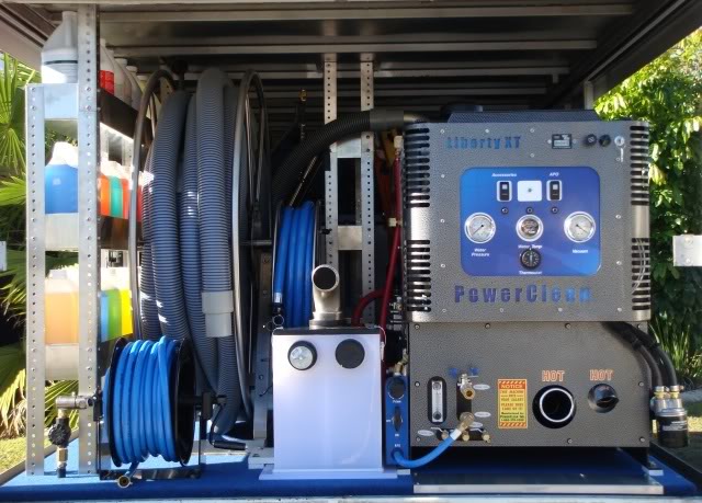

This is the rear view of the pantec. This is the new model Liberty that has had some very well thought out upgrades. One of the visible ones you can see, is now how easy the oil filter is to access on the bottom right hand corner of the machine (same as the Genesis series).
This setup is making full utilization of 2.5" hose. The external filter has both 2.5" and twin 2" ports. Saves alot of the debris from entering the waste tank, thus making clean up at the end of the day much quicker.

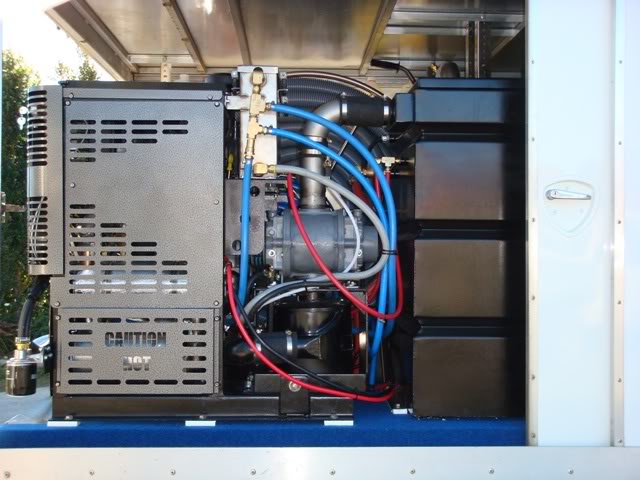

Driver side rear sliding door view - Servicing on a machine doesn't get ANY easier than this. With twin sliding doors all round, it gives access to all parts of the machine.

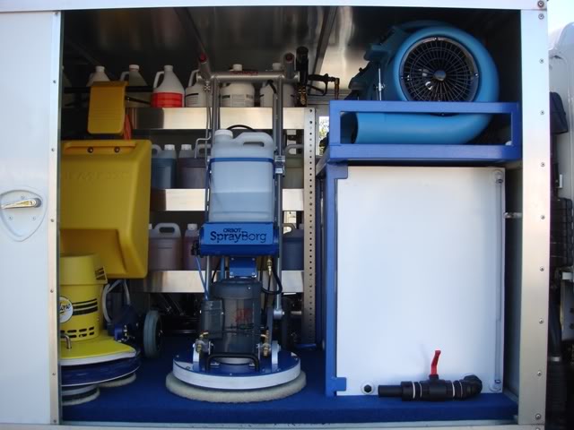

Driver side front sliding door view - loaded with the necessary toys.

What are those solution hoses - they look massive.

We don't call them bottle trucks over here either Heathrow. That is just a NZ thing :p Are you talking about the solution hoses on the back door? They are an Italian hose we source. With all the PowerClean machines being at least 2000 psi enabled, and the Genesis being 3000 psi, we cannot use the 1035 HT or Goodyear hose as our machines are outside of spec range. We use this Italian hose, put stainless swage fittings and quick connects on. The hose is rated to 4000 psi and 285 deg F, so it fits into our machine performance. It is no heavier than Goodyear, and is just as flexible. Just a lot more durable!
