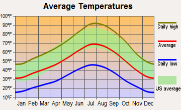

How low do the temps get in the Winters there Mike?

Looks like awesome weather, maybe even 4 real seasons!
I bet you won't have to sweat it too much. It's the sustained teens and below that can cause trouble. A decent little electric heater should be all you need. Set it at 40 degrees in the van and relax.

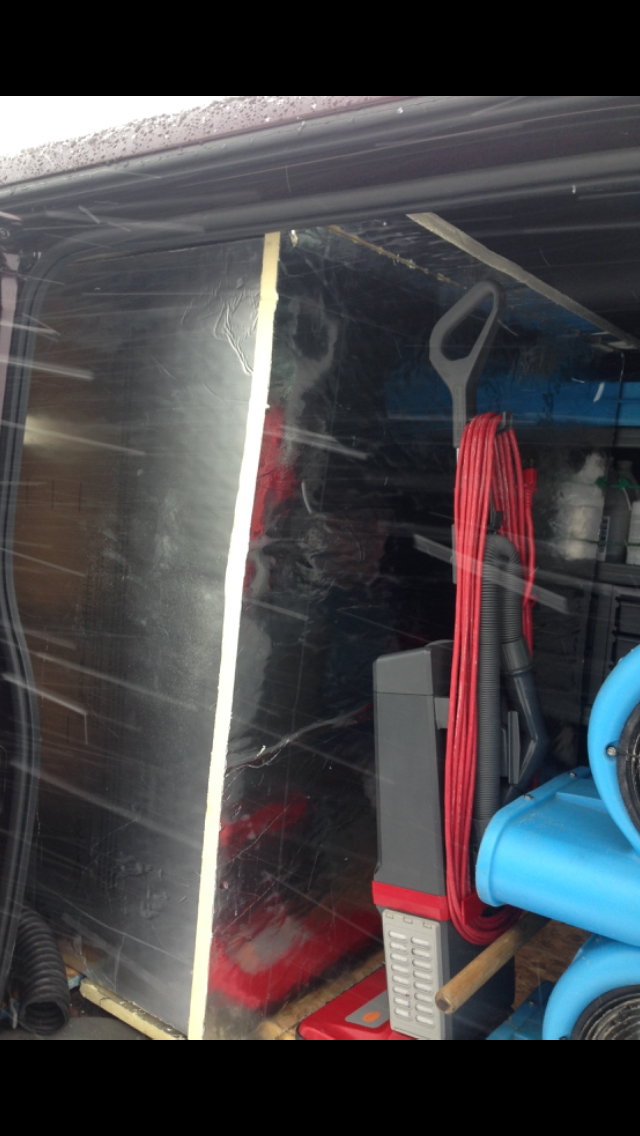

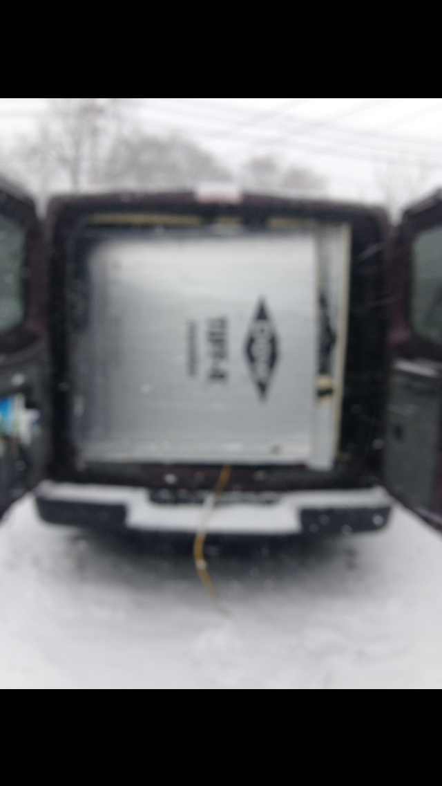

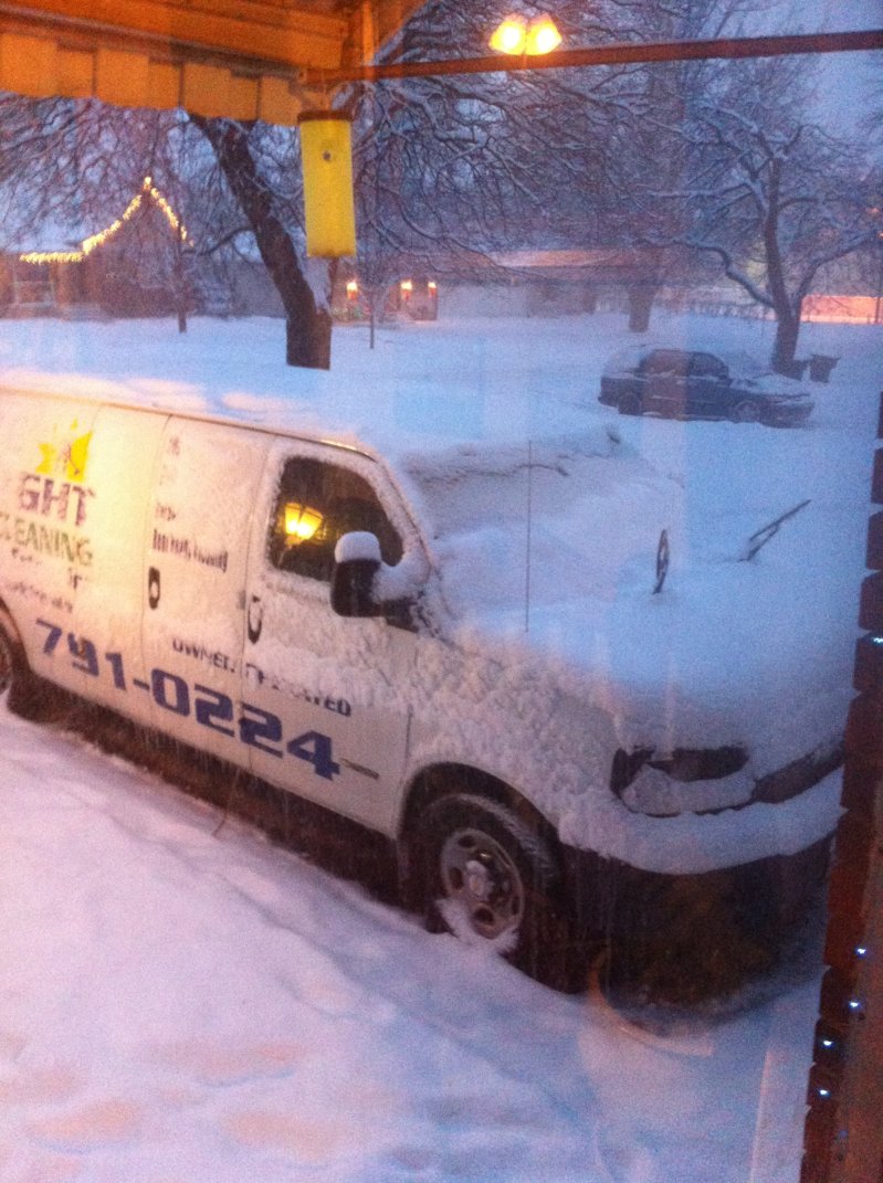

My 1st house I insulated the garage and didnt have to plug in a heater until it was less than 10 degrees out. This past wintewr was the first with parking outside and will be the last. Pluggin in the heater melted roof top snow then as the water flowed down the side - it froze the doors and wiper arms. There was like 2-3in of ice around the arm that had to be chipped daily along with chipping the door cracks to avoid bending the metal.

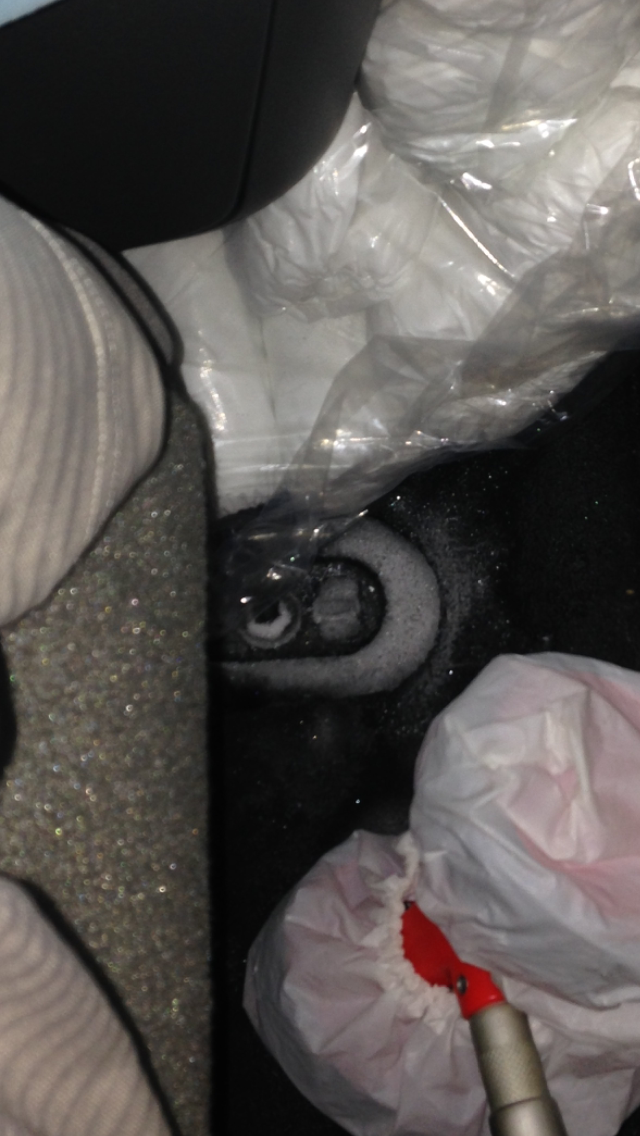

Then you can see the floor was trying to freeze over .. behind the seats

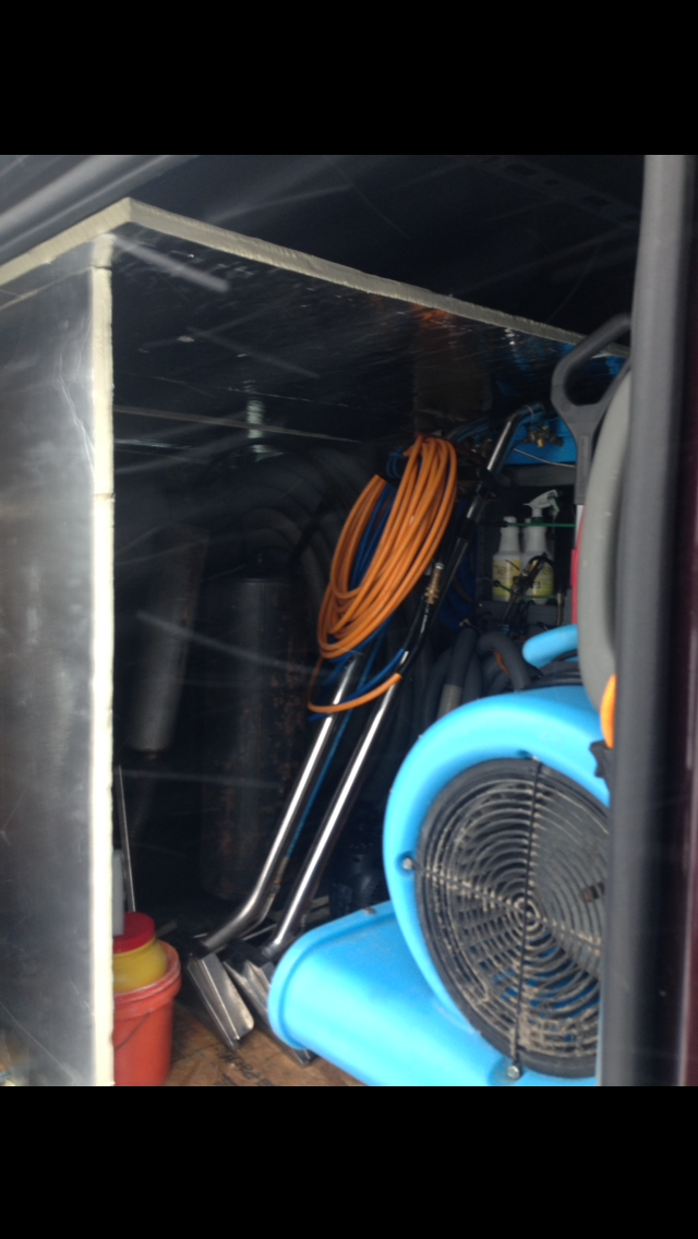

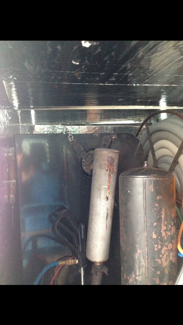

I boxed my mount, hoses and tools in with this insulation board including exposed floor space.
