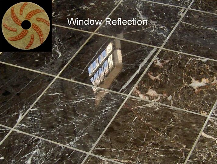

Here is the clarity of a similar marble floor I did with 400, 800 and 1500 diamond floor pads:
The best system for marble polishing is the heavy metal diamond driver along with the rigid diamond discs.
It is however, more dependent on a perfectly flat floor to eliminate the "window pane effect".
(Notice the effect between the stones)
It also costs more for the rigid diamond discs (about $192 for each grit required).
Diamond floor pads are ~ $75 per grit required.
Our experienced stone refinishers use both the diamond floor pads, and the rigid diamond discs (we supply both systems).
