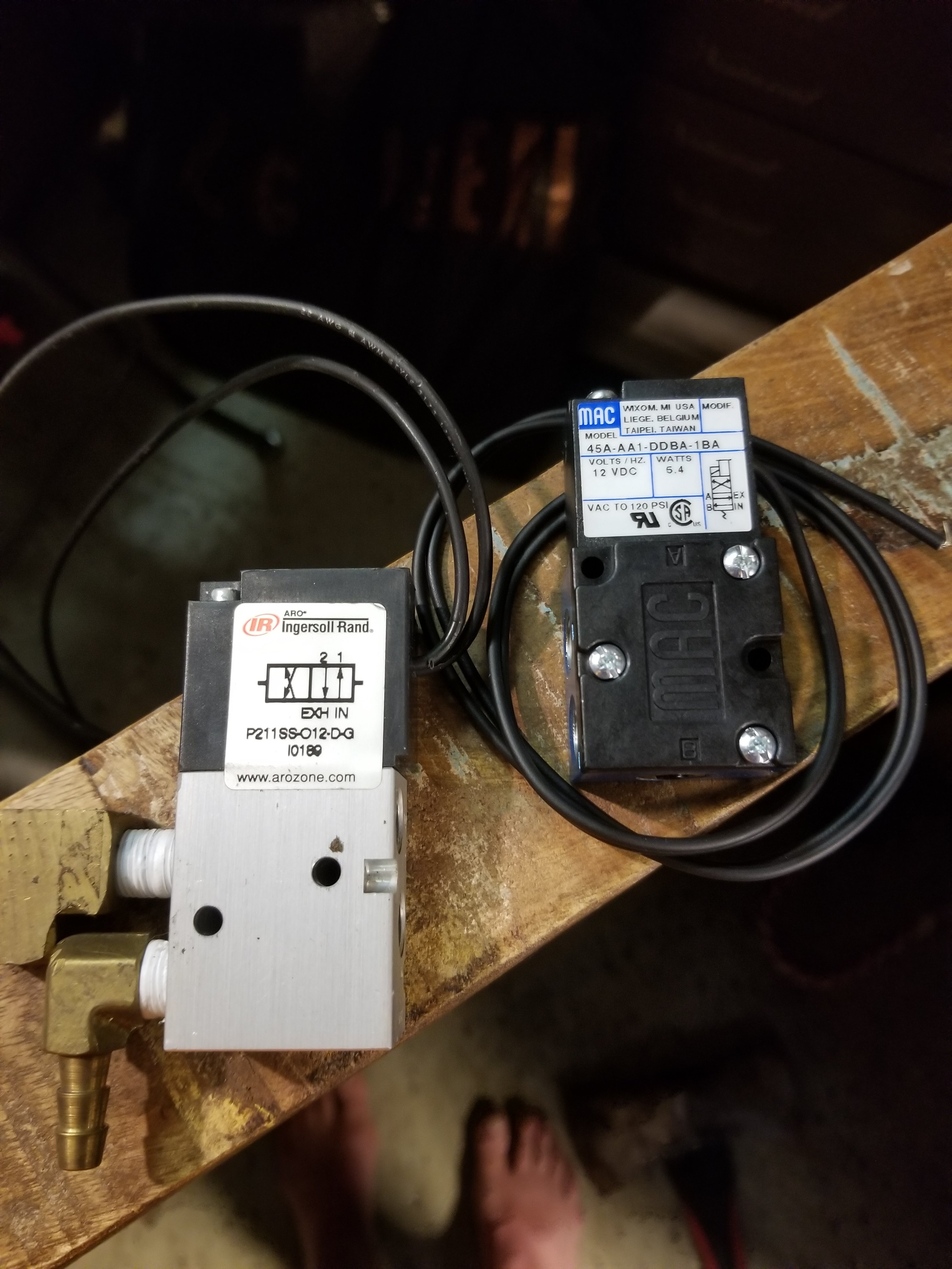

This what a MAC valve looks like.
Reactions: Jimmy L and FB19087

Yes, that's the one. Mine looks slightly different but it has that diagram on it and it has the MAC inscription. I had it replaced a little more than a year ago. Probably too soon for it to go bad. So maybe the pods are the problem this time. When I pull on those cables that are connected to them , the idle will come up. But it won't stay when I release. Turning up the idle on the pod adjustment screws is counter clockwise, correct?
It is so strange that when I turn off the CDS that the truck engine is also turned off now. I'll try again tomorrow to see if it still does that.I'll also mess with the set screws in the morning It was too dark to see when I noticed I had a problem.
