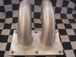

Now in the pics you will see Kool Kuffs and the Kool Kuff wye,etc...
By no means Am I saying you must buy this or that...
My Butler was retro fitted with them,about 2 years ago...
An I am just keeping it uniform...Now If you do choose to duplicate my setup with Greenies or any one Else's stuff...Fine...
I did not do this to be any ones ad boy...I just prefer to stay with the stuff.I have in place...
One area I was not to happy about.Was assuming It was 95.00 for a rear port installed by Butler...
Due to the fact as the pictures will show...I run a seperate pre spray line.
An even thought the port is 3.5 inches wide with the hose ridges and solution lines...
There is no way 3 will fit.Also Since the wye is at the rear area.It makes sense to have its own op area...
Now what the pictures will show is 2-6 foot hoses coming from the elbows to the wye...
Those will be chopped smaller to allow a wye hook up to the live reel...
For hose management...I seem to be able to fit about 125 feet of 50 foot 2.5 and the rest 2 inch...
As the new 50 foot 2.5 arrives.I will see if it varies and will report back at that point...
The new hose will be 50 ft continuous.The other as is the 2 inch are chopped at the 25 foot marks.So as to allow replacing back on the reel as lines get shorter...
When you see the way we pre spray,remember a new metal tank is being made ,so after about 20 years the jug will be history...
There may be some items out of place and strewn about.But bear in mind this situation too will be rectified.Would have been today,but not one of my better days.If You know what I mean...
It seems if you get a port installed new it is 95 dollars...
But that same port when not in a new van is about 150 with labor and tax...
Now in 93,I had a port put in and it was for 95,but that was in older van too...
So if you think I never get mad about a Butler ,you are wrong there also...
Even though 99.9 of the time I am very Happy with them.There is still times when I shake my head and just walk away...
It seems that 2.5 makes no sense to them,nor the fact you use a 1.5 inch whip line...
But after 30 years,what do I know...They build them...I do not...
Now I am sure some one will report this comment to them...But I have been used to stupid looks all my life...lol...
Now all in all,the whole retro fit was about 650 dollars...
The elbows which I could have got wholesale were actually bought at Butler,due to the fact it is near where the lid was done...
But the lid and weld cost less then the plastic elbows.These will be changed to a less angular sweep metal pipe(2.5 inch)
150 for the port,and about 400 for the stuff I got from Joe...
Now you can probably do it for under ,what I paid for...But for the price I am pretty pleased.She is done.The hoses are all on the reel,the ports in place and she is ready for tonights.Chinese Restaurant.Pixs of before and after on that also...Sincerely Caesar,Happy Thanksgiving again...

Also a metal tee to connect the solution lines would be no good since each line is made to be independent of the other...
Just in case you might think why does he not use a connector tee for the solution lines...
G
Greenie
Too bad on a Butler you couldn't just bolt one of these on and be done with it.
I'm still not sure the twin elbows do all that much for a #4 blower, but hey, it can't hurt.
I still think most guys will use the factory 2.5" port that is there and call it good. I know the Butler unit runs a heck of a lot smoother and burns less gas with the 2.5 conversion, most have to turn down their pods.

Caesar your 2.5 cuffs look like jOeS new swivel cuff ,How they working out for you? Do use that 3 jet Butler wand with all that 2.5 :?
Numero Uno
Oct 16, 2006
1,942
Caesar
Well so far so good...
I kept it all coolcuffs,for compatibility...
I got a 2 inch swivel again...for the last 25 feet to the wand...
I changes to swivels after the latch version,but then gorilla glued them.
In the swivels I received originally.They had compatibility issues...Latches never did...
I would reduce a hose but it would not fit as well each connection change..
But wanted the swivels 2.5 to attach Greenies secition to Joes...
Greenies is sliced at the 25 foot mark.Joes is straight 50 footer...
But if you keep one 50 foot 2.5 you can add 75 of 2 inch...
Just got some 3 inch for the 3rd lid,I am on...
1st is in pic,next is 2.5 sweeping angle for 2.5 on lid,3rd lid will be 3 inch to a 2.5 wye...
Wye ? Because...
