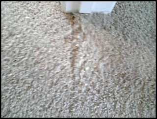

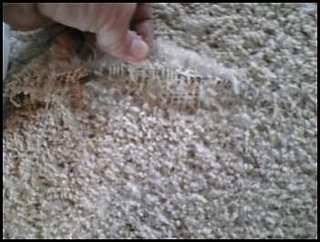

I read the other post about cat damage in the doorway. I don't have a stretcher yet, so I need advice on how to handle this. This is for a property manager that has always let me experiment with stuff. I am free to work with it and not have a customer looking over my shoulder.
Backing is still good. I want to try a graft. What do you guys think?

I think what you need to do is get a pattern stretcher or mini stretcher. Trim the edge clean with scissors. And zapp it with the kool glide. Is the floor a gypcrete floor . If so you should be able to use saty nails(Roofing or Gypcrete nails) Than do your seam. Kick it up and stay nail if you must. The easiest is the 1st suggestion.

yes, the subfloor is wood. I didn't think about using the nails to keep it in place. I think I will kick it up like you said and use the kool glide. I have it scheduled for next week and should have my kool glide by then :D .

First, I would agree with Harry, a Mini Stretcher would make this job very simple, very simple.
Since you do not have one you can trim it and put a small insert, somewhat of a saddle. Grafting would also work if you still have the secondary in place, which you did state was still good, this would be a viable repair since it is on the side of the seam and not in the middle.
A couple of these type repairs could be made but it goes back to the mini stretcher, with that tool, a glue gun and a kool glide you can pull the end together and make it look great in short order.
If I were to try to graft it, I would probably trim as much bad stuff away and then form a piece to fit but I would not take off the secondary, I would 'graft' it with the secondary still on the donor piece and lock it in place and then trim the top off. This way you keep a lot of the stability of the donor and still never break the backing open at the seam and let what is stable stay stable. This is a pretty good repair for this as well but you have to make some anchors through the backing for the donor piece to hold onto. This is done with a glue gun.
Just some thoughts but I will be excited to see how you handle it and how it comes out.

To add to what Steve and harry have said, IF you cut open the existing seam, put your stay nails in FIRST. Even 8' or more out from the seam to hold existing tension.

If the carpet is loose enough, would it be a good idea to use the mini stretcher to pull the carpet together, seam it with the kool glide and not have to put in a donor piece?

That is the correct repair to do with this. I work with a couple of large contractors from time to time and this is one of the repairs we work on, showing them how to repair door way seams. It is very rare that you would have to have a donor piece, in fact it will likely tighten up the rest of the area, this is partly why I like this repair so much. You almost never have to dis-engage the carpet from the walls to do this repair. So, yes, trim it and pull it together, you may not even have to open the whole seam but if you do trim it off straight and work it together and it will look great.
