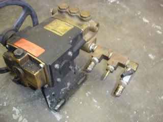

I like Mike's a little more, but this is the set up I had when I cleaned (before having access to Les's wisdom), in fact the pump still ran fine the day i removed it, if someone needs a pump cheap ready to go, just PM me.
As you can see, I had the starve set with a ball valve barely closed, and the regulator bypass came inclose to the pump head, and the dwyer fed in between....]foolproof, always worked.
I can think of another reason to Stay with a simple siphon, you don't have to worry about blowing diaphrams and bypassing your chem system just because you are running high pressure, 800 psi is brutal on diaphram pumps.

Nobody has any picture that might help with communication
9,756
noooooooooo...not at the pump inlet....!
Your killing me Bawb.... Where does the foot valve go? I have a piston style foot valve/check valve...
I was using Greenie's pump pic in the quoted post above for reference... I'm still trying to decipher Bawb's cryptic codes he speaks in.....
