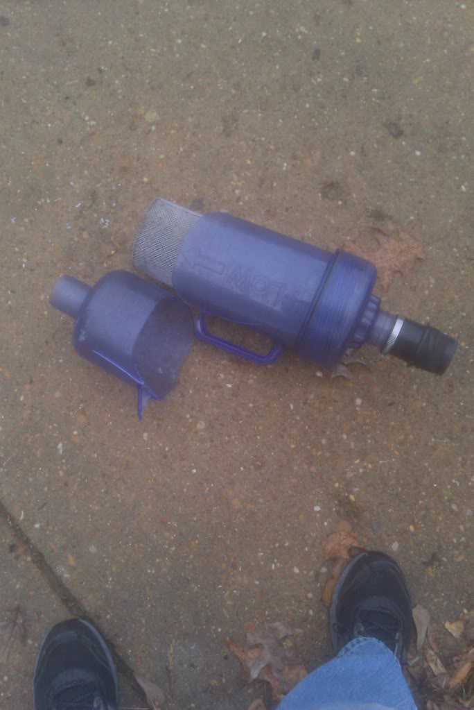

Well the screen mesh busted but the real issue is the lid.
It gets stuck and you can't get it off. Dirt and grit get caught in the grooves and make it impossible to twist the lid off.
I had two that I had to knock the handle on a post to get the lid off, but eventually the filter just cracked in half.
It's junk.
The older flip top is a good filter. Just keep the orings changed out and the filter will last a long time.

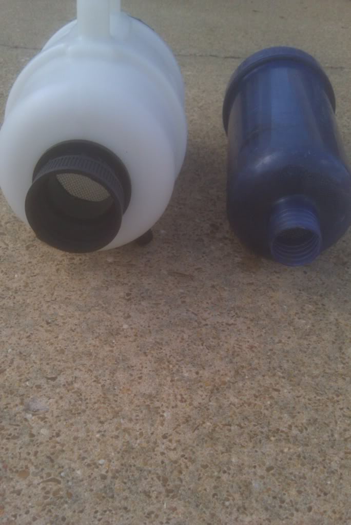

And the real reason you want the 2.5 inch inlet mytee filter is better airflow. Just look at the difference.
It's junk.
Thank you for the photos Dan. I thought they were supposed to me made of bullet proof plastic? I guess not. Great point made of the screw offs becoming filled with particulates. I'm going to return this HF 2 and will get a devastator made by Conway instead.

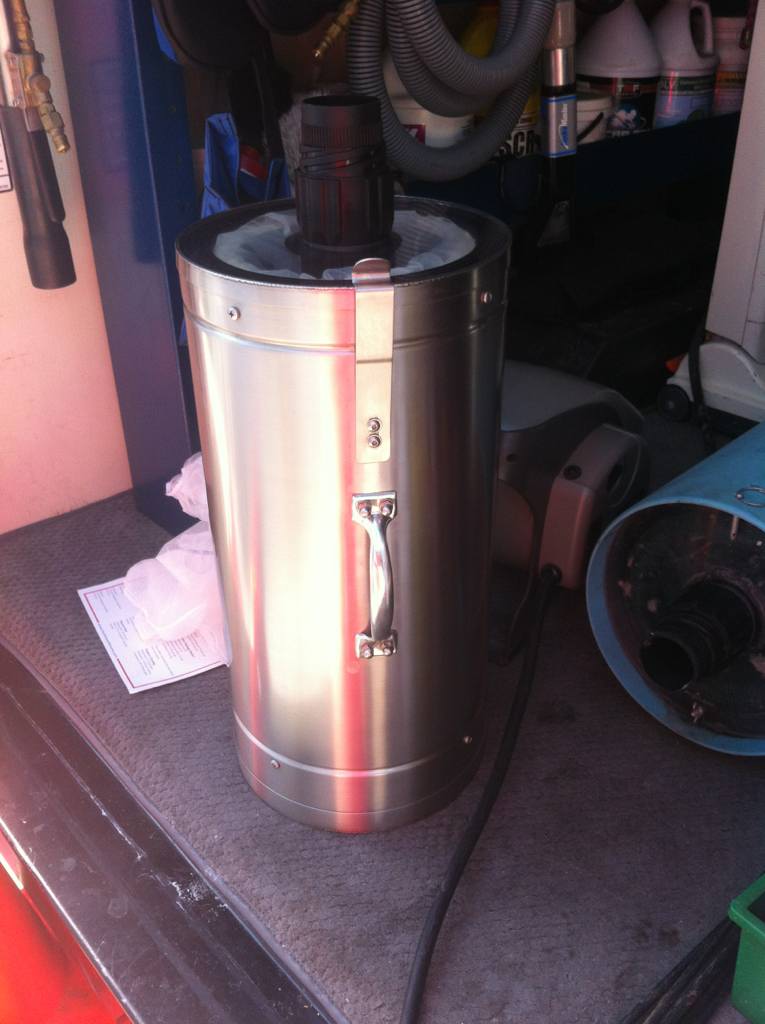

Have had several aqua filters, they last about a year or so, the stainless filter last longer than the housing. The weld on the stainless filter work loose after time but can been repaired with JB weld. Purchace a lint Hog from John @ superior along with 5 set of lynxs cuffs. Had some issues with the cuffs but was able to send them back. So far I am happy with the lint hog LIKE!
