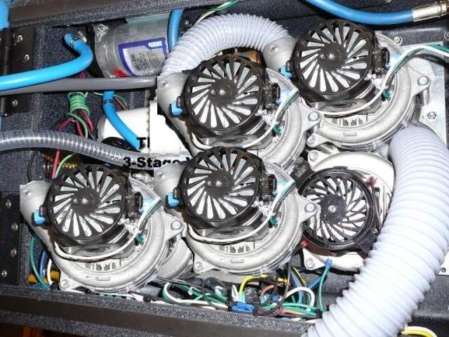

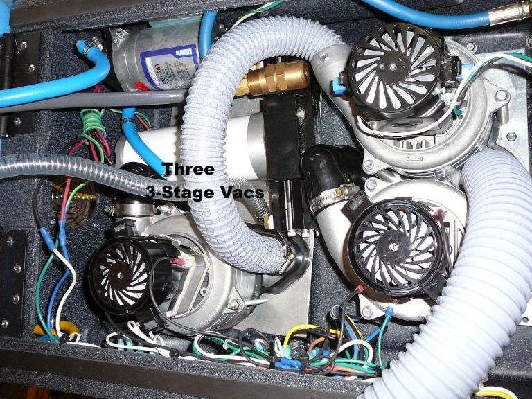

We have a brand new contender for most powerful portable.
New Vac motors have made this machine possible.
It has three 3-stage hi-efficiency vac motors ...
and a 500 PSI Pump system:
Pump-out also installed.
Runs on just two electric cords.
Larry

What is the amp draw of the new motors Larry, and what is the amp draw per each cord? What length of hose runs have you tested it with? What is the cost of those motors from you?

Umm, is it just me, or is the APO plumbed to fill the inside of the machine with water when it runs? I assume that hose normally goes somewhere else?

JHC.....Larry.....Where do I start with that abomination?
I had hope you were gonna Give the boys here a good show with something new and different.....Just shoot me.
Now I'm back to just buy an M5 and be done with it.

Putting a third vac in SERIES behind 1 of the 2 avail. parallel vacs (that SHARE the SAME vacuum manifold) is just imbalanced redneck nightmare design.
It's stuff like this that misleads the newbies.
Why would you want incresed Waterlift on 1/2 of your vacuum system?
It doesn't even need the third vac, the 2 high efficiency vacs making 230 cfm @ 146" waterlift is plenty.
All that at a sacrifice of the paltry undersized DC motor pump?
Put the M5 AC pump motor back on....please.
And Panel mount the pressure regulator, and add some better COOLING to the Chassis, cause you are gonna need it, thos vacs put off some heat. Where is the Pressure Gauge?
The auto pump out needs Larger diameter hose as well.

Oh man, I pity the poor dude that has to get in there to repair or replace anything. That looks like 10 pounds of shit in a 5 pound bag.
What about heat? I would imagine that compartment gets hot enough to cook an egg, or should I say cook a motor prematurely. I would have to think one would get better suck putting two 3 stagers in there, and running a 3 stage inline booster closer to the wand, plus the unit would be way easier to service if needed. That pump looks shoehorned in there, and it's only 500 psi, with a dc motor! And is that a pressure adjuster there? If so, that has to be quite the PITA popping that thing open when you want to adjust the pressure. No thanks, I'll keep my 1500 psi, 3.2 GPM external any day.
And that third motor, the one in series, maybe it's just my eyes, but why / how is the hose connected to the inside of the exhaust?? Plus with that bend in it, that just has to be killing the bulk of what suck it should provide.
117,269
Larry aren't those fans suppose to be sucking in cool air from out side the compartment?
Did you or ken Harris design that?

The primary cord is drawing 19 amps. It requires a 20 amp circuit.
The second cord is drawing 14 amps. It requires a 15 amp circuit.
There is a fan cooling the equipment and a vent at the opposite end.
The pump system has about 1.4 GPM of water flow.
It is not quite as crowded as the picture portrays it.
The pump-out hose was not connected when the photo was taken.
Larry

There are some SERIOUS tight bends in that vac plumbing.
Question for those who build portys:
WHY are vac motors always mounted to the floor of the unit? Why can't they be mounted to the inner walls as well to more efficiently use space and relieve overcrowding/overheating/tight bends? I'm sure there must be a good reason....what is it?

First RED flag I see with this design is....if you were using the current GS brand motors that make 115 cfm each, that would be 345 cfm on a SINGLE 2" wire flex hose, with at least one barb in the mix, so that is really closer to 1 3/4" bottleneck.
Second flag is how are you going to Couple all three vacs to the single hose/pipe?
If Kenny were really a genius he'd had figured out how to have three "stacks" in the tank, all I could manage was two big ones.
I'm also wondering why all that heat couldn't be put to use heating the water? Something like the perfect heat system powerflite uses? Or would that be breaking patent laws?
You probably could.
It doesn't change the fact the cabinet is still gonna be 130 degrees and quickly aging every wire and plastic in it not to mention reducing the life span of said components....The name of the game is Keep them Cool, not heat them up and try to "capture" that heat....the heat is still there.

Vac motors can be mounted any way you want but a vac motor company told me years ago that the ball bearings were designed to be mounted upright. In addition when they are mounted the way Mytee does it (upright) they are able to be easily replaced from stock off the shelf product which is far more economical than gluing on a nozzle. We used to do that (epoxy the nozzles on) in the '70s and than just tooled up for the manifold. The weight difference is inconsequential. The advantage is priceless.
I agree with the guy who said a booster would be more beneficial closer to the wand than the 3rd vac motor, though it is an interesting thread and the Breeze body is a very good choice for it's low weight and strength.

"Perfect Heat" isn't really perfect. It's very difficult to heat water with hot air and those vac motors don't produce enough to heat water. Mytee makes a little air manifold to cool the motors with outside air. If Larry wants to try them I could send him a couple.
The reason the hose is going inside the vac motor is to lower the airflow and thus the amp draw, I think. Correct me if I'm wrong. (it won't be the first time)
