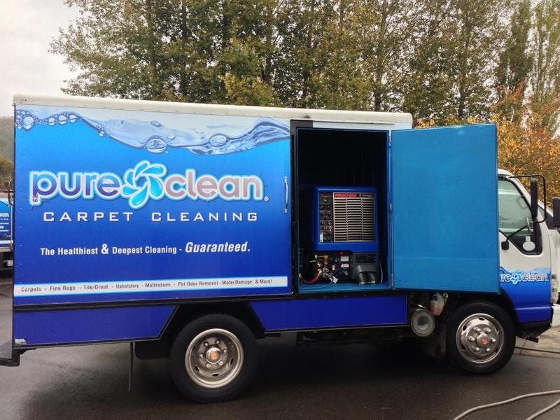

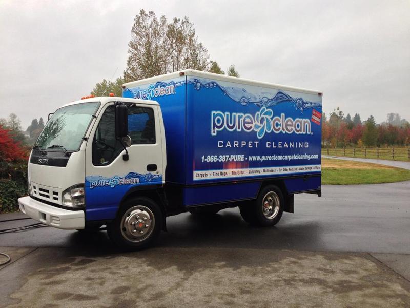

Couldn't find a AT so we built something as close to it as we could! 230 gallon fresh water - good to go!

Yeah it is a little shorter than what I would have liked but It works out pretty well. The wrap was $3800
A planet far far away
It looks great though, very clean look! I like it a lot!
$3,800 is a bite in the shorts BUT spread over the life of the wrap and given the marketing impact, not too bad a deal.

Yeah I was a little pissed because the guy that does them usually did them for us for $1900. Than he jacked his prices up. But in this market 3800 is still a good price for a box truck.

I like the fish tank look to the wrap.

Like Muffy, I want to see the inside.

Hey Ben,
Good looking truck and wrap. HOw you liking the 650 HP so far? Did you go with similiar fresh tank from the info I sent to you? I like how compact it all looks. Do you have to run hose out the back door? That's my only complaint with the way we set ours up.

I was wondering what you have on the door? The two different sizes in the bullet points from the driver to passenger side, is bugging my OCD. The drivers side is easier to read than the other.

just used the everest all day today and love it! havent finished inside yet so itsnothing impressive but i am going to throw some saphire reels on board i think.

I really like the wrap. It makes me think it is full of water and the truck will tip over on a tight corner.

It's an impressive truck.
What kind of work are you doing that demands the huge machine and oversize tank?

We're doing mostly residential carpet /tile cleaning. I've owned many machines including
* Prochem Legend
* Prochem Performer
* Prochem Apex
* AeroTech
* Hydramaster Titan 875
* Prochem Everest 650HP
* ThermalWave
Cleaning with the Apex or Legend compared to any of these other machines is uncomparable in heat, suction and overall satisfaction in my opinion. I'm sure good results/dry times can be achieved with other machines but once you experience a powerhouse machine you just can never go back. Plus you get the added benefit of dual wanding when needed, the BIG TRUCK marketing and just confidence behind the wand for your technicians.

The Hydramaster 875 is a machine that was designed with flaws. The first machine we had installed was a lemon pretty much. Bad blower right out of the gate, amongst other problems. My biggest issue was how much water it went through at a single job.... So- we had Hydramaster install a second brand new 875, only to be let down by the water by-pass issue. I had the Titan pulled and the Everest 650HP put in. MUCH BETTER. Awesome HEAT , suction and NO WATER BYPASS issue. We're very happy - just wish we would have gone with the Everest to begin with.
We also just bought the ThermalWave with 1,200 hours on it. So far it feels pretty good as well. Radiator was bad right out of the gate and it was making some "clanking" noises but Joe at JonDon is taking care of it for us.
