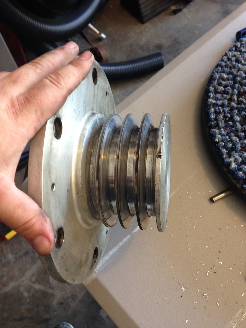

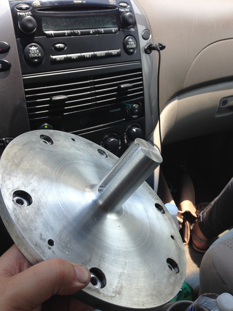

If you own a Nissan genny, you know the aluminum sheave becomes worn and burns through belts,
I took mine to a machinest and had them lathe it down to a 1.5" keyed shaft. Now I can put any sheave I want on there.
http://i1294.photobucket.com/albums...7-B234-4CBA-92F5-2059FE6EAE38_zpswpfrw7fx.jpg
http://i1294.photobucket.com/albums...A-A1A2-44E0-9F54-9CA605D4FE3A_zpspyopsnnf.jpg

I have a little machine shop at home with lathe and vertical mill. I love that stuff. Your machinist turned a nice radius where the "shaft" meets the hub instead of tuning a hard inside corner - great for reducing the chance of forming stress risers and cracks. He knows what he's doing.

It looks awesome, just keep belt tension down, don't overdo it as it really may just snap that sucker right off. That 59 is going to put a big load on the aluminum. It worked awesome before, but that was a massive piece of alum. that was machined down with belt grooves in it. I don't want to be a party pooper but this might not work.
The pulley set up has given me the most problems on my project, blowers are powerful, I just snapped a 7/8 steel shaft being stupid again.
Tom I hear ya, as this was 3 B belts before, It will now be 3 5vx belts, which need very little tension. And I will have MUCH larger pulleys.
If this doesn't work Ill have the broken shaft machined smooth, and bolt a sheave to the then flat aluminum plate...
Which has me thinking... once the sheave is on the shaft, I could use the bolt holes in the sheave as pilots to drill through and tap the aluminum and have longer bolts go all the way through to the aluminum plate, greatly decreasing the strain on the shaft itself.

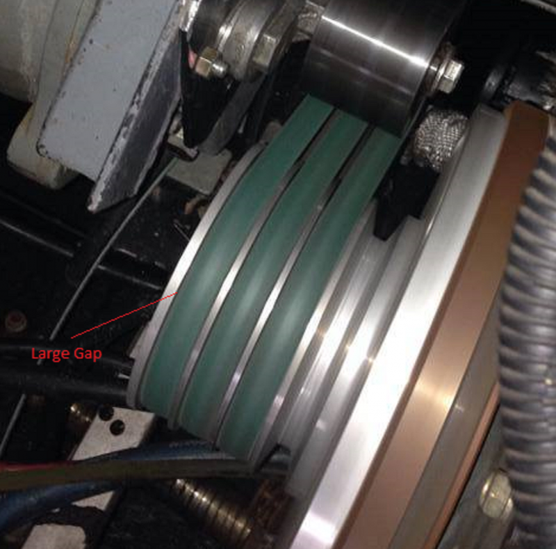

Seems odd that only guys that put tons of hours on those Powerclean pulleys have any problems with them wearing out. How many hours on yours so far Ashley? Didn't you start at like 1100? I have about 11000.
I honestly don't know for sure, But I think the previous owner never tightened the belts properly the entire time he owned it, and just burned through belts every few weeks.

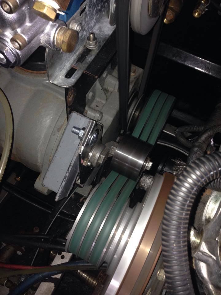

I cooked up a "Push down idler" that helped the belts last a lot longer, but they would still slip... And the pulley got more and more worn.
If you look at the zoomed photo, you will see just how worn the pulley was, one side of the belts weren't even touching the pulley.
A large feeler gauge could slide between the pulley and the belt.

Gates green belts and most BX belts are stated to be rated for back side idlers.
