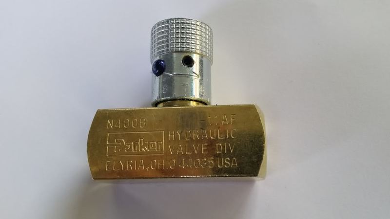

one more time, locking needle valve for uph tools and REs
117,249
any Parker store or distributor can get you some

Jim Martin
10,877
Jim Martin
You can order the part threw Windtrax......part number....N400B for the 1/4....
the last time I ordered one it was.$26.81.....
Same one I put on my Hoss about just over a year ago and it is still working great....also made one of these for each truck....
they come in handy .............
they regulate flow...........

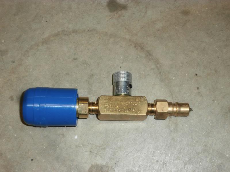

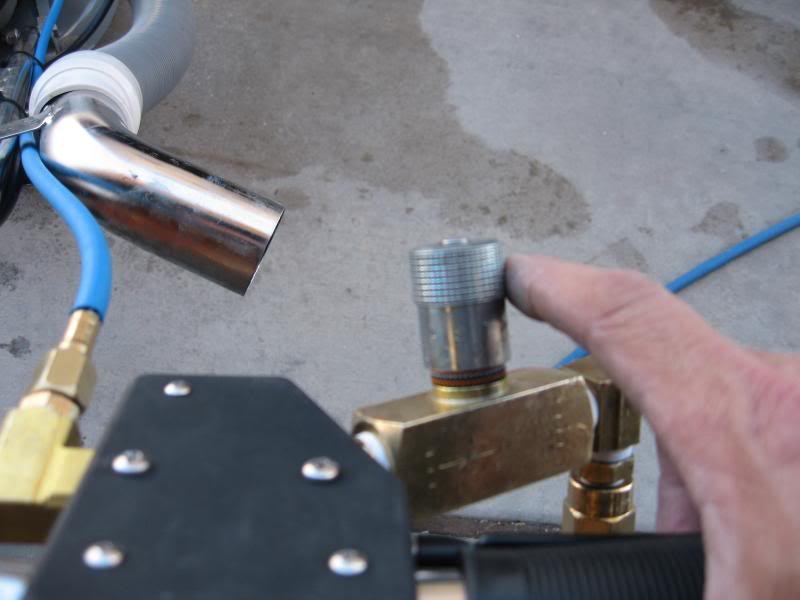

On the upholstery tool do you remove the factory valve?
it would make since to........if the old one is giving them problems..don't think leaving it on and putting the new one before or after it is going to solve the problem.....????

Michael
So do you have one these Parker's on your upholstery tool?
I am looking for set up and pictures here

No I do not...mine has not given me a bit of problems so I have no reason to change it....
should be pretty straight forward....
