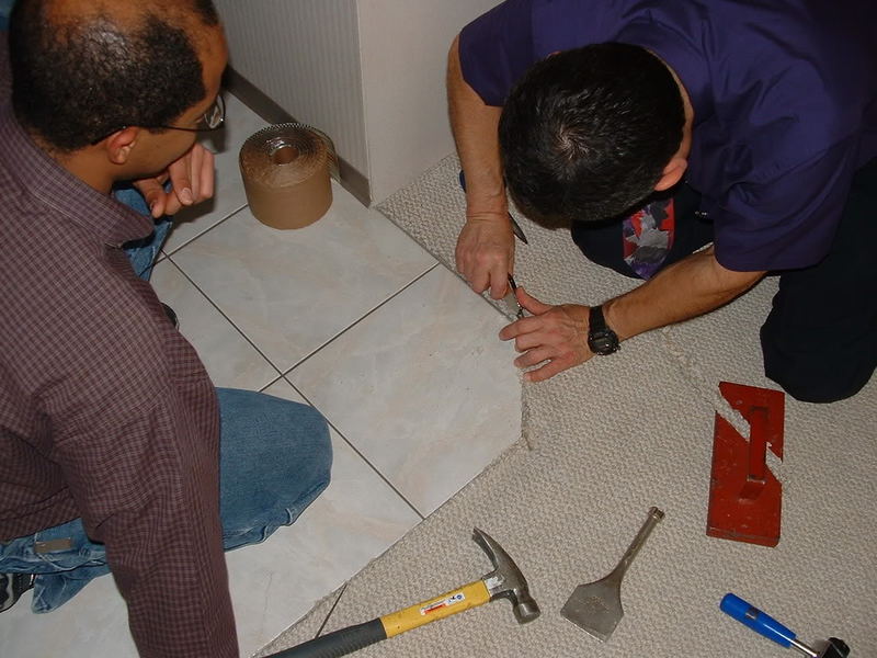

Just held a private 3 Day RRT Class in NY and then spent an additional day to work with some of the students. Occasionally in a class we will have real 'Live' work to do and it is usually a very good experience.

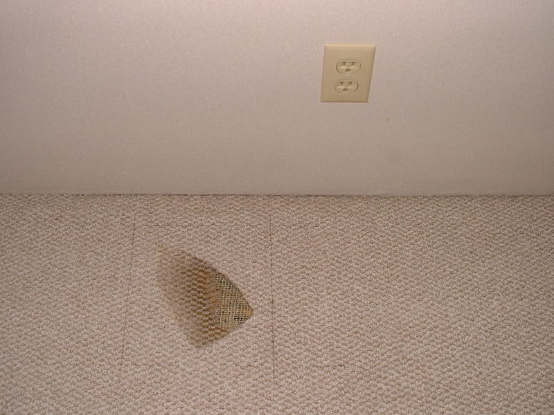

Here is one room that had two 'Iron Burns' one moderate and one 'severe'. There was also damage along an edge that was repaired.
I enjoyed this event and thought I would share it to let some know what type of things are learned in a RRT Class.

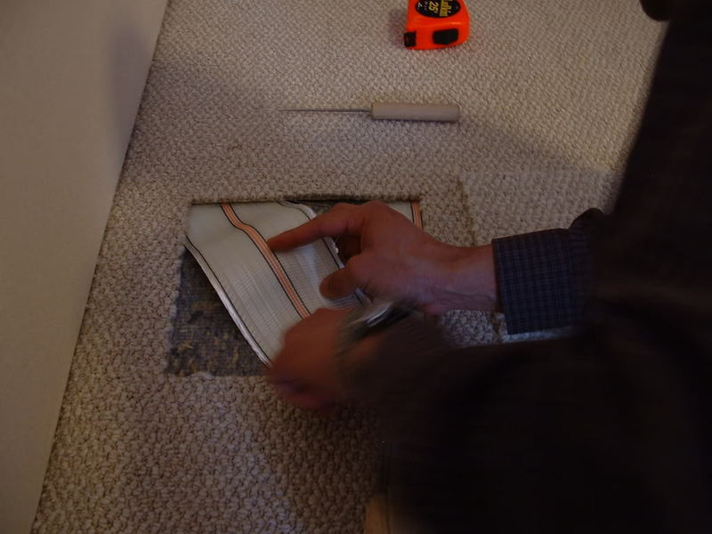

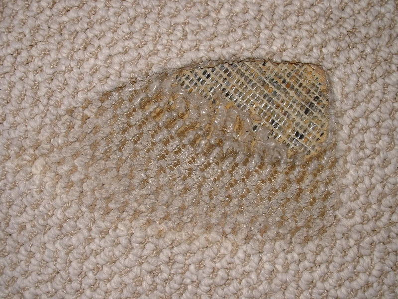

severe iron burn, so deep even the pad was burned
Here was another burn but much less damage

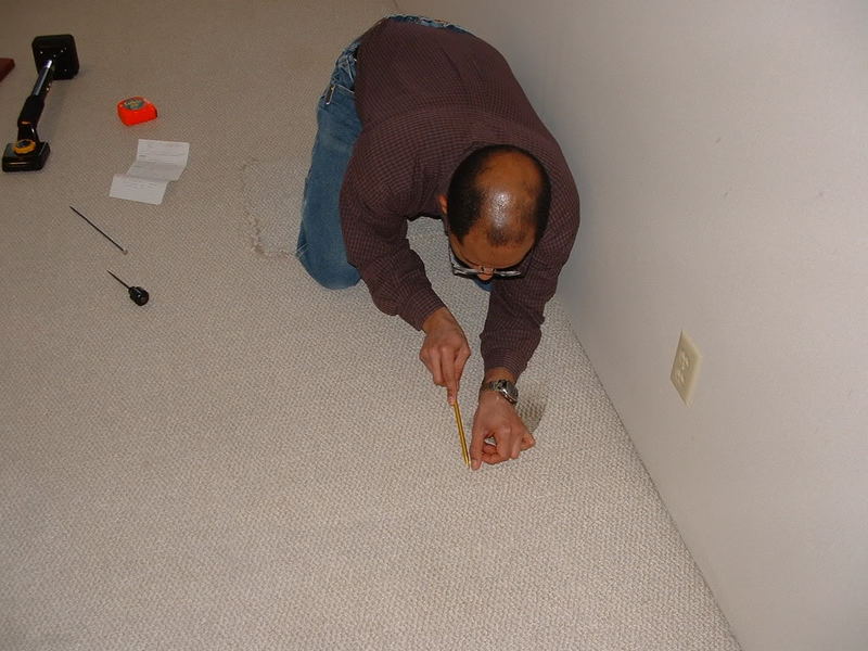

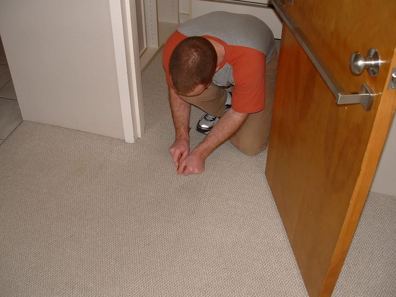

Here one student is working on one burn mark
another student working on another burn mark
And another student working on one of ther burn marks with another

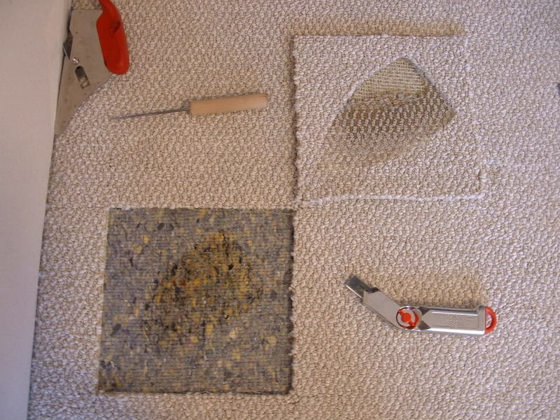

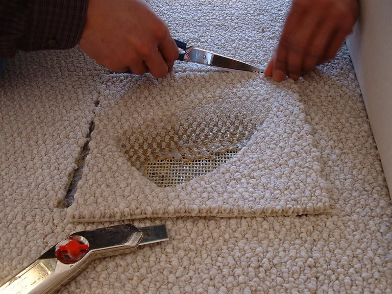

removing one of the burns

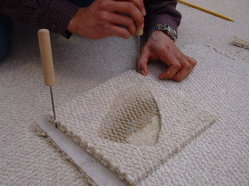

setting up the repair

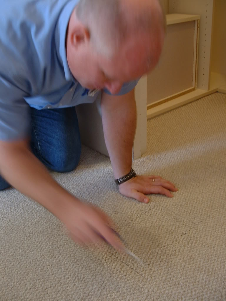

cutting out the donor piece

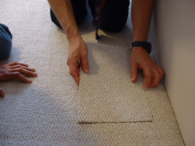

being sure it fits

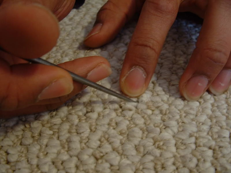

detailing the donor piece for a precision fit

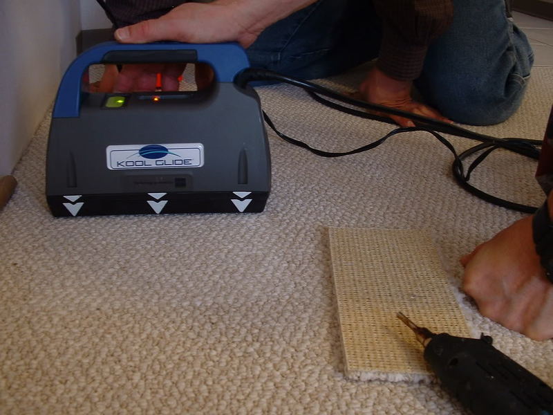

using kool glide after sealing and securing all edges with a glue gun

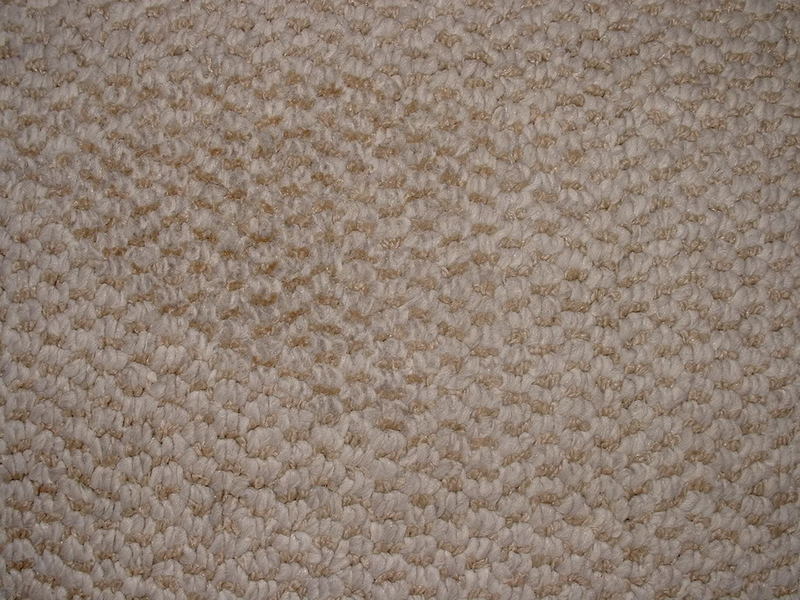

Final details

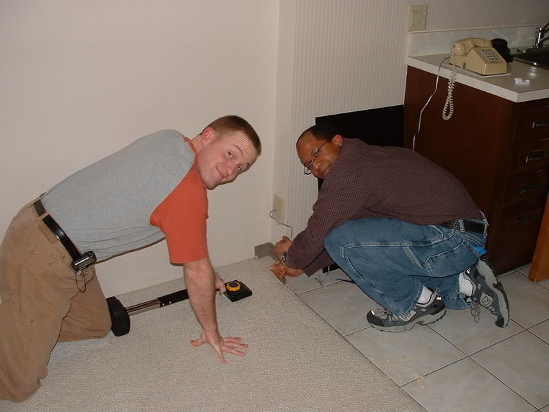

Repairing edge damage
Finishing up putting everything together and a nice smile for the camera
