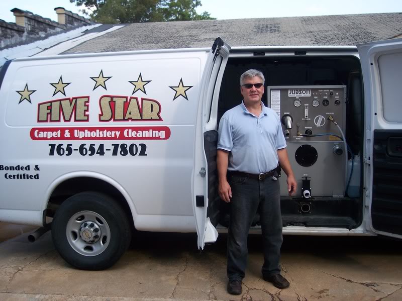

Jeff Woods from Indiana took a road trip to Judson to upgrade to a higher performance machine. Jeff was fairly happy with the heat of his Thermal Wave until he went to high flow. The Thermal Wave would not sustain temperature with a high flow system. His new TNT will sustain 240 degrees high flow.
One of the issues that Jeff was having with his Thermal Wave was extreme difficulty repairing the unit. The TNT will have about a 50% operating cost savings. Before Jeff left, he asked, “Where is the manual for the unit?” I replied, “The manual is on the front of the unit.” It is the white sticker going down the left side. That is how simple aTNT really is.

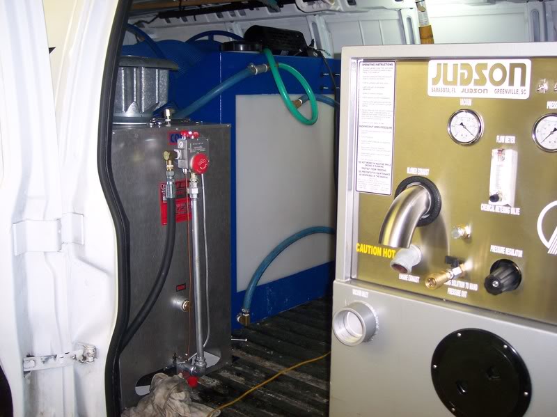

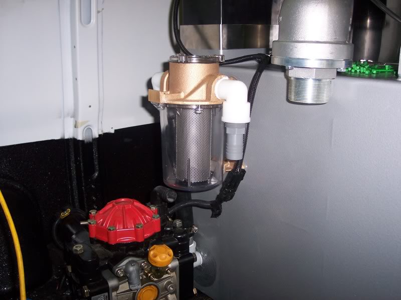

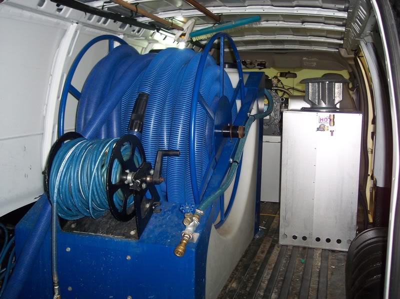

We also removed the pump out system off the Thermal Wave and mounted it on the TNT, but we added a real nice inline filter system to it. We left the Blue Line water pond and reel system, and when we were finished, Jeff had considerably more room in his van.

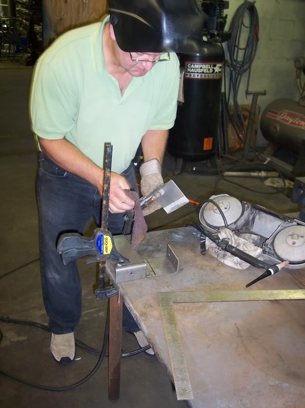

Jeff’s life story is very interesting. He is a retired X-Ray welder from working on offshore oil rigs. Jeff taught us how to weld stainless. He knew a lot of tricks that we knew nothing about

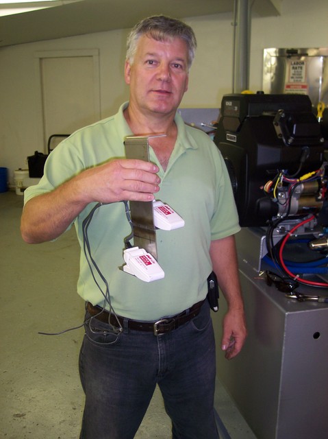

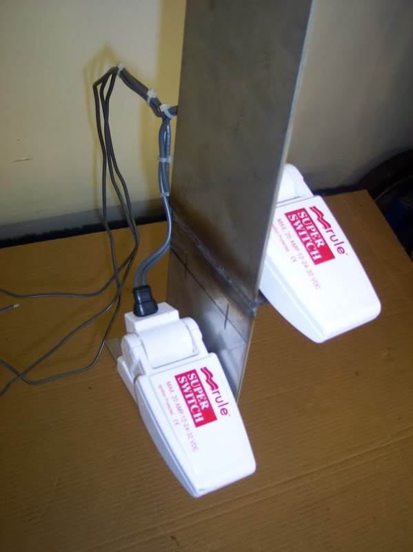

Jeff has very good engineering capabilities. He helped us design this switch system for the recovery tank. The bottom switch is to activate his pump-out system. We eliminated the $180 Blue Line switch with a common high amp boat bilge pump switch. These are very common and can be found locally. The top switch shuts the machine off when the recovery tank is full

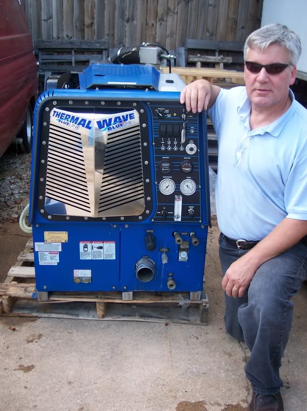

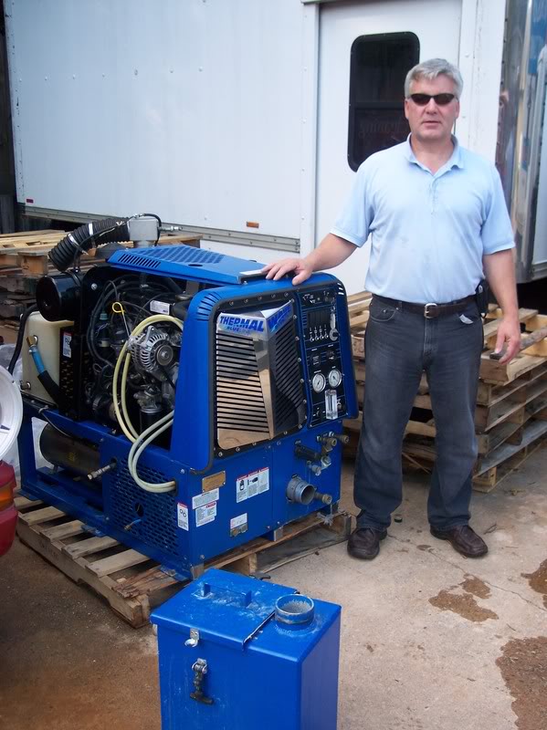

The Thermal Wave that we removed has 2000 hours on it. There are several issues with the unit. One is that it will run for only five seconds and then shut off. The second issue is that the electrical thermostat is not preventing the unit from getting too hot when the trigger is released. Jeff was driving quite a few hours to get the unit repaired. That is one of the reasons he decided to get a TNT. 90% of the issues can be repaired over the phone by the operator. This Thermal Wave is available for sale. If anyone is familiar with Thermal Waves and knows how to keep them running, this might be a good opportunity to purchase this unit at a good price. One option for this unit is that Judson can reengineer it for you. When we reengineer a unit we do a total strip of all electrical controls, remove all heat exchangers, all exhaust diverters, solenoid switches, and relays. We remove about ½ mile of wiring, install mechanical throttle control, and upgrade the heat to sustain 240 on a high flow system with the use of a #4 Little Giant heater.

What's that big assed blue thing taking up all the room in the van?

Ken, One of the unique features of the TNT design is the location of the engine. Air cooled engines have a high CFM cooling fan. The TNT engine is mounted with the cooling intake located between the van seats. The air blows around the engine towards the back of the van , picks up the hot exaust air from the Little Giant heater and continues out through the rear doors. You can sit in the seats with the machine running and not feel heat. A roof vent would probably help but is not necessay as we have not had any heat issues.

Blue line water pond DA....hose reel and fresh tank one piece.

How many gallon is that water pond?
How many ft of 2.5" could you fit on that reel?
D
Doug D
the water pond holds 120 gallons of water. Not sure on the 2 1/2 inch hose though.

I know how to keep a Blueline Thermal Wave 5m running. I prefere electronic throttle controls! Its the #1 reason I purchased Blueline in the first place. It would be tuff for me to purchase another TM without it.
The Thermalwave 5m is POS! Nobody should ever buy one! They have a mile of wiring and a cluster fook of electronics. Also, they are difficult to work on.
So Les, how little are you willing to accept for the 5m? Name the price.
I'll probably be making another TM purchase next week.

If someone understands the electrical side of a thermalwave and can troubleshoot it would be a great machine for the price Im asking. The machine was well maintained.has only 2200 hours on it. It has all new belts and all fluids changed. I just needed a machine that I could fix myself with local parts and little down time that had power and heat.Judson fit the bill.
