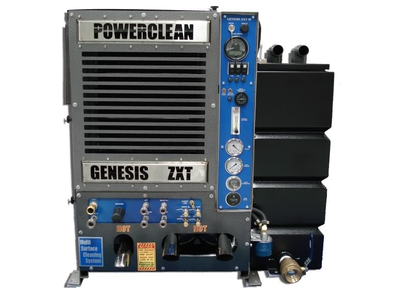

This is the new 68 horsepower PowerClean Genesis.
C
carpet cleaner

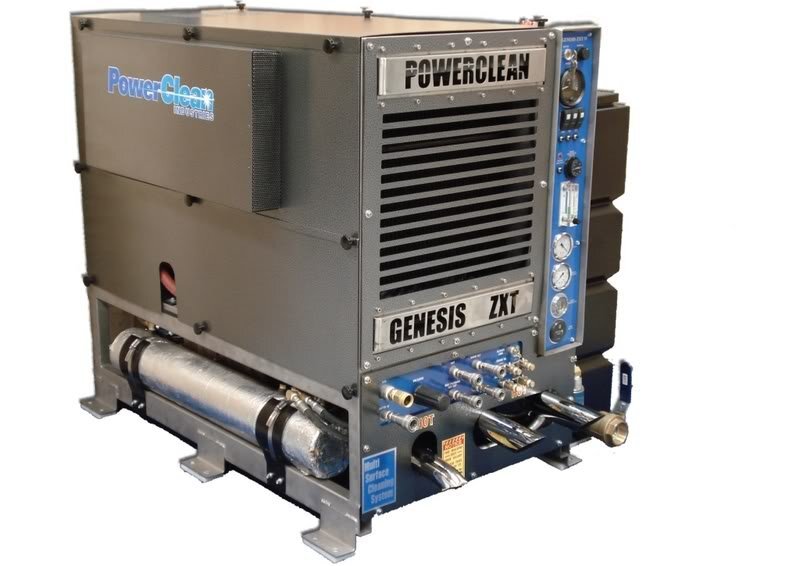

are those hose clamps on the hose going to the oil filter?
117,285
I miss the Ford or Nissan logo.
Still looks nice though.
I hope we can get one out here for MF4
T
The Cleaning Artist
Im in the process of gathering parts to build a 87hp, 59 blower, 4 to 5 HX machine now. Thats how I ran across those pics.
3000 rpms should deliver 900 cfm and @ 20" of lift should run 3 wands or tile cleaners at the same time and deliver 230+ heat in 3 wand. 280+ for 1 or 2 wand. 150 to 200 gallon Artist spec'd tank. Simple ond very powerful. Going to be fun. OH And no it will not be SOA approved as it would pull the carpets off the test machine. LOL

When are they going to put a half decent tank to match the performance of the unit? Also, look at those pidly little 2" ports there.... 'bout time they went to 2.5" isn't it?
John
Awesome machine. I have the Nissan one about 2.5 years old and love it.
I do think though that if anything lets the machine as a whole down it's the tank. A tank redesign with better flow and larger ports and possibly a better filter system would allow that 59 to BREATHE freer.
Not that I'm using it to the max anyway but they are my thoughts.
I think you'll find the ratings for that blower are max of 15" lift. Don't know if there are other options with higher ratings though.
John
G
Greenie
Well...Finally a powerplant matched to the 59 blower, now to catch up on the tank, I totally agree with the kiwi. While your fixin' the tank, fix the blower plumbing too.

Will someone please take the covers off and lets all have a look inside.
Thanks, Greg
J
Jim Bethel
Since I took the photo's shown above originally, I will also post some internals shortly then as well - possibly over the weekend when I get 5 seconds.
Jim
FastEddie
What's the logic behind the covers? I took mine off from day one. Heat build up seems much higher to cook all the components.
