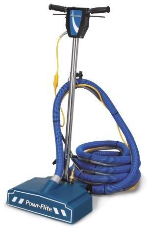

If that is what you want ...Just get one of these.. :!:
Hi Harper,
Is that one of those Powerhead or powerbrushes talked about earlier this week?
Thanks, Bill

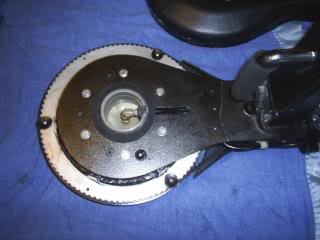

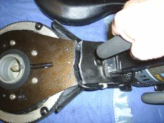

I have one ..that I will trade you for your "ON-DEMAND" tank off that everest...
"IF you know a GOOD WELDER.." :shock:
Les says it can be repaired... 8)
It is the old 2 piece model... :lol:
