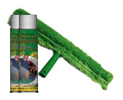

Phooey on Scratch-b-gone and stainless steel.
I got Poo-B-NoMo for Pool tables.
The big bucks are in Pool tables, Mr CornHusker. I will teach you all you need to know for $47.95, and give you all the supplies, enough to make $40,000 in Nebraska alone.
Here's your link:
http://www.quick-clean.com/
YesireeBawb, that's $47.95 for 2 Cans of Quick-Clean Cloth Cleaner & 1 Micro-Fiber wiper.
