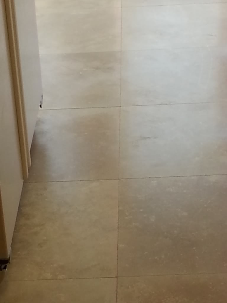

What started off as a honed/flat floor over time became fairly shine due to mop products, foot oils and the like. When Brunhilda the maid mopped half of it with vinegar one day she caused a panic attack in the owner who after calls to other tile cleaners in the area, landed in my lap as the go to hero.. We don't have any stone fags in the zip code..

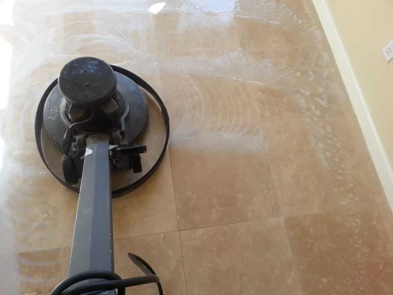

Started off with Magic Wand's Oxy Blaster and a 400 Monkey pad...
Got it nice and flat, removing all etch marks and inconsistencies..

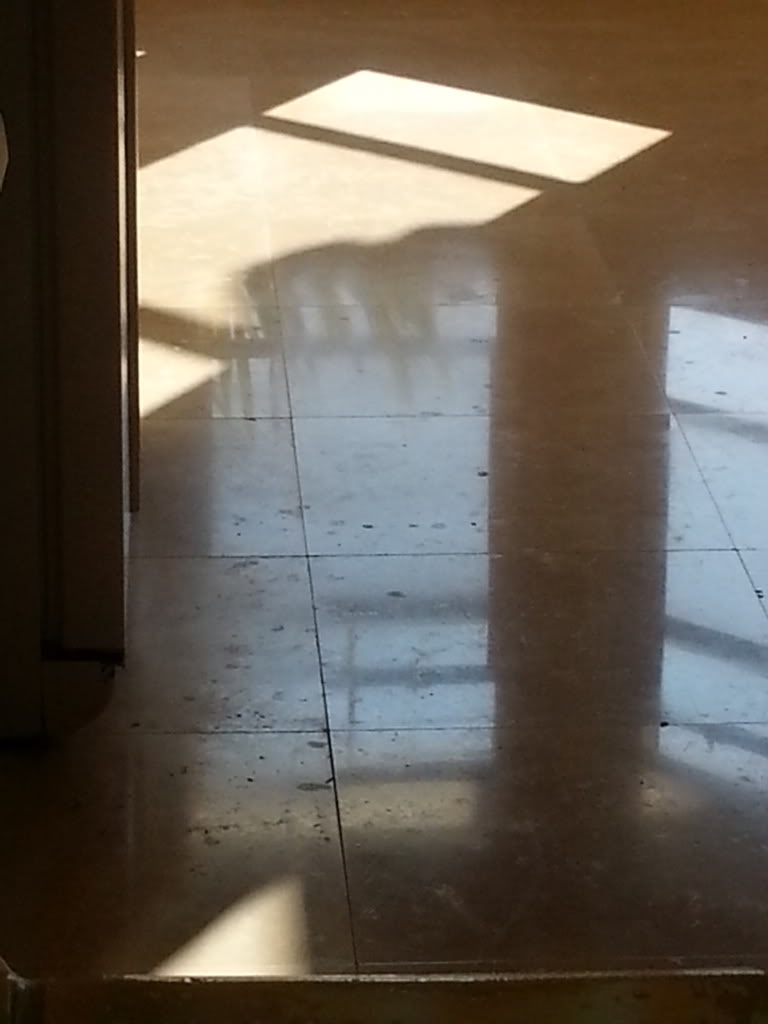

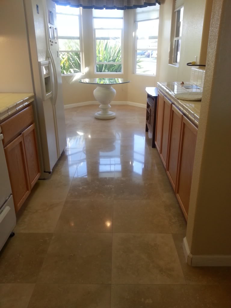

Than spent about a minute and a half per tile with Cobb's powder polish to attain this...

I bet I didn't use but three ounces on those 200 feet..
Interesting how much easier the Cobb milk was to remove compared to the monkey milk

I think it looks really good, especially since it was only powder polished. Most guys without much experience end up polishing too much or orange peeling it. This turned out nicely.
Now if the client was willing to pay for diamond refinishing first, the surface would be more abrasion resistant. It won't necessarily be less prone to moderate/heavy scratches, but foot traffic, mopping etc. wouldn't take as much toll on it. The trade off is powder polishing only won't last as long, but is less expensive.
I also never seal polished Travertine unless the client persists. It isn't nearly as porous and many people will lead you to believe. If polished travertine stains from a spill, it's likely it will come out with a decent stone cleaner.
