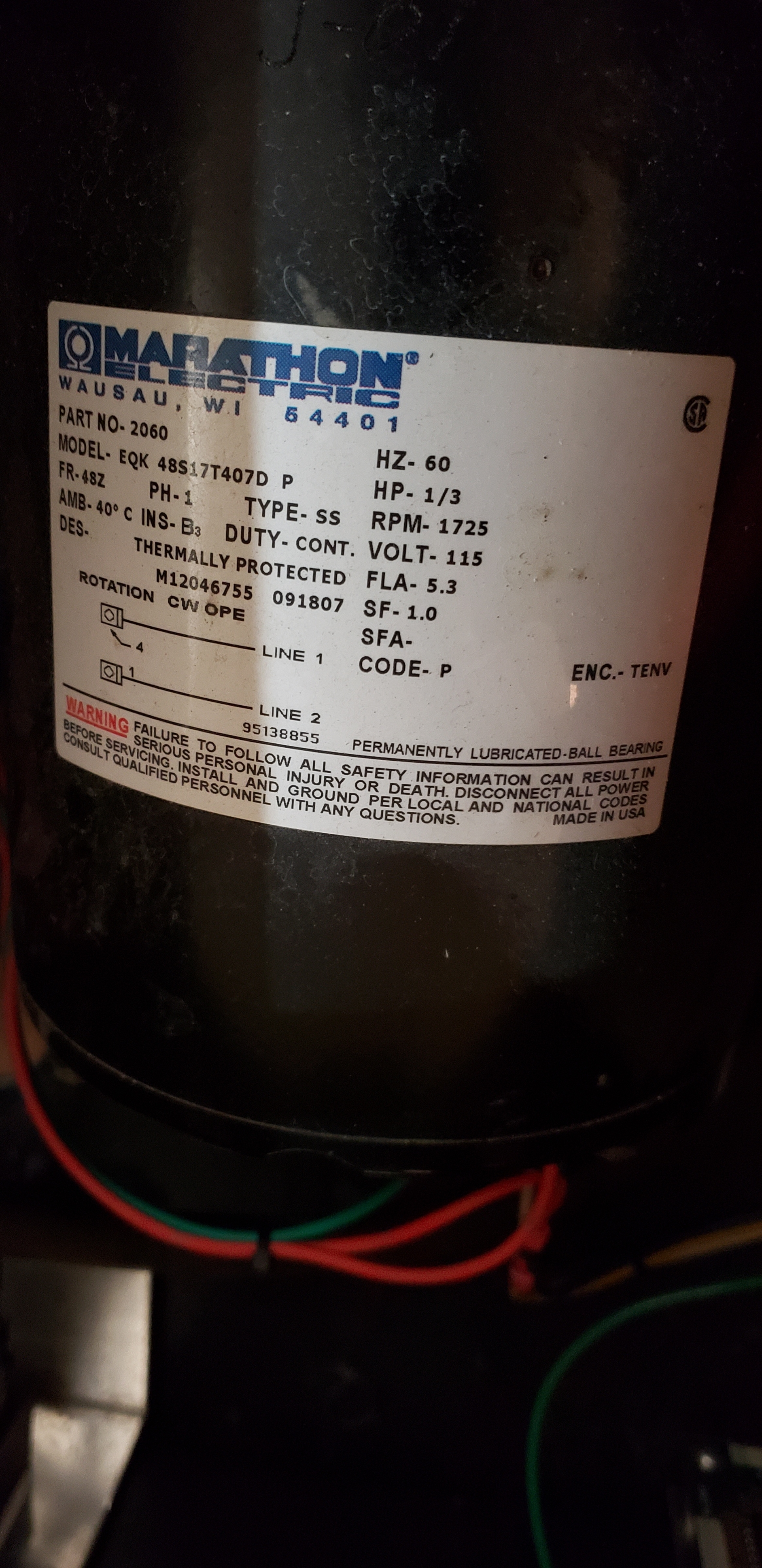

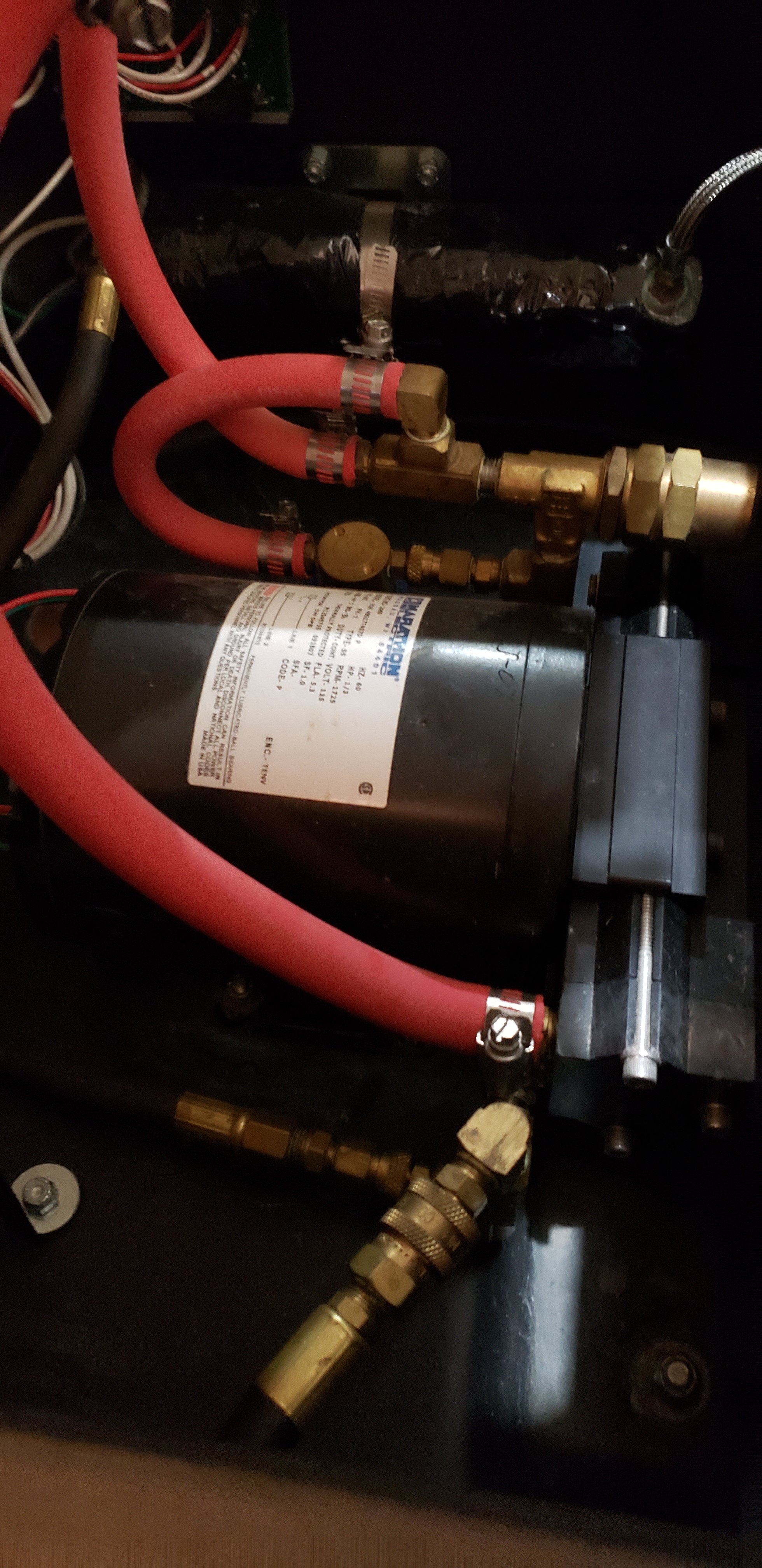

My US Products Solus 310's pump is getting bad and seems to be loosing pressure. Should I rebuild it, replace it with then original or try and find some aftermarket pump? Any links to suggested pumps appreciated.
