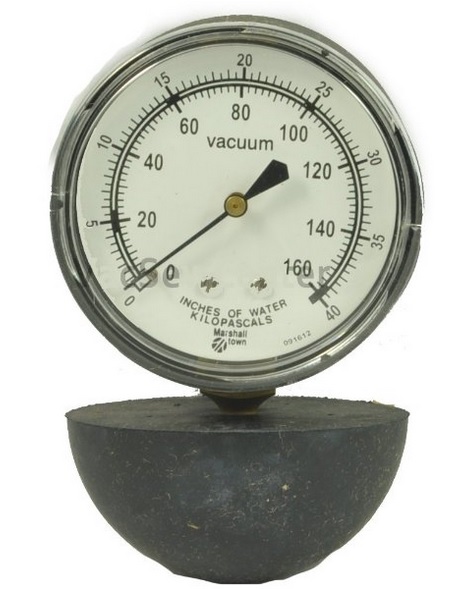

So Mike should put that gauge at the end of 50 of hose is what you're saying?
Maybe it was, hard to tell from that video

he should put it at the end of a 100 feet of hose
hence why I marked the gauge so it could be seen.
he is using two rather average vac motors 7.2 5.7 6.6 or 8.4 are going to give you better vacuum performance

the measurements at the machine mean nothing
Agreed, but...
Assuming no leaks, sealed vac readings will be the same no matter how long the hose is.... The readings will only be different if there is air entering somewhere along the line. The longer the hose, the longer it will take the reading to stabilize (so-called rise time).
Yes - readings at the end of the hose are what's important - but not sealed vac. How much lift is generated with the wand hooked up and on the carpet - that's what is important. I can build a vac system that will generate 28" hg of sealed lift (380" WC) and do it on one cord, but when you hook it up to a wand it will not extract one drop of solution from the carpet.

It shows inches of lift probably 150 with one vac and goes to 220 inches of lift with second vac
Dwell Pro Mike sent me this via his crappy phone.
I'll assume that when he hits the 2nd vac and the gauge tops out that that is a good thing..
Unless that a gauge for coke snorters... :eekk:
Ametek's data sheet for the 116765 lists a sealed vac of 136" wc, so two in series (using the 60% rule):
136 X 1.6 = 217.6
Yup, Sams number for the two vacs in series matches just about exactly with the predicted value. Ain't science wonderful! :biggrin:
